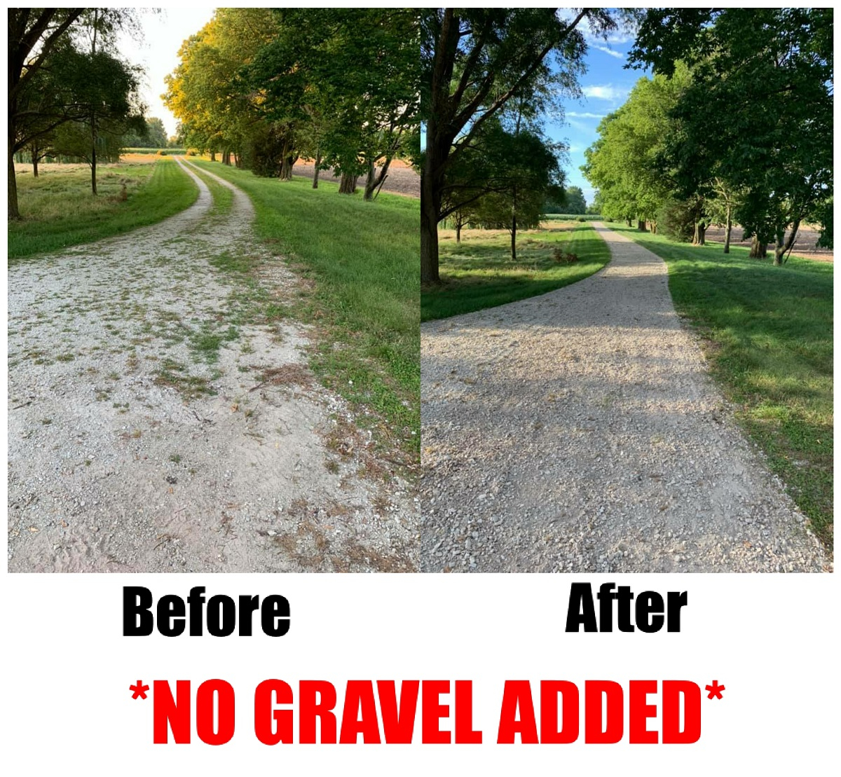

Land Plane Grading Scraper( LPGS ). Easy to use - little to no required learning curve - but it really won't crown nor do the driveway ditches nor plow snow.

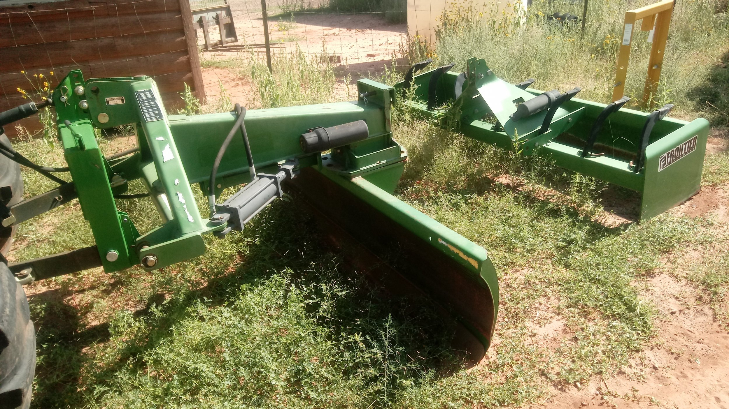

Rear blade. Easy to operate - but it DOES have a significant learning curve to get good results. Can be used for many other projects - including snow and driveway ditches.

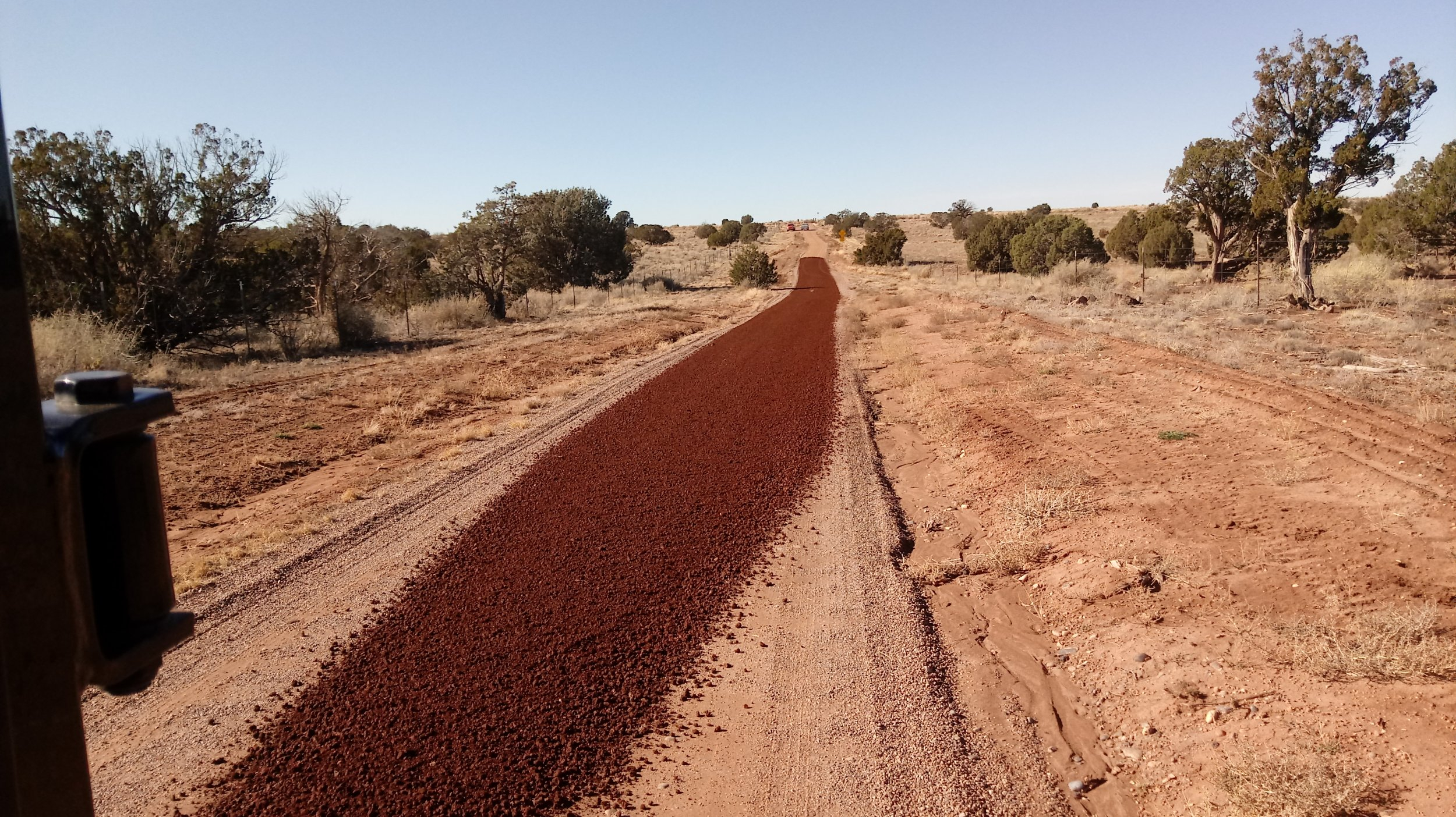

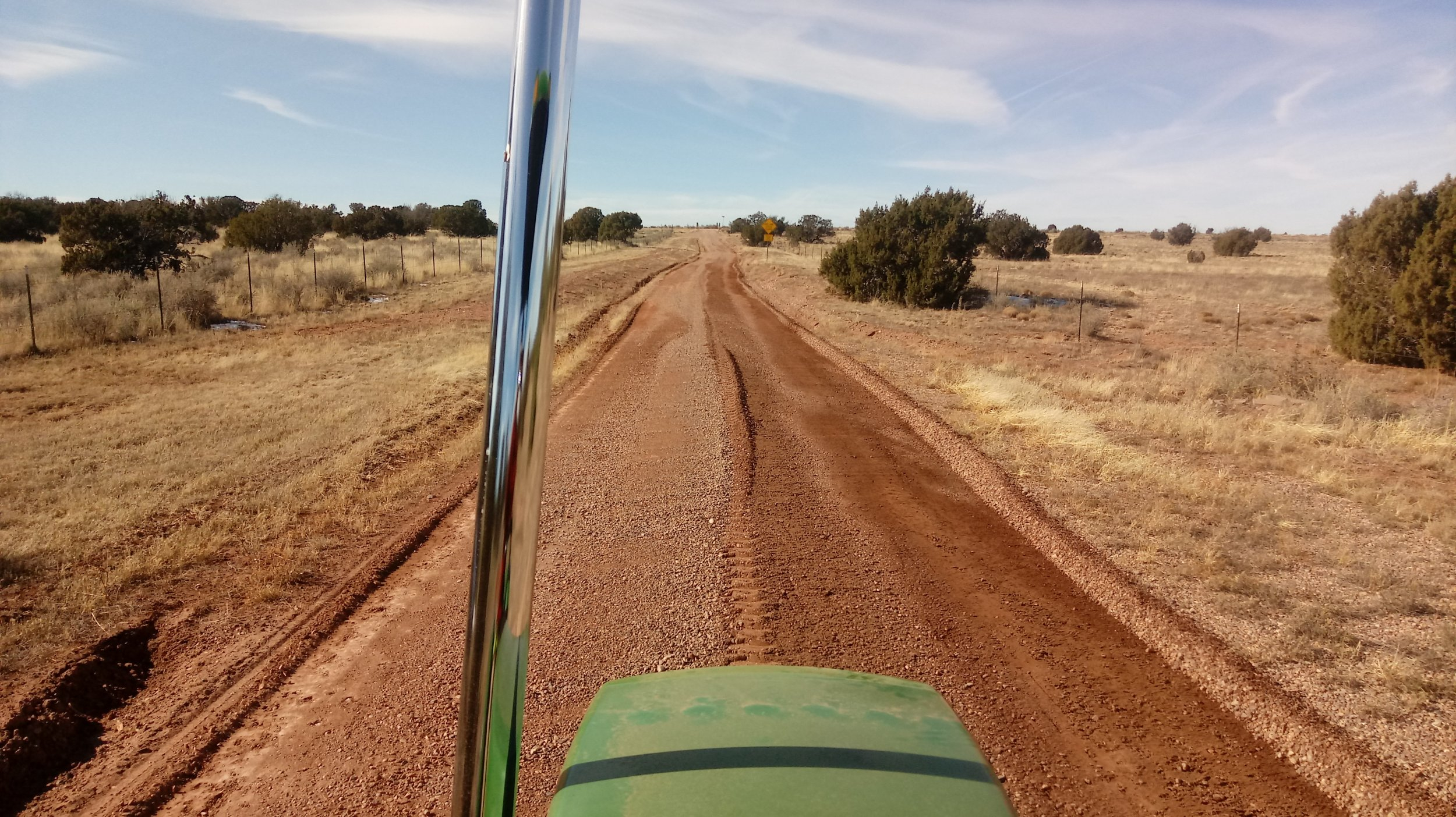

All you need is a rear blade, no fancy hydraulics, and a willingness to learn how to use it. See the results on my steep quarter mile gravel driveway here: Grading an "Interesting" Driveway

If you have ditches, I recommend a rear blade. Offset can be a nice feature too. We have a 1/4 mile street (non county maintained) so we do it.

I was going to say Box blade also but that pic of what the land plane did was impressive.

Snow finally melted enough to dress up the street, it was getting washboards in it. Ditches were still too muddy so I left them alone this trip. I need the gravel that's in them, the base is getting thin. Turned out pretty good. I just sold my box blade, I never use it.

The absolute best implement I can recommend is real nice but spendy even as a manual adjustable type. It's would be a back blade that has angle, tilt, and offset along with a set of bolt on end caps - and also has a blade that reverses (most do that).
Box blades are real handy - but not in all soil types - so the end caps let a back blade do the work of either a back blade and a box blade - more adjustably - and all in the same implement.
