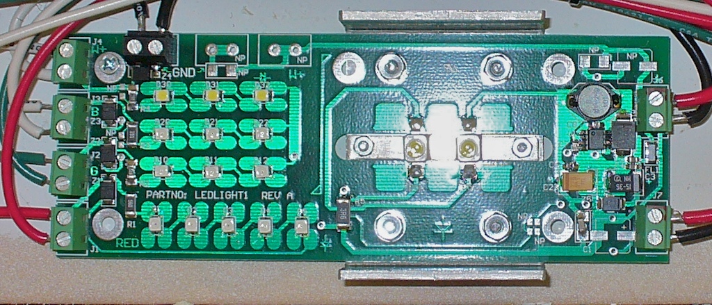

Finally, just for grins, here's a circuit board I did so I could play with LED light. The right side has two 1 watt LEDs. LEDs want a constant current, so the little circuit on the right is a switching power supply that makes constant current. There are now chips that do this explicitly designed for LEDs, this is a modified power supply chip. The driver is about 85% efficient, the new chips are closer to 95% efficient. You can see the .090 tick aluminum heat sink. It's about 2" long. After the LEDs have been on for 5 minutes, the heat sink is about 40 degrees above ambient, a bit hotter than I'd like. The dies (actual leds) are about 15 degrees hotter than the heat sink. On the left there are low power LEDs for colors- they don't need much heat sinking so the extra foil on the board is enough. I did that so I could have the top of the room light up in Red, Green, and White during the holidays :thumbsup:.

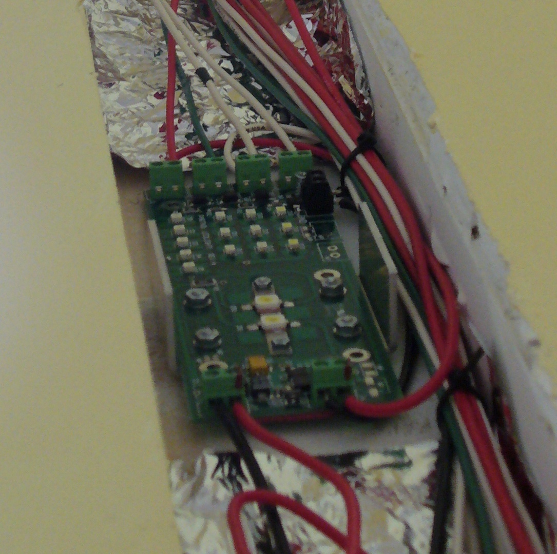

The 2nd picture is how I installed 27 of these in catwalk of our great room. They were covered with a strip of white plexiglass. The whole system runs on 10 to 20 volts DC. The circuit boards all fit in a channel that is the width of a 2x4. The aluminum foil helps reflect light back up in the room- these are pointing towards the ceiling for indirect light.
The system is no where near commercially feasible now, but everything that makes it expensive is electronics stuff that keeps getting cheaper as seen by the LED driving chips available now. The LEDs I paid $10 for are now in the $5 range. The effect of the distributed, diffuse light is very nice. I have three clusters of 9 boards. I have one of those as part of the emergency light system for the house. The problem gets harder/more expensive when you have to take 120V AC and make a .3 or .5 amp current source at about 6 to 24 volts vs. having a DC power source to begin with.
Hope this isn't a thread hijack...
