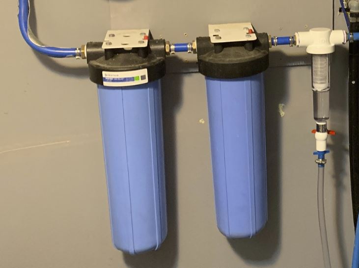

Here is how it is setup now. I installed the Rusco sediment filter. It is first in line from the well. This is more like a sediment/Spin down filter. From there it goes to the Big Blue, 20" 5 micron, then from there it goes to another big blue, 20" 1 micron then to the house faucets. I have had this setup for 2 days and this is actually working so far...... My water pressure is better now than it has ever been. I've noticed a difference. It's not huge, but noticeable.
What is nice about this Rusco vs the ISpring is that there is an area below the screen that acts like a sediment reservoir. Also, when you flush it, it has a 1/2" outlet vs the Isprings 1/4" outlet. When you open the valve to flush the water from the Rusco, the water comes out fast and you can see a little vortex in the reservoir while this is happening. The screen cleans out very well. It's only been 2 days, but the Ispring clogged up within a few hours. If this does work out for me, I am going to connect a garden hose timer to auto flush the system.

After using the Rusco spin down, my filters are still white. They have only been in use since I start this thread, but without having the Rusco, they would have had quite a bit of black on them already.
