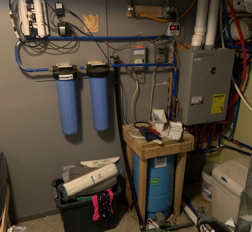

Alright, this is what I am going to do. I installed a larger 100 micron spin down over the weekend and although it lasted longer between purges, it wasn't all that much longer. The issue with the spin down is that there is not enough surface area so it clogs faster. The big blue filters lasted longer even though the one was only 5 microns, but that is due to more surface area, being pleated and a longers, 20" filter. I decided to add a third big blue 20" housing with a 50 micron filters. So it will go water from well, to 50 micron, then 5 micron, then 1 micron, then the water softener then to the fixtures. I think the 50 micron will help all the filters last longer by removing the larger stuff first. I'm taking the spin out of the picture completely and sending it back. It just doesn't work for my situation.
I noticed with the spin down that it was filling up will black silt like substances. It was too fine to purge when I opened the valve. I had to remove the screen and scrub it with a brush to get that black stuff off. It was very fine. I'm guessing it is magnesium of what I read.

It sounds like manganese which precipitates from the water as a black film, usually it occurs in conjunction with iron or iron bacteria. If so, then it isn't sediment being sucked up by the pump, it's a chemical precipitate being deposited on the filter media. Low concentrations can be effectively treated with just the softener, higher concentrations require a "green sand" filtration system.
Ask your neighbors what they are using. Have the water sampled and tested for iron and manganese to see what you are actually working with and then use the data to come up with an effective treatment system.

If you take a glass of water off the sampling faucet, you'll see what material is clogging your filter. If it's sand or grit, that'll be eroding your pump impeller away and clogging the pressure tank. Sadly, the permanent fix will make the filters look cheap. For my house, I piped in two big blue filters parallel. That way when one goes down, I can switch over to the second one until I can service the first one.
Iron bacteria, if bad enough will clog filters pretty quickly. It forms greasy strings in a glass and is slimy to the touch. Can turn the water coal black and stinks bad. It's taken a few years, but thankfully our water has cleaned up.
/ Well Water Filter #29
I would get your water tested and then "Shock" the well with either commercial strength peroxide or a gallon of Clorox, let set for 24 hours then flush. This "Shock" will normally kill the iron bacteria for a year or two. I sometimes have black slime, sometimes brown slime.
Sounds like you are trying to solve a major water filtration problem using the pile up method... BUT you can only pile so many filter on before you get to a point where it would have COST less calling in a Specialist... yes an Engineer !

I hear what you are saying. I guess I'm trying to tweak this the best I can. When I bought the house, there was a single, 1 micron big blue filter. I would change it every 3 months. I should have left well enough alone. Everything worked, I was just trying to buy more filter time. Then I heard about the spin down filter. It sounded like a great idea, but fine silt would stick to the screen and the black magnesium would stick to the silt and bake onto the screen where it wouldn't let the silt spin down when purging.

I have lots of sediment like material in my water,
Filters lasted about a week or 2 so I needed a better solution.
What I used was a swimming pool fine mesh 'sand filter' but needed to adapt it down from inch and a quarter to my 3/4 inch pump line.
Works great!
I now only need to clean that filter every 3 months or so.
I say clean as I merely use a nylon bottle brush to loosed away the fine particles that accumulate.
That same pool filter has been in use for close to 20 years now with no hickups.
Usually cleaning is indicated when the tap flow/pressure tapers off.

what u can do, is add a cistern or small storage tank, let all the water pump into that via a float switch, then use a secondary booster pump to push it through the filters etc. all the sand would drop into the tank and your inlet for your booster could be a couple inches higher, that would reduce most of the filter clogging.
/ Well Water Filter #36
I run two big blues - sediment in the first and RFFE20-BB Iron cartridge in the second. It has eliminated the brown/rust stains in toilets and sinks. Go through two sediments for every one iron cartridge.
If you have a manganese problem, they offer that too in an iron/mang combo cartridge.
