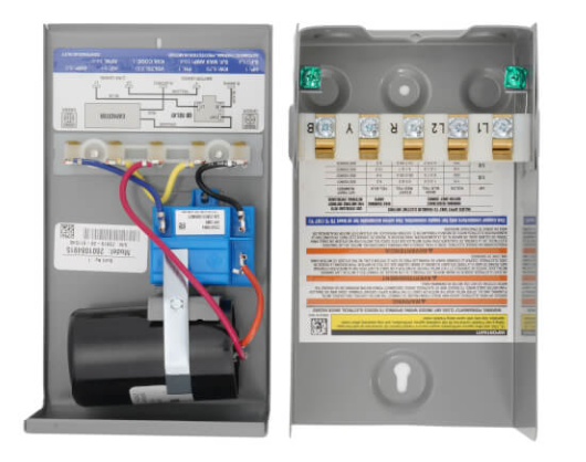

Isn't the start cap behind the outer cover?
You might be right. Come to think of it, I’ve seen them both ways.
edit: Just saw OP posted new picture showing cap and relay behind cover. Sorry about the confusion.

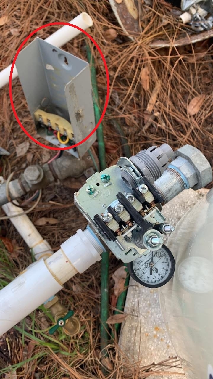

/ Well pump #22
According to this picture if cover with start capacitor and relay "slip" connects with wired terminals and with what appears to be check valve below pressure switch, all you are missing is L1/L2 (from fuse/circuit breaker) routed through pressure switch to pump control box....
image-jpg.3253057
/ Well pump
#23
image-jpg.3253057
Wired it in this afternoon and everything works as should.
Thanks again to everyone that commented

I have in my possession a 1968 Franklin control box with the guts in the cover. You must have some really old stuff where you are.
/ Well pump #30
Maybe! It can be tough to tell the age of a box mounted to a wall in a basement utility room. I wonder though if Franklin was just the first to switch to this style, before some of the others.
/ Well pump #31
I believe Franklin was the first with the quick disconnect control box. Most others at this point make a box that is interchangeable with Franklin.
