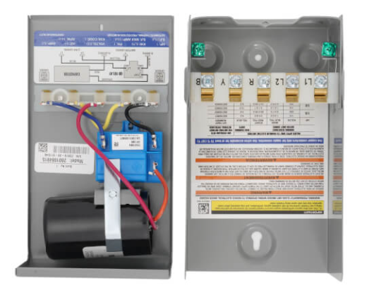

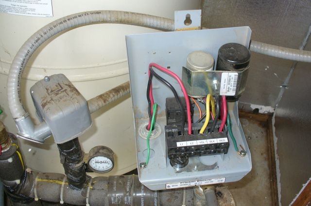

Isn't the start cap behind the outer cover?
You might be right. Come to think of it, I’ve seen them both ways.
edit: Just saw OP posted new picture showing cap and relay behind cover. Sorry about the confusion.

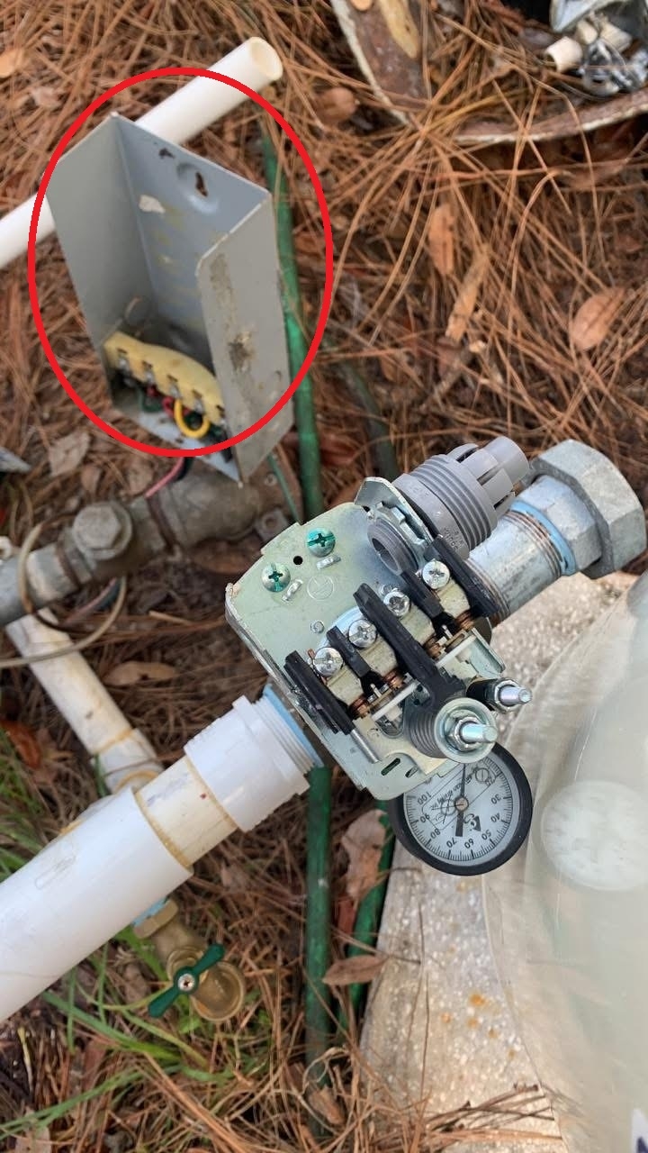

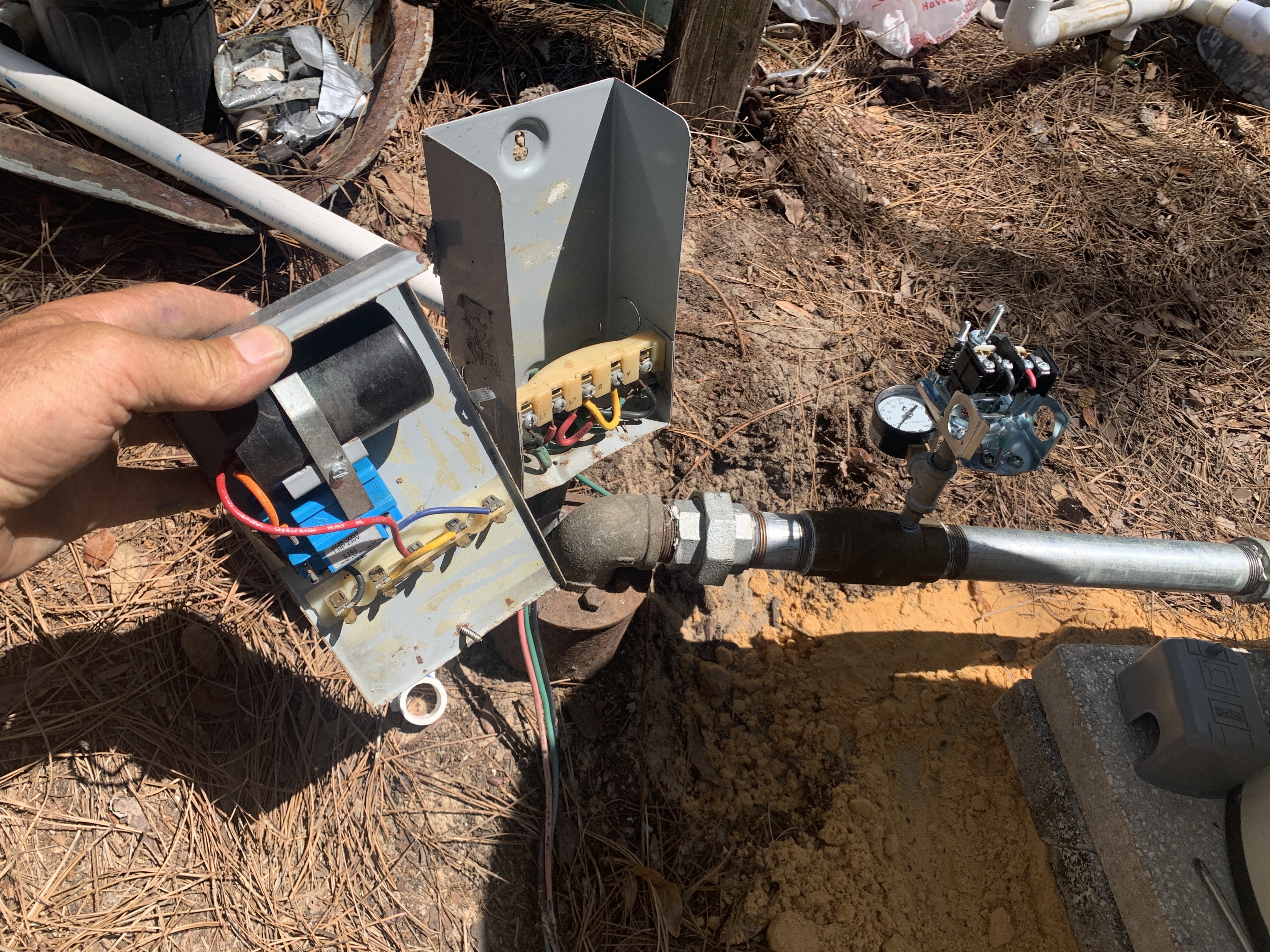

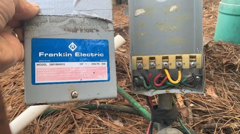

According to this picture if cover with start capacitor and relay "slip" connects with wired terminals and with what appears to be check valve below pressure switch, all you are missing is L1/L2 (from fuse/circuit breaker) routed through pressure switch to pump control box....

Wired it in this afternoon and everything works as should.
Thanks again to everyone that commented
