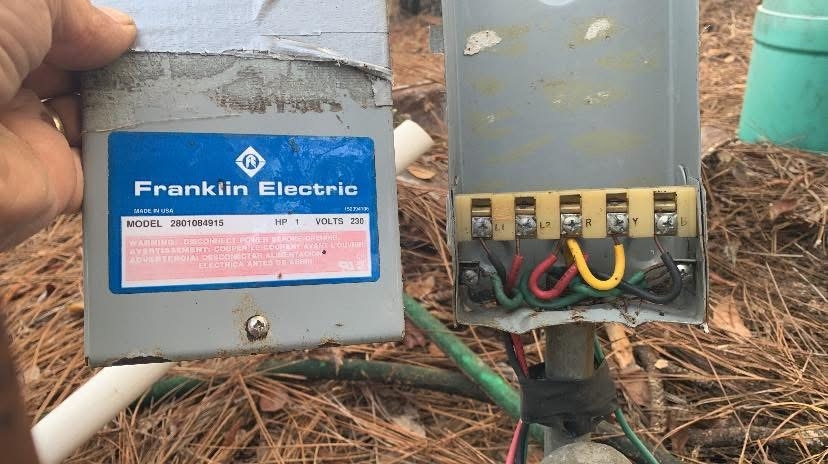

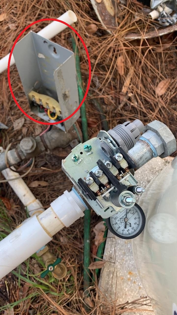

I know a lot of you guys are electrically minded.

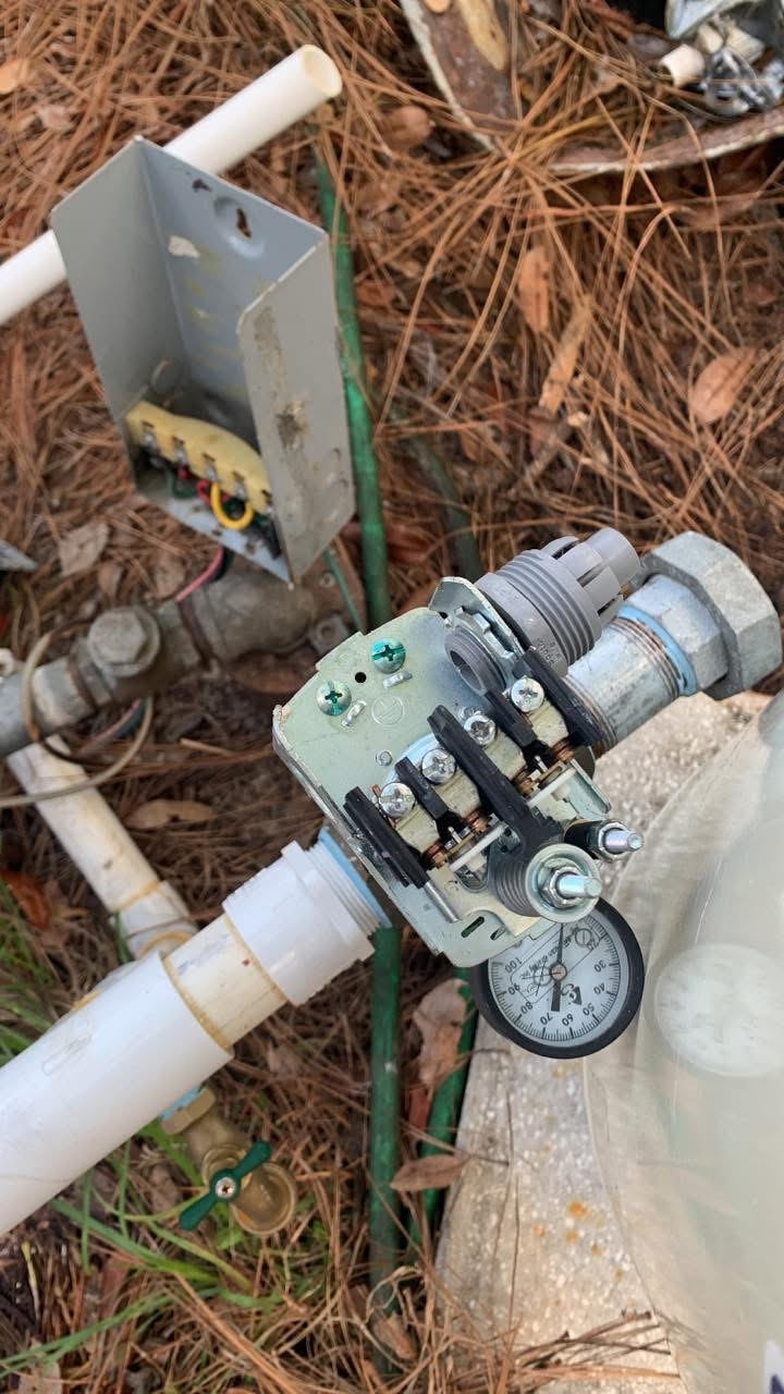

Could someone tell me how to make the connection from this pump relay switch to the pressure switch.
( Standard square D switch )
We have been running this pump full blast for more than 15 years on irrigation ( just using the breaker as an on/off switch ) but now would like to install a pressure tank.
Thank you

Right now your setup is: 240v -> pump relay -> pump
All you have to do is insert the tank switch: 240v -> tank switch -> pump relay -> pump
In other words, the wires going to that relay will now come from the tank switch, and the 240v circuit hits the tank switch. Easy peasy.

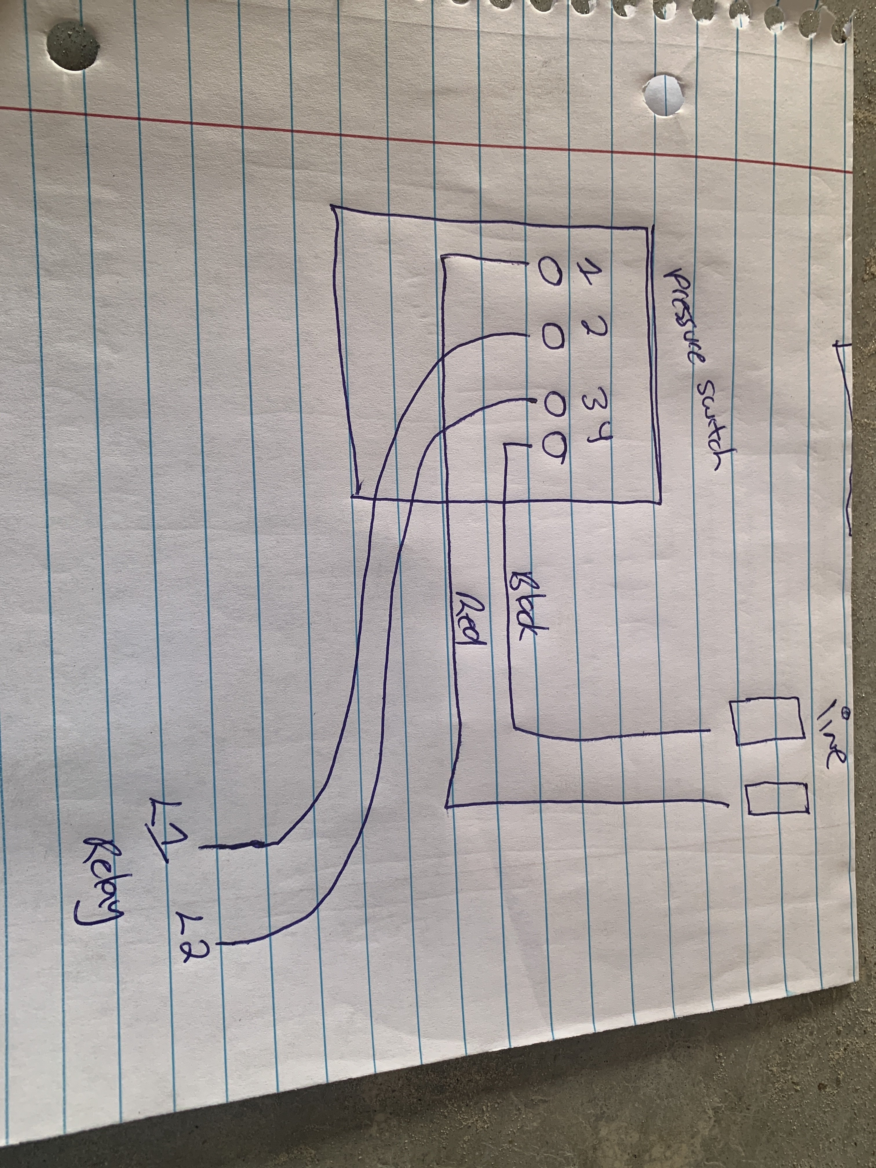

Thank you, just to cross my tees, I’ll remove L1 and L2 ( labeled this way inside my relay box ) ( these are my two incoming feeds from breaker panel ) and place them on pump switch as shown in my diagram.
Then I would re feed L1 and L2 from 2 and 3 from the pressure switch.
Sound correct?

Wait, something is wrong.
What you have in your hand is a motor starter control box. Your pump, if a 3 wire motor won't run without it, it's not an option. I also see one in the picture for a larger motor.
Circuit breaker, pressure switch, control box, motor.
Sound correct?
Yes, that should do it.
To be absolutely certain:
  1. Verify L1, L2 voltage in current setup at relay box
  2. Open breaker (de-energize circuit)
  3. Disconnect L1, L2 in relay box
  4. Connect Feeds from breaker panel to pressure switch
  5. Close pressure switch (it should have a lever that lets you close it for testing)
  6. Close breaker (energize circuit)
  7. Verify current at relay box on new L1, L2
  8. Open breaker (de-energize circuit) before further work

He's just putting a pressure switch between the breaker and that box - keeping the starter box.

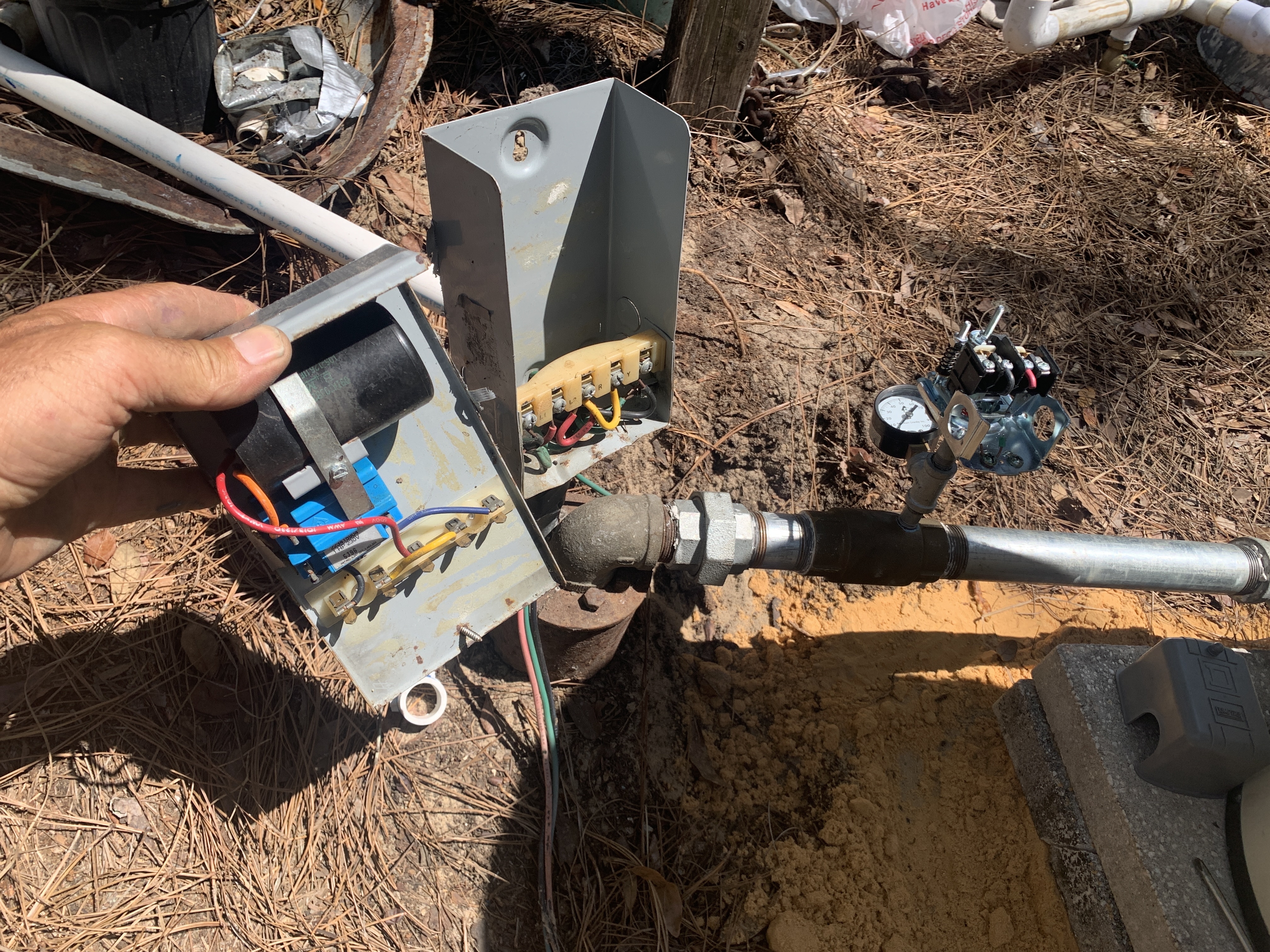

Umm second picture shows a pressure tank, pressure switch and the starter controller ..... Do you have this or is pict for example....
Sorry for the confusion, I don’t know how that picture got on there
I fixed the original post

I have already traced the wires, should be good to go
Thanks again for taking the time to answer my questions

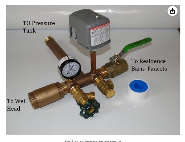

You are going to want a check valve between well head and pressure tank otherwise when pump shuts off water is going to drain back into well.....
Something like this....
Thanks for pointing this out, I probably would not have caught this otherwise

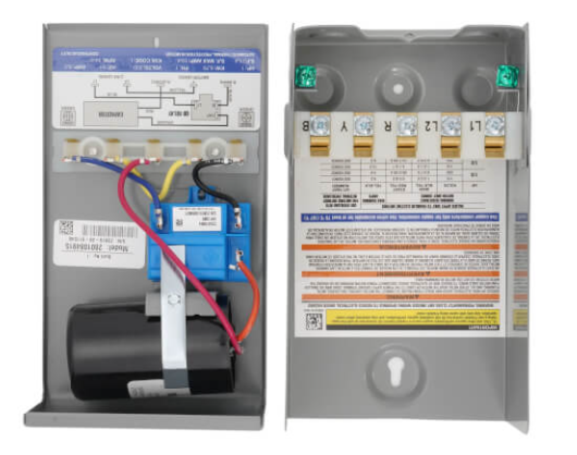

All of the information given above is correct, with the exception of the starter box confusion. That box is doing nothing but serving as a wiring terminal, it was gutted by a previous owner, when the pump was switched from traditional 3-wire (requires starter) to 2-wire (has internal starter).
If you ever replace that pump, I'd go back to traditional 3-wire and install a new starter box, since it's stupid to have to pull a pump everytime a start capacitor fails. Pumps typically last through at least 3 start capacitor failure cycles, unless pump conditions are very bad (e.g. silt, mineral, etc.). With a traditional 3-wire setup and starter circuit mounted above ground, it's an easy 5-minute / $5 repair.

Question for those that know - do you have to put both L1 & L2 thru the pressure switch or can you just run one leg thru the pressure switch? If one leg is off won't the pump not turn on?
E.
/ Well pump #13
Common and even maybe NEC code is to put both L1/L2 through pressure switch, otherwise you have a always hot leg going into pump and it may feed back and cause you harm (electrical shock) if you assume the pump is switched OFF by pressure switch....

WinterDeere, what leads you to believe the box is gutted? Although I agree with everything you said about 2 wire vs. 3 wire.
Everhard, you can break just one leg, but it's not recommended.

Have to believe what winterdear says.... There is at least a start capacitor in box along with a relay...
Below is typical setup as we do wells on west coast..... Pressure switch to pump controller....
Though my controller is different from one pictured in message #1, its typical of submersible pump controllers....

If there's at all a chance that your well will get pumped out - temporarily run dry - there are also boxes called "pump savers" which will temporarily turn off power to the pump if it senses through current draw that the pump isn't ... pumping. They have adjustable timers for how long to wait to turn the power back on.
