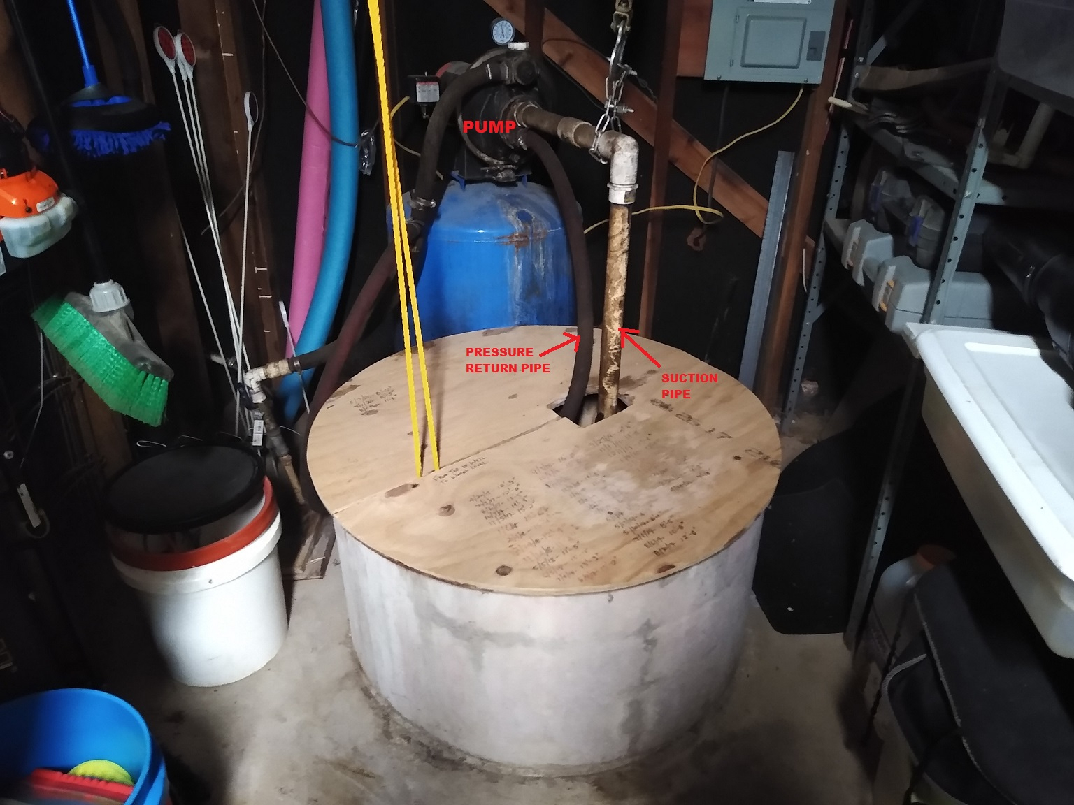

I replaced my 1 HP convertible jet pump with a 1/2 hp 10 gpm submersible pump. Granted mine is a 42 ft shallow well and pipes water about the same distance (100 ft) to the house.
Quieter operation and used less power. Couldn't stand how loud the jet pump was since it was located above the well and the well is located in the shed where my tools are located.

I am guessing a "vertical pump" is located in the well on the bottom of the drop pipe? If so this is considered a submersible pump as it is submerged. I am guessing a "horizontal pump" would be a jet pump like tradosaurus's photo shows. If your going from a jet pump to a submersible pump, you will need more pipe as you have two pipes going down the well, and you will need a venturi / foot valve on the bottom. Jet pumps pump some water down the well, through the venturi that creates suction, bringing up more water than you pumped down. A damn inefficient way to move water.

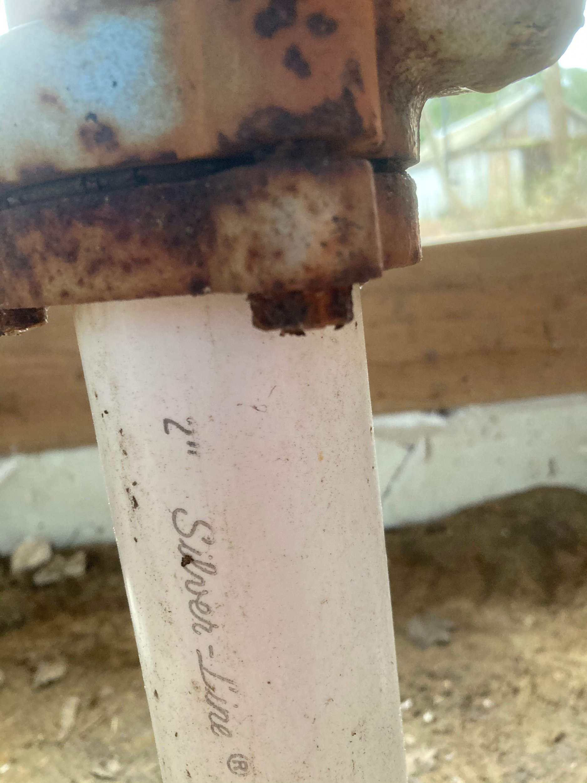

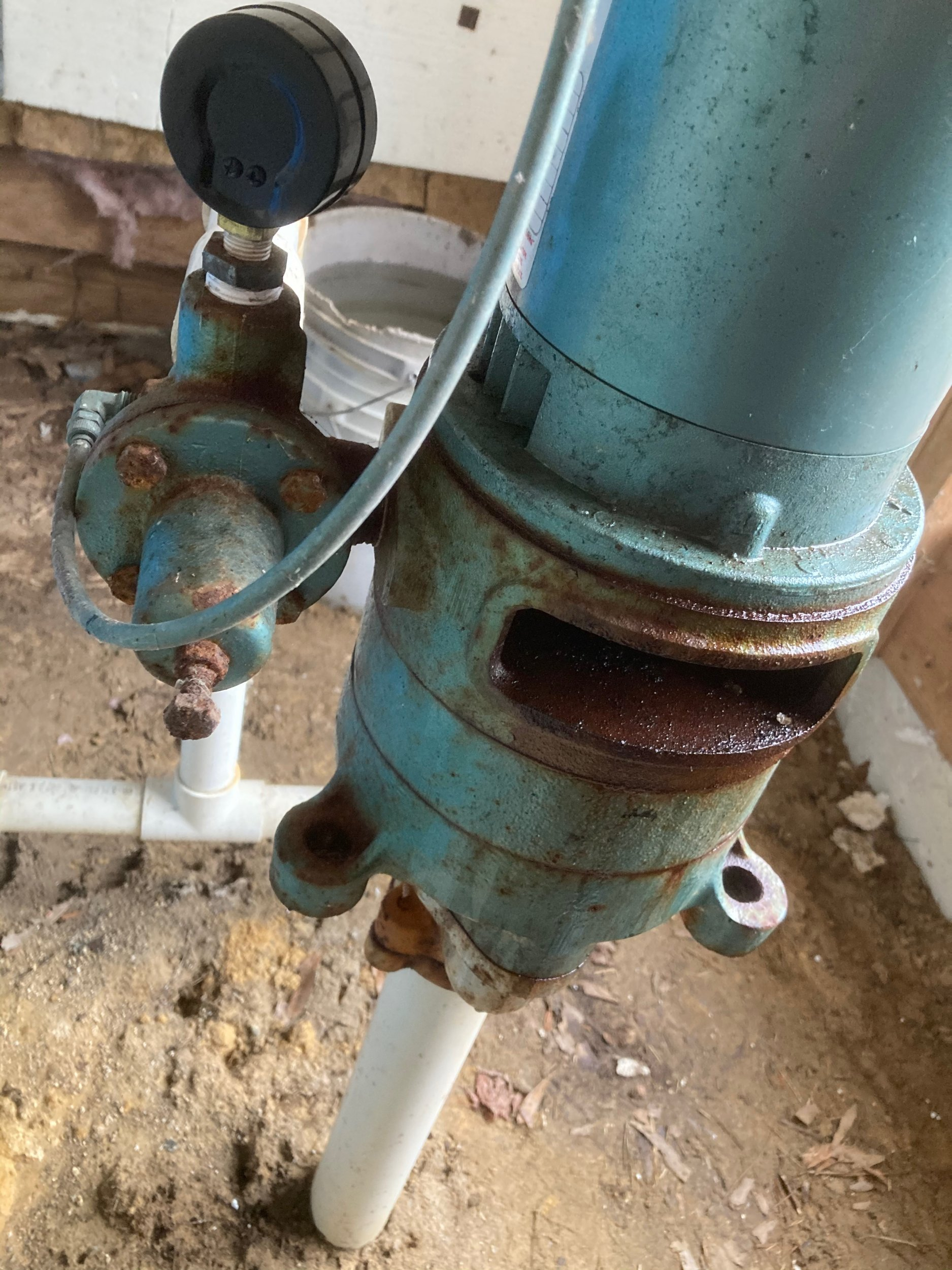

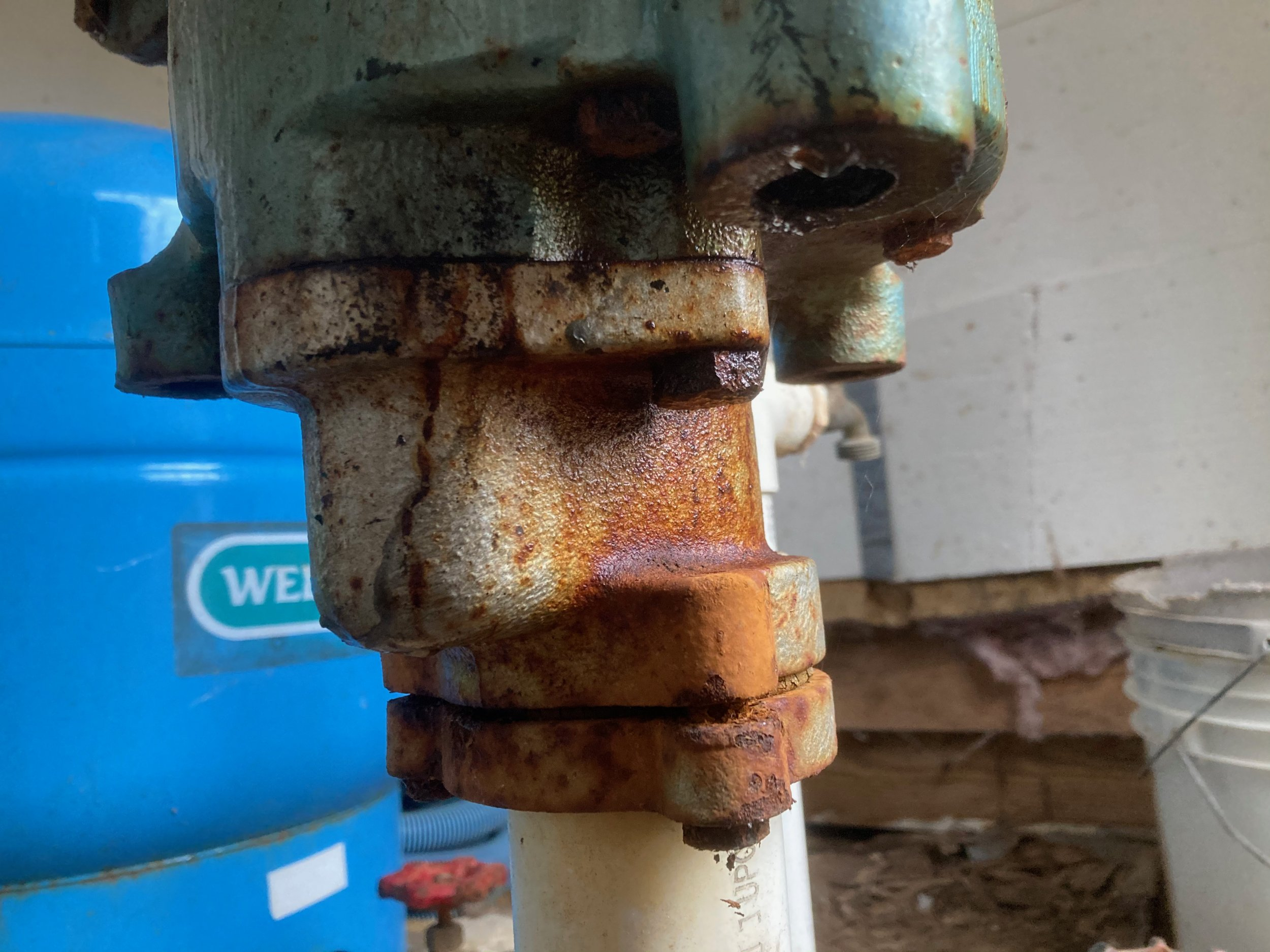

The pump is sitting on top of a piece of 1-1/4" PVC about 12" above the ground. It is a level run to the house, maybe up 2 ft. There is that single pipe going down into the well that the pump sits on and one pipe heading to the house.

Sounds like a deep well jet pump. Like was said switching to a submersible can have many advantages. But I am afraid you may have only 2.5" casing. The casing will need to be at least 4" diameter to use a submersible. If it is 2" or 2.5" casing you are stuck with an ejector at the bottom and a vertical deep well jet pump up top.

I think yours may have the motor on top like a vertical jet pump.

Yep. Looks like 2" casing which means you are stuck replacing the with same kind of pump. Those are good pumps though and work well with a Cycle Stop Valve.
