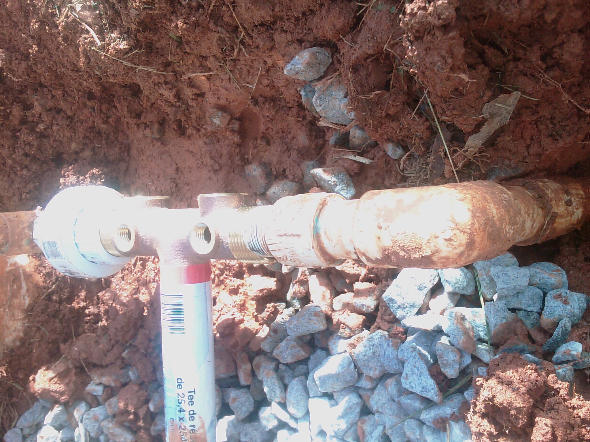

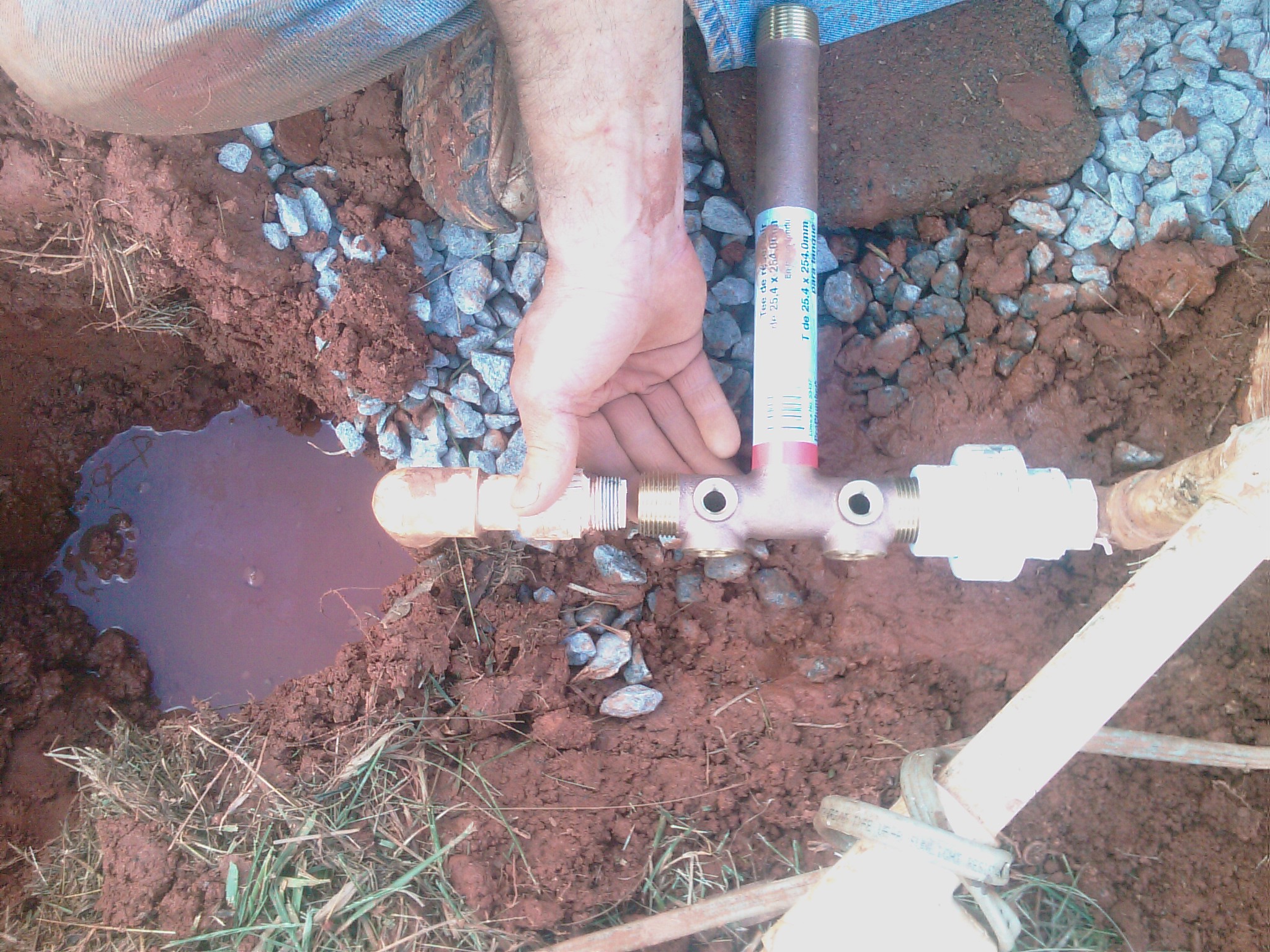

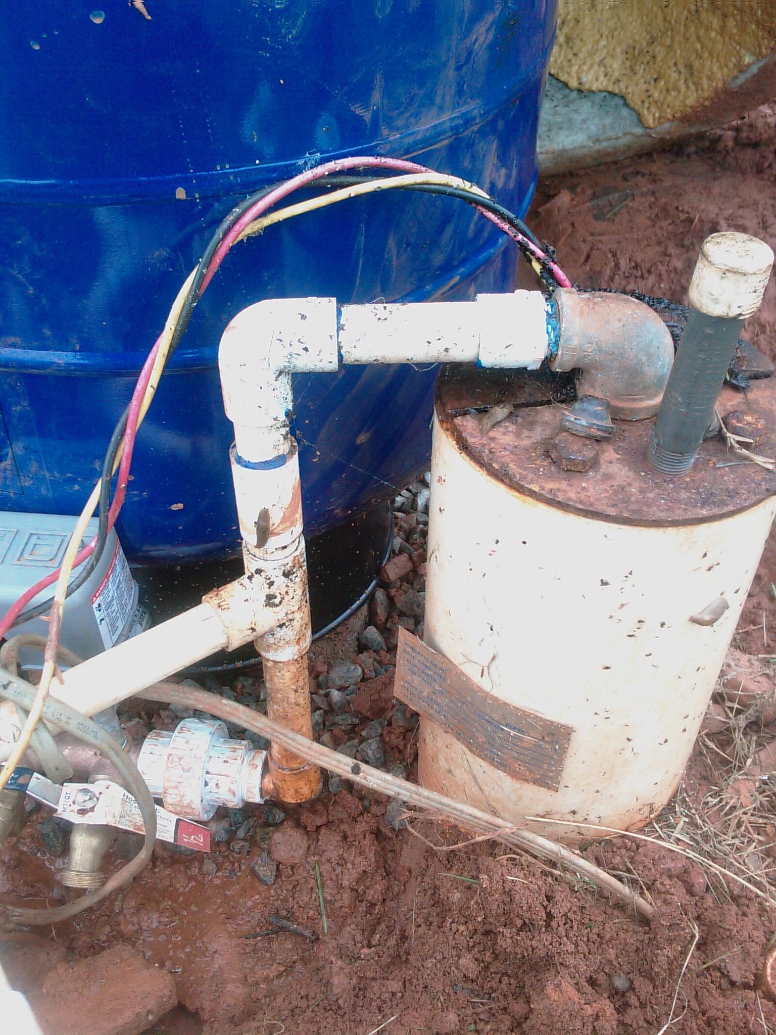

Dave,
I think it's 1" out of the well.
This post shows the pics of the setup.
http://www.tractorbynet.com/forums/projects/195605-well-pump-planing-2.html#post2246476
I think what i need to do is run 1.5" out for sprinkling.
Is it best to use PVC, Poly or Pex for this the runs would have to be plus 300'.
