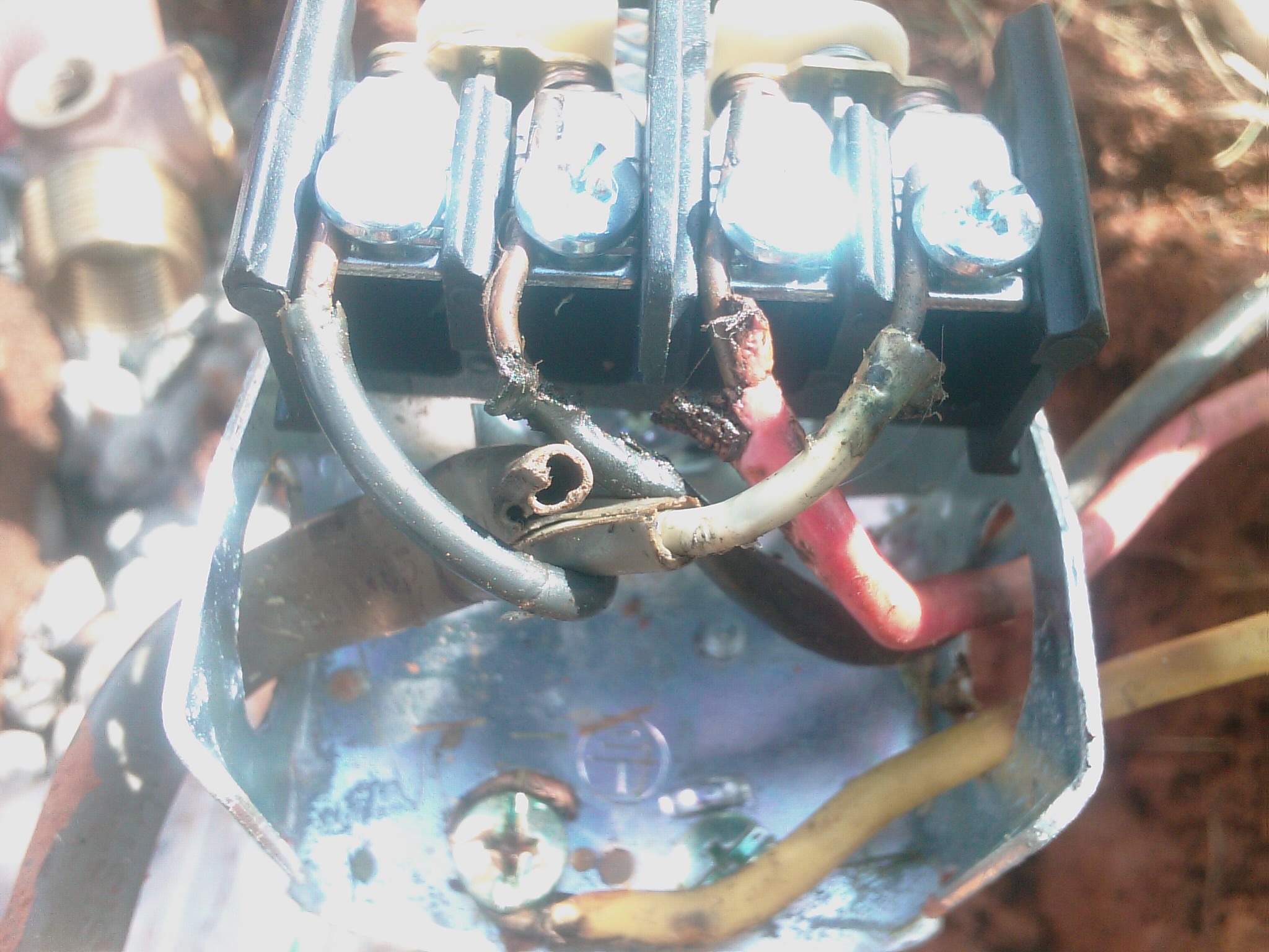

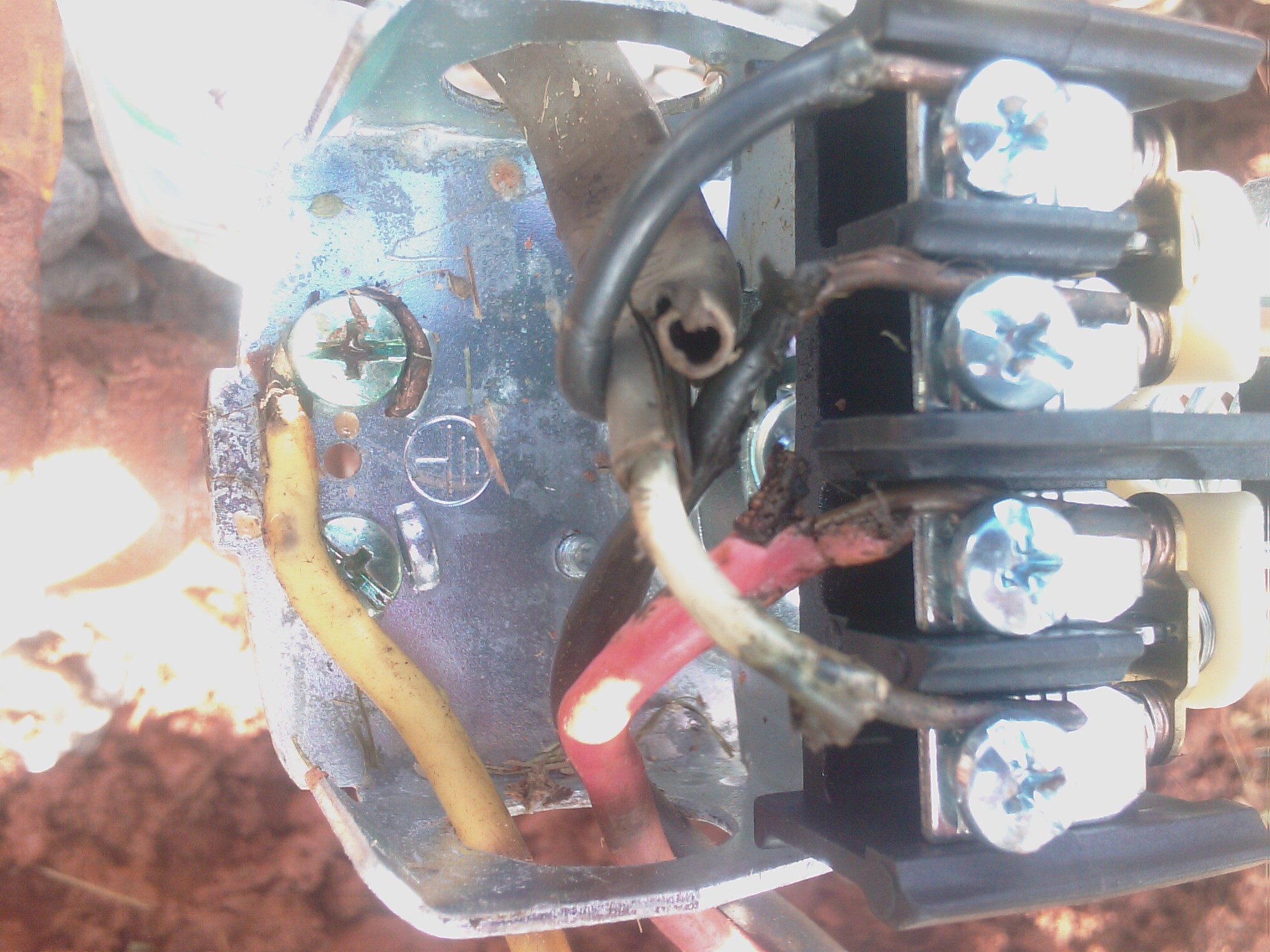

Here are some pics of the well from when I replaced the pressure tank.

Your electrical connectors sure look rough, make sure none of them are loose or close to touching. Bugs love to get on top and mess up the contact, don't leave any openings on switch, ahla ducttape...
