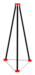

I have a pump and drop pipe in a well that I want to pull. Of course I could hire it out and may have to. There are several reasons and one huge reason (unstated) that I want to avoid that approach.
I have in the past lifted the pump and drop pipe a little (a couple of ft or so) for routine mx at the well head.
This time I want to pull it entirely.
There is no safety cable attached to the pump.
The drop pipe is 2 inch threaded Schedule 120 PVC 1120 pipe.
The pump is a 3 phase 460/480 volt motor on a 50 gpm pump.
Guessing on the weight of the motor and pump but maybe 30-40 lbs or so
The 280 ft drop pipe - a little over 300 lbs plus 14 brass couplings at a pound or so
Weight of water in pipe since there are check valves is in the ballpark of 380 lbs
Bottom line I am not going to hand pull 700 to 750 lbs of drop pipe from this well.
With the drill casing being about 2 ft above grade I figure each lift will be about 24 ft to the next coupling.
A tripod that is 24-26 ft tall or a boom of some nature (2 beam) are ideas I have but managing the lift of the structure into position for the tripod or the boom have issues of concern. However the biggest concern, not being a structural engineer, is stoutness of the structure. I don't need it to collapse under the weight and injure a human nor do I need it to drop pipe and pumps in the well. I also don't want to over engineer it so that the weight of the structure makes the lift of the structure impossible either.
Any ideas would be appreciated on a lifting design for this.View attachment 734804

@oosik Well I am still evaluating just what I am going to do. Since I am in no rush at the moment I have the time to determine the best option. Maybe the pull will be done this summer or even next year. I was really hoping that some structural guy would post something that would give me a better clue so that my boom design would not be overbuilt which i am prone to do. I have thought of using 3 inch sched 40 steel pipe (which I have) or maybe 2 inch pipe , or 2x2x0.25 square tube; probably way over strength and also thinking of 2x2x3/16th sq tubing. I fear 1/8 tubing would be too weak but I am trying to look up the equations to do the calculations.
The suggestion that was made to use a scaffolding or a man lift is interesting but I think there has to be a way to do it with a boom type structure that is more portable (maybe).
The lowest estimated cost from the pump companies was $2200 just to pull the pipe and pump.
One individual stated it will mostly likely cost me as much to build what I need as it would to hire it out but I would have the setup for the future.
I have trouble thinking that I can't build a boom that is structurally adequate for a bit less than estimate to hire it out. I have considered a two leg boom as well as a three leg boom. Obviously with lattice cross members to support the legs. Once I get a good idea on the design I want to use for the boom/tripod/lift mechanism then I can cost it out and figure out what I want to do. The cost estimate was a bit higher than I had expected and with the other unspoken reason that I mentioned in the original post I really hesitate to have a pump company do it, but we will see.
As I posted previously my initial weight estimate was 700-750 and I see where @Valveman stated around 800#. My weight estimate will be quadrupled at a minimum for any structural calculations. Obviously the weight will decrease as it is lifted but the initial lift weight has to be accounted for and maintained for the entire lift.
