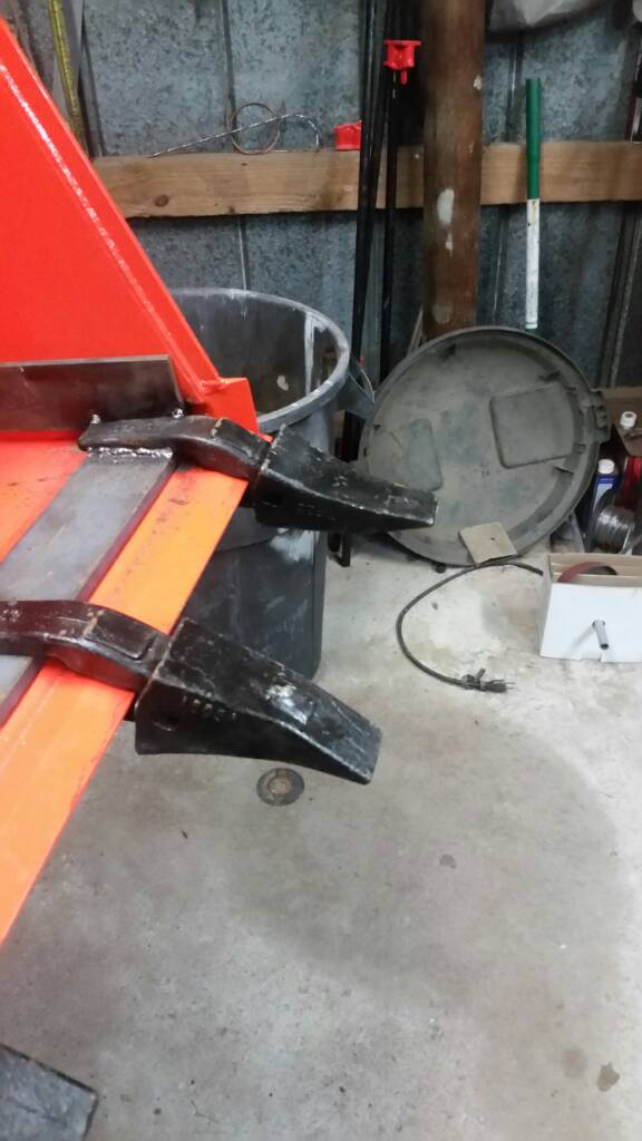

Working on fabbing up my tooth bar and I'm wondering which way the teeth go on when I get finished, it's not super obvious they fit equally well both ways.

Definitely the one on the far end.
Look at the one closest to the camera. If you sat the bucket flat on the ground and tried to skim the teeth would be gouging all the time. You would NOT like that!!!! :)

Yep got welded up and teeth installed I'll post a pic later.

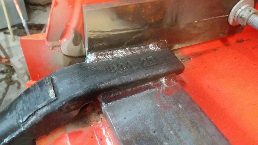

Looks good - nice job. I bet you like the way they improve your bucket and cutting edge capabilities. :thumbsup:

You better believe, I never ran this one without teeth but I have ran another loader tractor extensively without teeth and wow what a difference.

Yes very nice and nice welds too! Amazing what teeth can do for a bucket and digging. :thumbsup:

I got the same Titan weld kit. The flat stock is 4 inches wide by a half inch thick. It was a fairly hard alloy. I tried band sawing it but switched to a grinder cut off wheel after ruining the blade. Lots of orange sparks.
