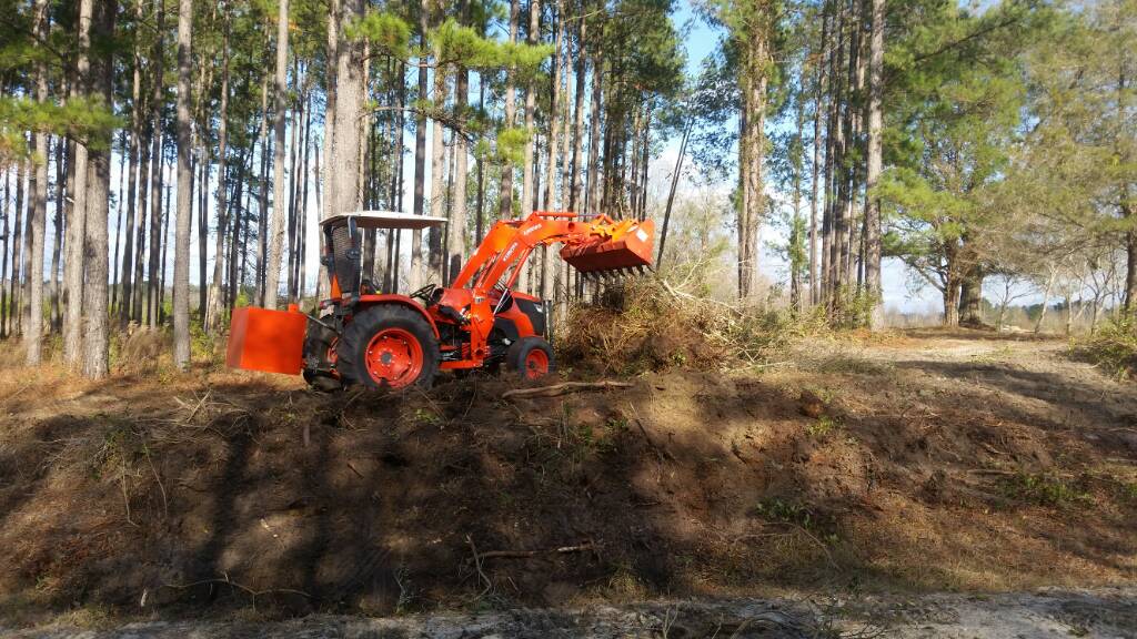

I got the 72" 9 tooth for my TYM T503 from Titan. I welded it up with a stick welder and wasn't paying attention to how hot I got the flat bar, ended up with a bow. It wasn't a big deal, took a small hydraulic jack and chain to straighten it out. The reason I purchased it was to move and spread about 500 yards of clay dirt mounds. The dirt had been sitting there about 2 yrs and over time I had already spread about 500 yards, so I got this to see if it would help out. What I found was that even though the clay dirt seemed hard on the outside the inside was still soft enough that the dirt wouldn't just break up and that I still had to work the bucket to get a full load. It did seem to help a little and I have no regrets in the purchase, it will get used.

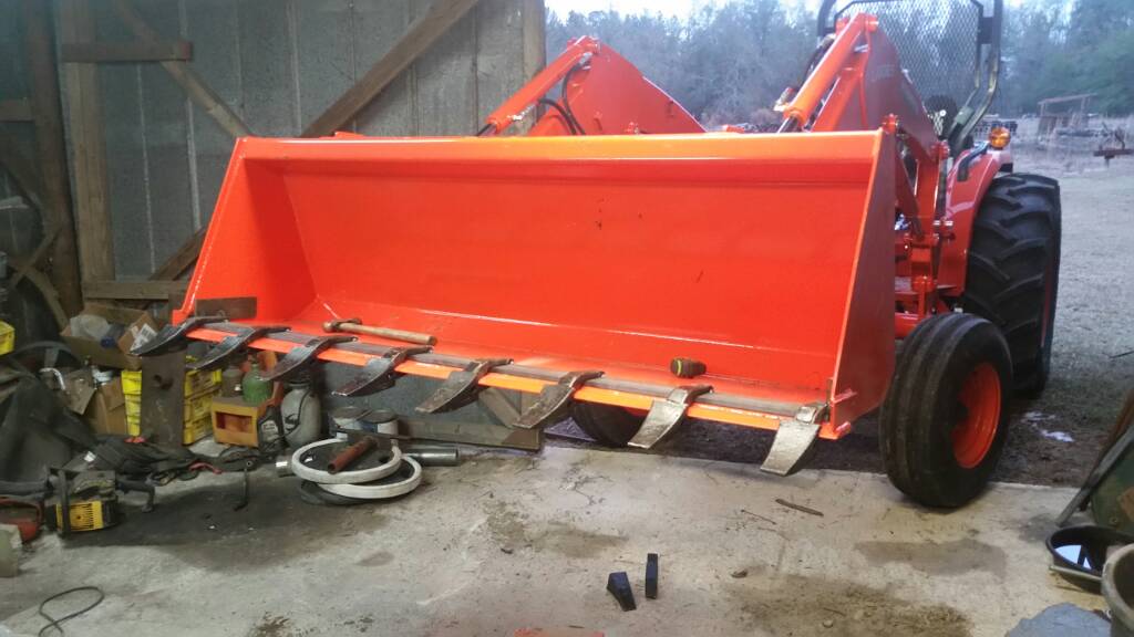

I used a big old 240 VAC MIG from the 1980's. These days it only works on the highest settings and feeds. I converted over to flux core a few projects ago and this was yet another practice project for me. I have not run the tooth bar through the ringer yet but I believe I got good penetration (better with flux core?). For the side pieces that bolt to the bucket itself, I pre-dressed bevels and welded both sides, ground the welds almost flush, then put the tooth holders on. I also had problems with heat bending; clamps and hammers convinced the toothbar that it really wanted to be mounted.

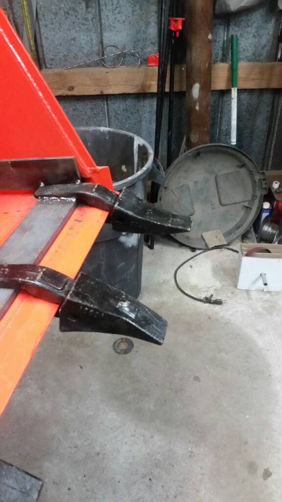

You need plenty of heat for deep weld penetration to get a tooth to hold. Weld up bar bolted to bucket. Make sure top weld is still hot when you do the bottom, etc. maybe Preheat, but do not heat the tips.
/ Welding up a toothbar #33
Mike, I'm concerned about it enough that I'm going to take it to a pro and get it stick welded. I'm going to take the bucket with me after I tack on the mount points to the main bar then drill and mount the bar to the bucket. I'll help him clamp on the teeth and he can weld them solid. I also picked up three 3/8" weld-on hooks so he can weld those up at the same time. Glad I bought pallet forks now. ;)

I went up to the property today and did about 5 hours of work then put the loader bucket in my truck bed and brought it back home. It will be two weeks before I get back to the tractor so this will give me time to mock it up, tack weld it and take it to someone who will get the job done right. I'm going to have to unload it onto my metal saw horses in the garage. There, I can fit the bar, lay out the teeth and tack it up.
I ended up getting the metal at a dealer in North Austin. I actually saw their shop on Velocity watching Jesse James Outlaw Garage. Bob from the show went to this place to get metal. Westwood Metals is great! You order the pieces cut to the specs you want.
I also picked up three weld-on 3/8" hooks. I'll have those done at the same time and will reinforce the top edge of the bucket with angle iron and have those hooks welded to that.

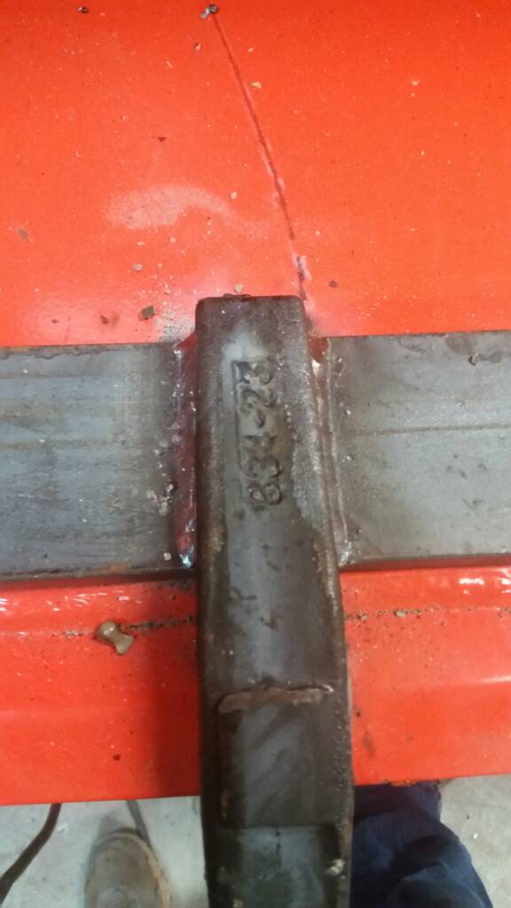

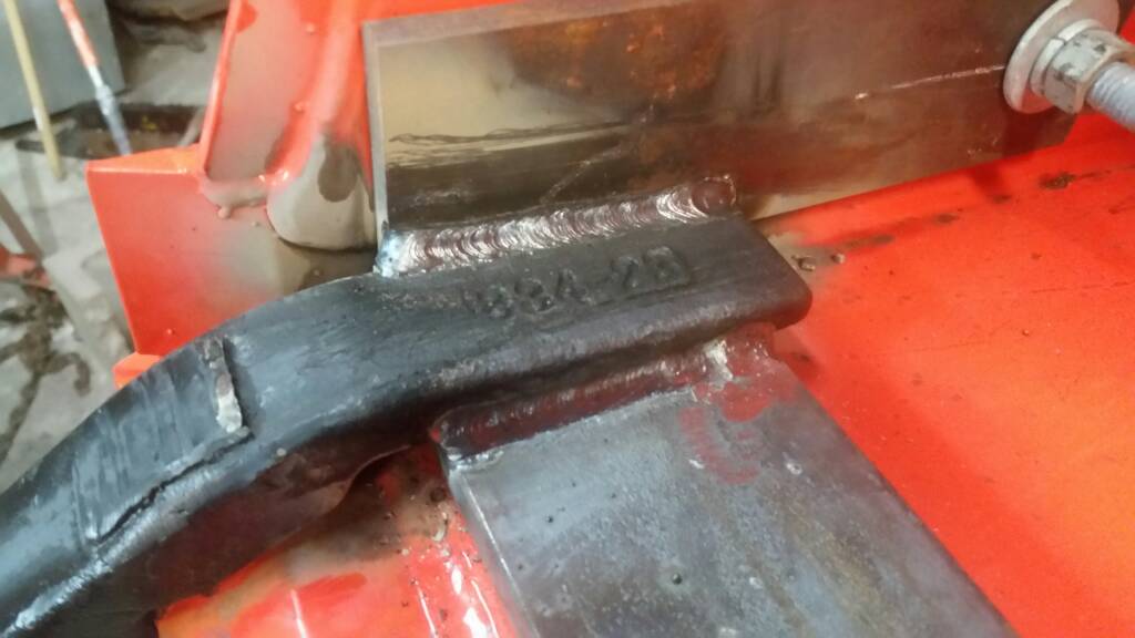

Turns out the MIG handled it very well. My welding isn't spectacular but I'm betting these are not coming off any time in the next decade. I have to clean up, prime and paint it, then attach the teeth.
/ Welding up a toothbar #38
Almost done. A little more grinding then prime and paint.
