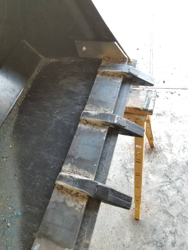

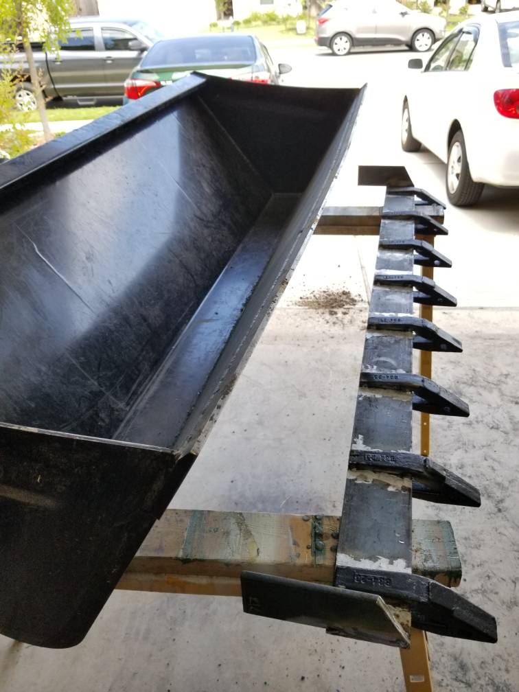

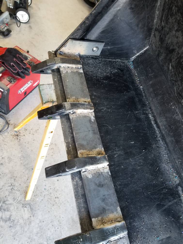

Turns out the MIG handled it very well. My welding isn't spectacular but I'm betting these are not coming off any time in the next decade. I have to clean up, prime and paint it, then attach the teeth.
View attachment 517741View attachment 517742View attachment 517743
