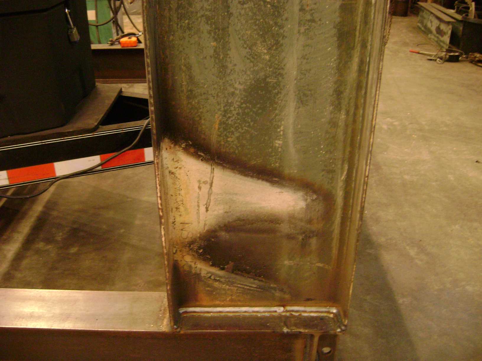

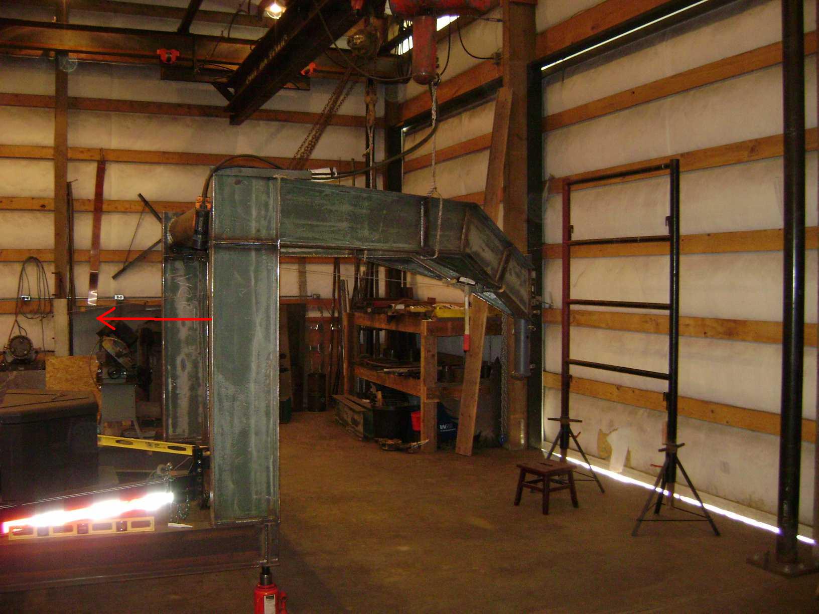

Don't know why I don't take pictures of the item when completed:confused:. I guess I'm just interested in showing the technique. Knowing where to apply the heat is easy, how much heat is the trick.
Here's one I lucked out on:D. When I built my gooseneck adapter the one beam was not 90-degrees. So a little heated wedge, brought it back to 90-degrees.;)
