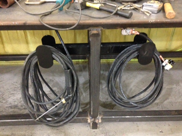

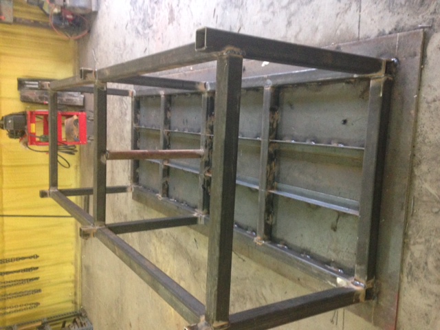

I have a 5 x 10 welding table framed in 11ga 2" sq tube. I used a 5 x 10 piece of 1/8" tread plate (smooth side up) for my table top and it's been plenty for me. I hammer on it with a 3# sledge all the time without any problems. The tread plate was never perfectly flat but it's flat enough for me.
/ Welding table top? #15
I guess it all depends on your intended uses. I tack weld stuff to my table top to keep it square, set heavy things on there using my skid steer, etc. and need the thickness. I use my table almost daily and I can't see myself ever wearing it out or damaging it. The weight of the thicker plate is a great benefit as well because my table is rock solid. I have a heavy duty vise mounted on the edge and I can put things in there and beat the snot out of them or use big pipe wrenches with cheaters and the table does not move.
Years ago I worked in a shop that had a table top made out of 1/8" material and it was bowed down around all the cross members and looked like the side of a car that had been through a demolition derby. Then again if you are just doing light duty stuff on a hobby type basis and are not setting anything on it that you can't lift up there by hand then thinner might be ok.
When I built my table it took me a couple days. My time and the work involved is far to valuable to have to do it again over saving $1-200 on materials. I think when I built mine I paid nearly $400 for the top plate but that was when steel prices were much higher. If you can get a thicker top for $270 don't skimp.
