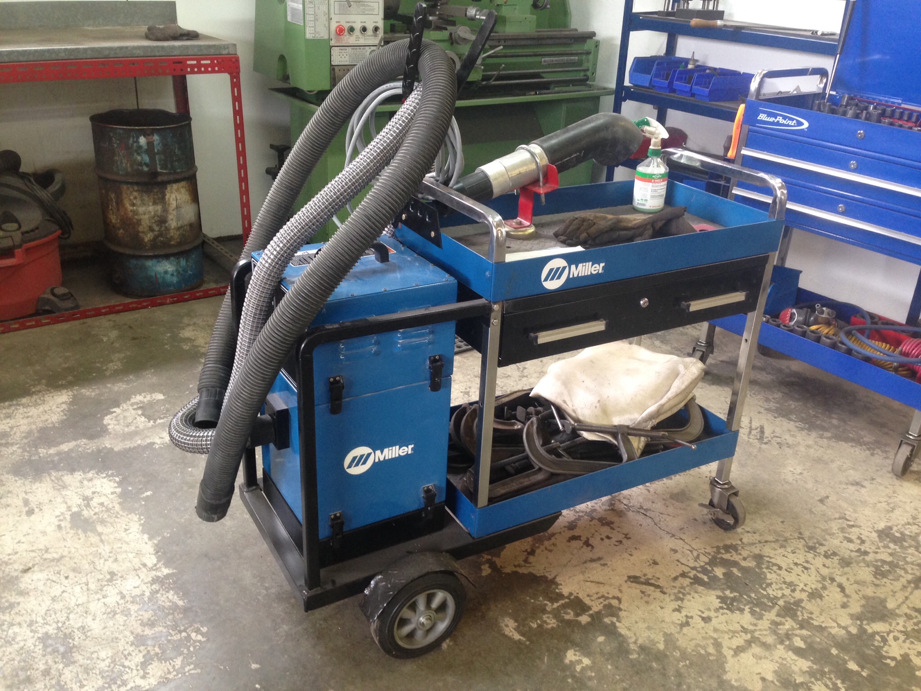

Terry, I like your cutting table. That needs to be my next build. I'll also make it the same height as my welding table so I can use it as an extension if needed. If you've seen the one on youtube from Welding Tips and Tricks I might do something similar so I can attach my fume extractor to it.
/ Welding table build. #45
That's the plan for mine also. Not much left to do. Just cut a hole in the side for my extractor hose. Just haven't gotten round "tuit".
Terry
/ Welding table build. #46
Terry
A little off topic here, but why are fume extractors so expensive? I need to look harder for a used one but they don't seem to pop up often and when they do they command a pretty penny! I'm finding more and more I could really use one to preserve my health a bit. I'm starting to realize my mortality.
#47
They are outrageously expensive. Terry's costs a lot due in part because it recirculates the air and needs HEPA filters, etc. Just the ones with a hose and fan that blow outside are a couple of grand. I hit a lucky strike by finding one that blows outside for $175.00 on Government Surplus Auctions - GovDeals.com

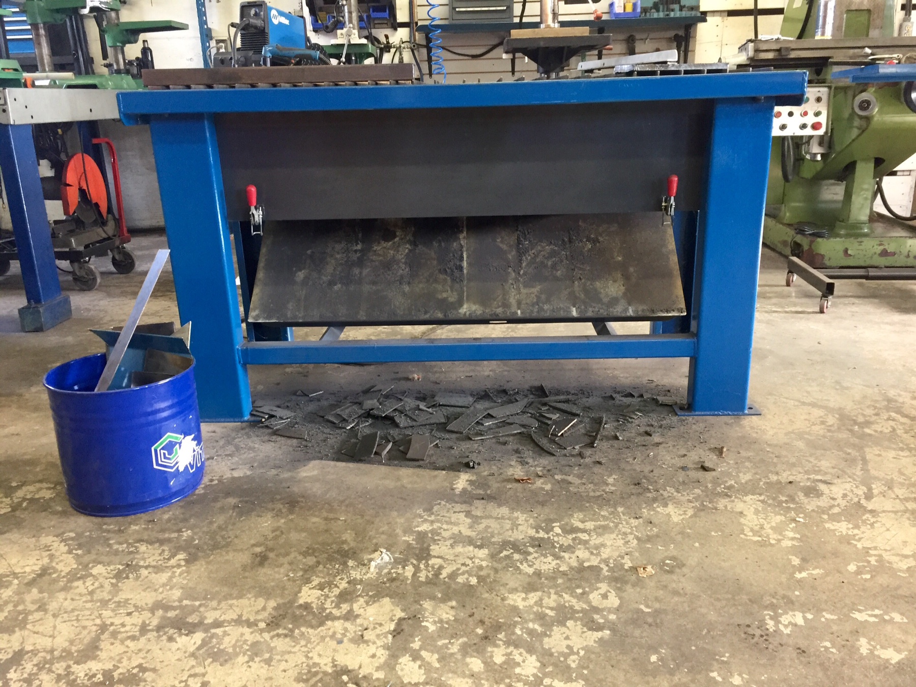

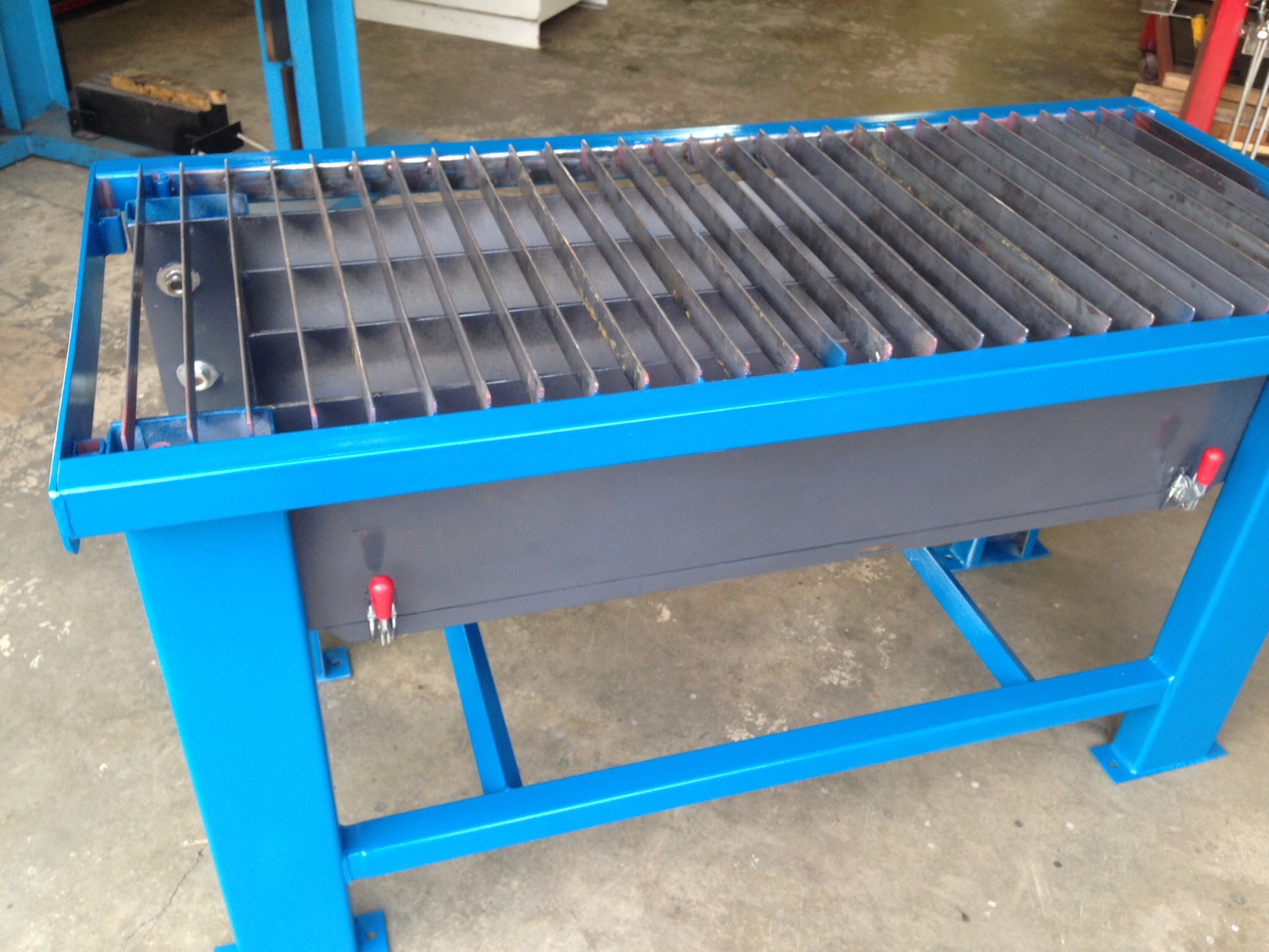

Here's a couple other pics. Not sure who posted them here. They are two ideas I thought ingenious for cutting tables. One catches the mess. One rotates.
Both of those pics are Shield Arc beauties.
Terry
