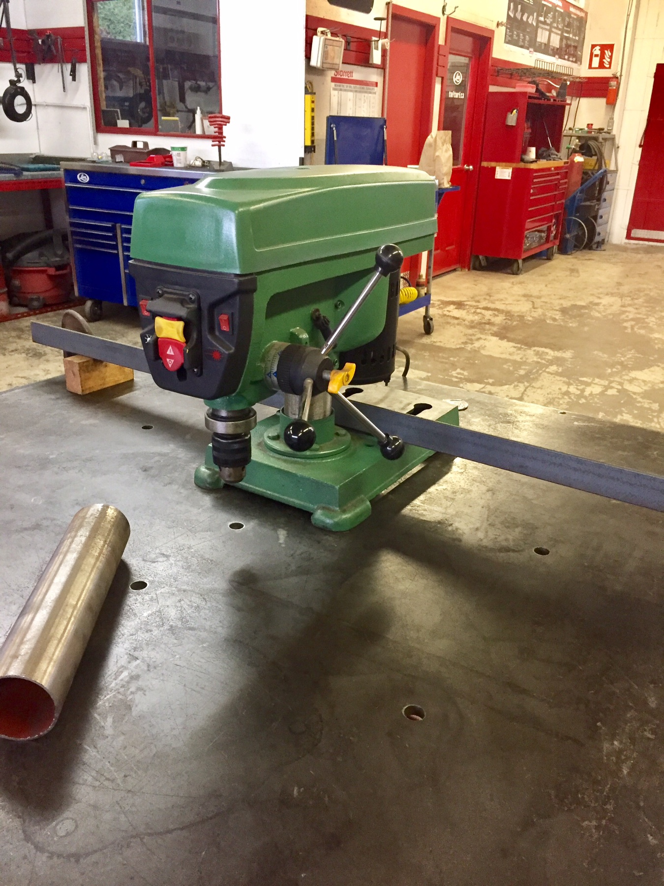

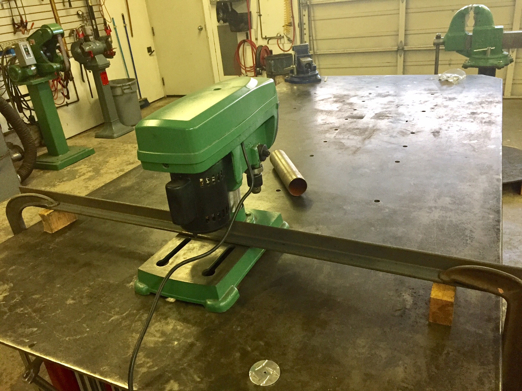

I didn't have a mag drill when I built my table. Here's how a "limited income retired farmer" does it:
--found cheap import drill press at garage sale for $20
--shortened column appropriate amount.
--removed work table and rotated headstock 180ー
--clamped unit to table
View attachment 524386View attachment 524387
FWIW I only have about 30 holes on my 4'x8' table. Seems suitable for MY requirements.
Terry

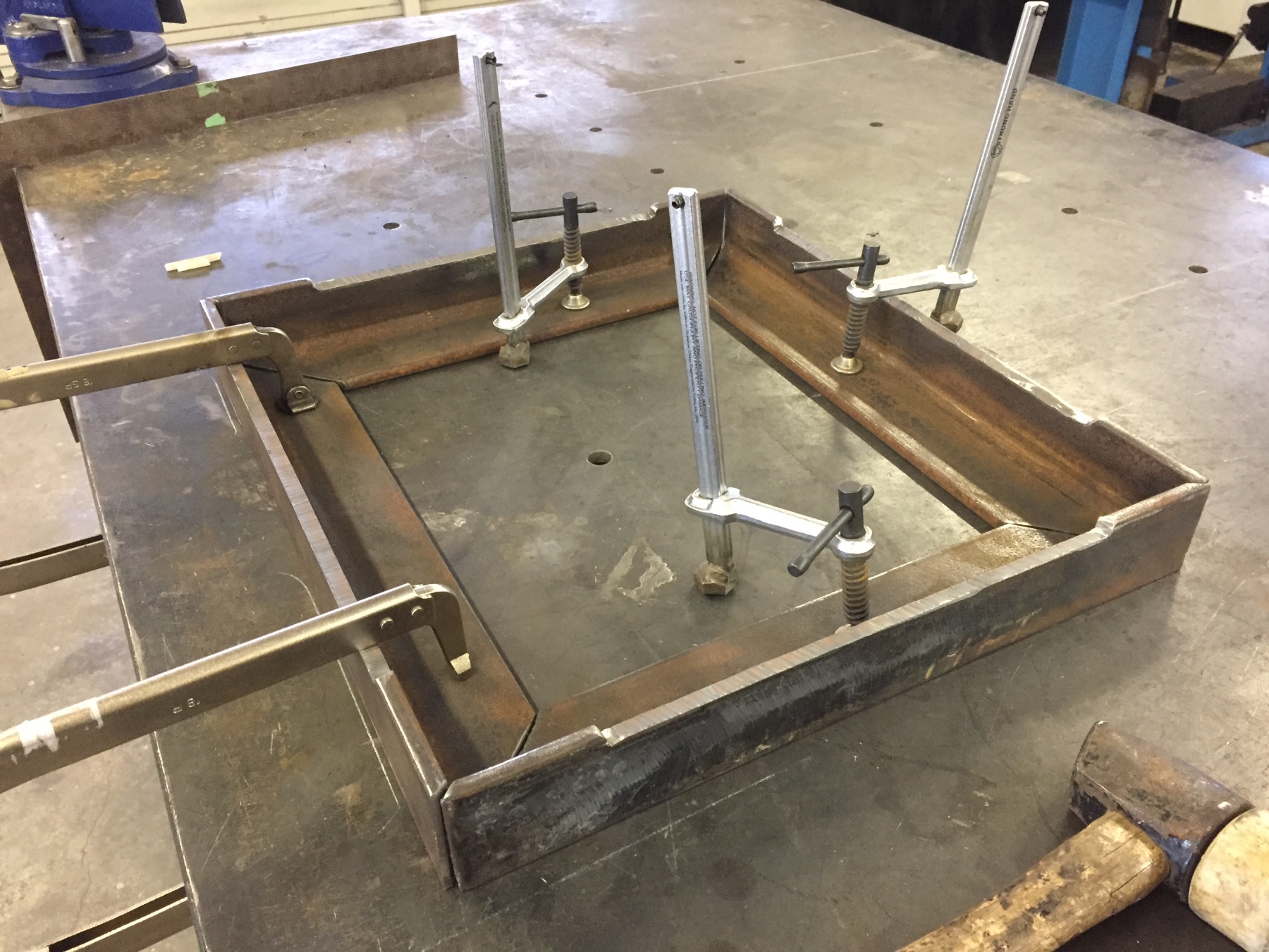

I built a separate burning table. Being as it's the same height as my welding table I can use a pallet jack to place it nearby to be used as an extension for bigger projects.
If I didn't have the space I would have definitely made a folding extension like Richard's.

Terry, I like your cutting table. That needs to be my next build. I'll also make it the same height as my welding table so I can use it as an extension if needed. If you've seen the one on youtube from Welding Tips and Tricks I might do something similar so I can attach my fume extractor to it.

That's the plan for mine also. Not much left to do. Just cut a hole in the side for my extractor hose. Just haven't gotten round "tuit".

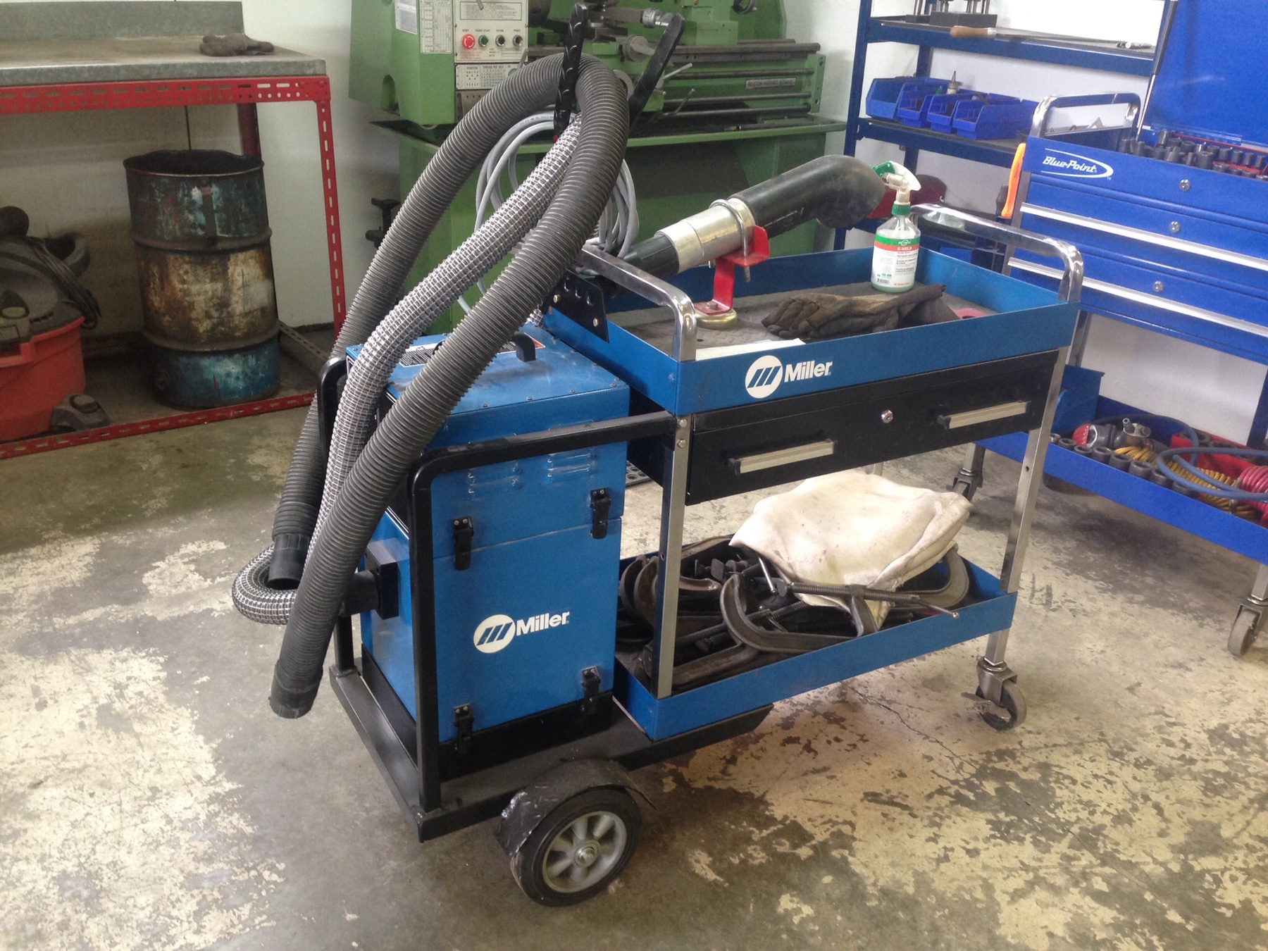

A little off topic here, but why are fume extractors so expensive? I need to look harder for a used one but they don't seem to pop up often and when they do they command a pretty penny! I'm finding more and more I could really use one to preserve my health a bit. I'm starting to realize my mortality.
/ Welding table build.
#47
They are outrageously expensive. Terry's costs a lot due in part because it recirculates the air and needs HEPA filters, etc. Just the ones with a hose and fan that blow outside are a couple of grand. I hit a lucky strike by finding one that blows outside for $175.00 on Government Surplus Auctions - GovDeals.com

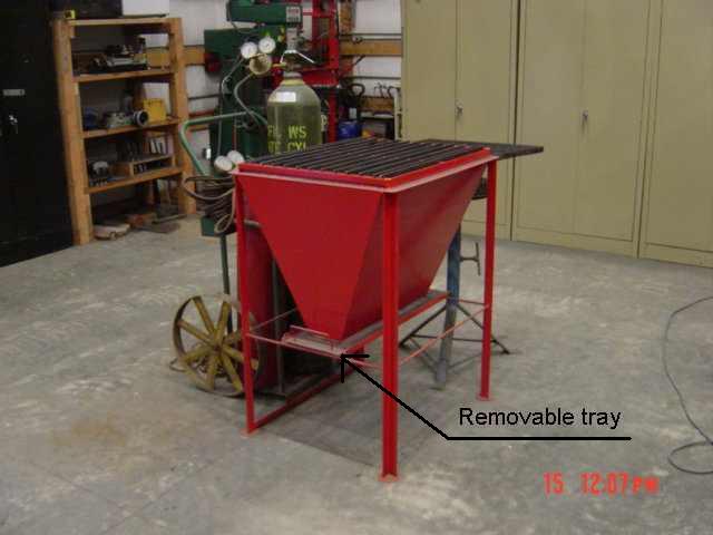

Here's a couple other pics. Not sure who posted them here. They are two ideas I thought ingenious for cutting tables. One catches the mess. One rotates.
Both of those pics are Shield Arc beauties.

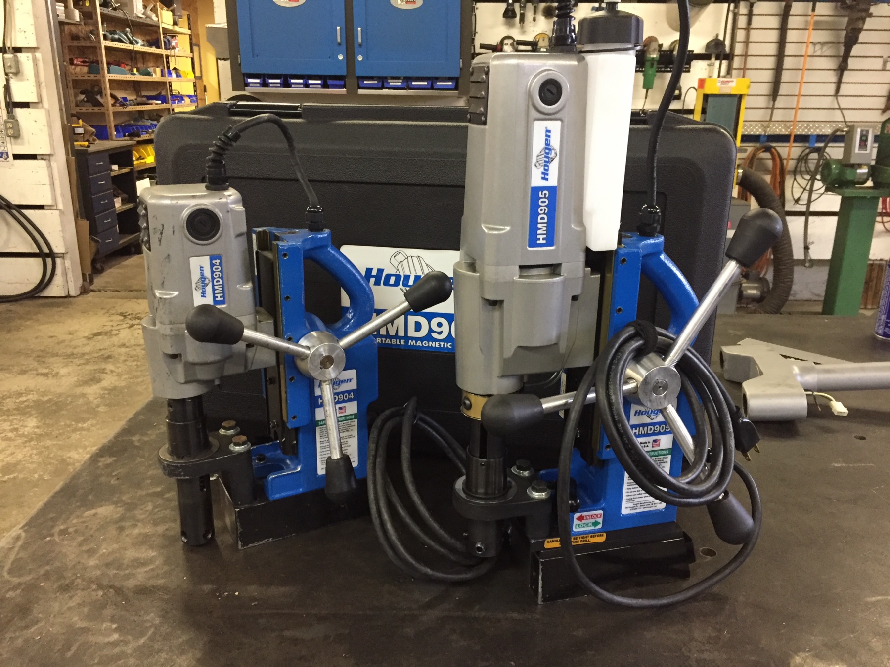

Jeep, I like your table too, glad you like your 917. Did you get your coolant leaks ALL under control? Hope so.
My mag drill's been a "2-edged sword" of sorts - HELPED on several projects, but CAUSED a couple too. Upside of that is added versatility - I can now drill a 1-1/2" hole in a piece of metal that's only 2" square if I want, and can evenly space holes in a row without ever touching a center punch. Spacing is simple since that XY table's lead screw is 10 TPI - just count the turns... SteveDSCN1876.JPGXY-Table-1.jpgXY-Table+Vises.JPGXY-Align-3.jpgXY-Use-1.jpg

Thanks Rusty - between the mag drill itself + the vise table + the XY/dual vise table, I'm surprised I can even FIND anything left to drill holes in :laughing:
Try to drill a "3/4 hole" like this and still have it look like a milling machine job - this let me lock the "floating" lower mounts on my Caroni Flail (an option they should have had from the factory) - plus set up stops so both were identical ...Steve

I REALLY like the 917. The little bottle still leaks, I need to call Hougen if it's not too late. I took a pump up sprayer, put a little ball valve on it and use that for a coolant tank. Don't have to fill that very often. Is your X-Y table from a milling machine or something you came up with otherwise? Using only a tape measure my holes are not perfectly lined up. I'll make some clamps like Big Barn did and it shouldn't matter too much.

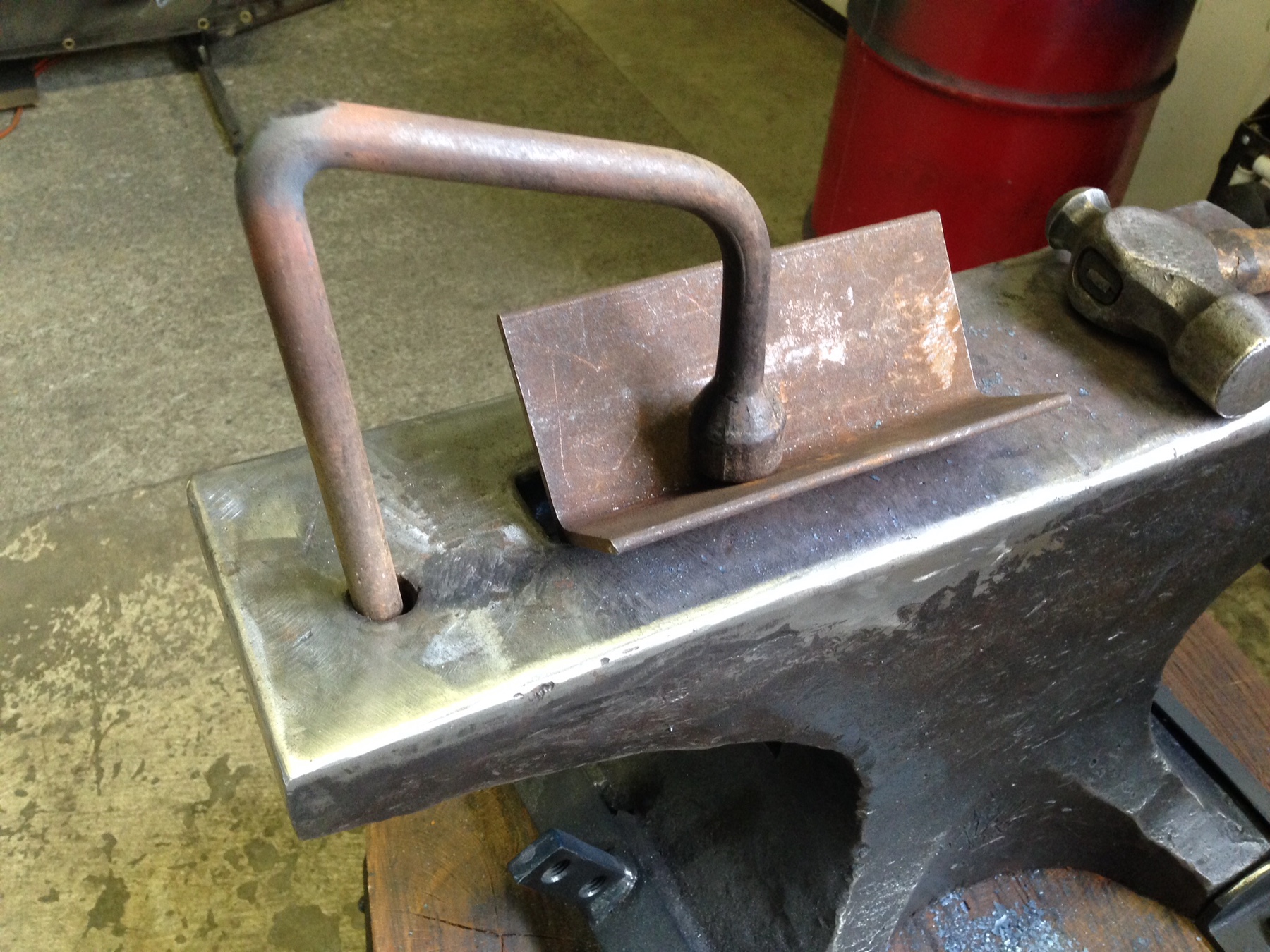

my favorite "hole machine" is my ironworker, but it's reach is also limited.

It has 4 "stations" a punch that you put different dies into for different size holes, iirc this one will punch a 1" hole in 5/8'', a "notcher" sta, and in the pic, a shear and angle shear.
It is the most fun you can have in the shop with your pants on :laughing:. I had been looking for one for 20 years, all around $4k at auctions. Found this on c/l about 12mi from home for $1800 with a bunch of dies and was set up with the (3) phase converter already.
