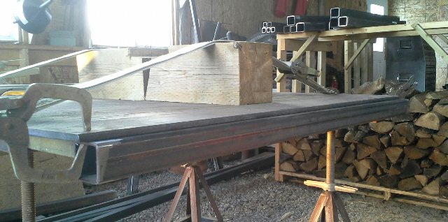

As the only choice I had was to try to pick it up from the end, I had nothing to loose but to give it a shot. Picked it up much easier than I expected. I'll have to calculate the weight but it's less than my racks of firewood that pretty much max out the lift capacity.
/ Welding table build
#82

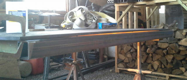

Upright for the first time. A bit of welding to finish up and then on to the cutting area
It turned out MUCH flatter than I had expected. There's a very slight crown to it at the 4' end. Less than 1/16" total and it flattens out by 8" from the end. If I check the 5' direction, its flat as my level so my methods worked to keep it flat after I straightened it. YAY!

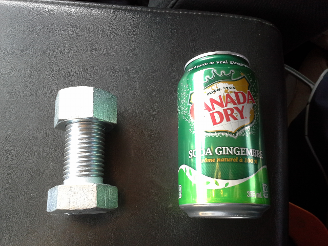

I just totaled things up and am currently sitting at 834 lbs plus the bolts attaching the wheels, the 2 large bolts & nuts for the leveler feet and whatever amount of weld material was added which will put it close to 850 lbs. The cutting slats, by rough count, will add another 80 lbs or so bringing the total to right around 930 lbs before I add the lower shelf (whenever I get around to it). I'm pretty happy with that.
