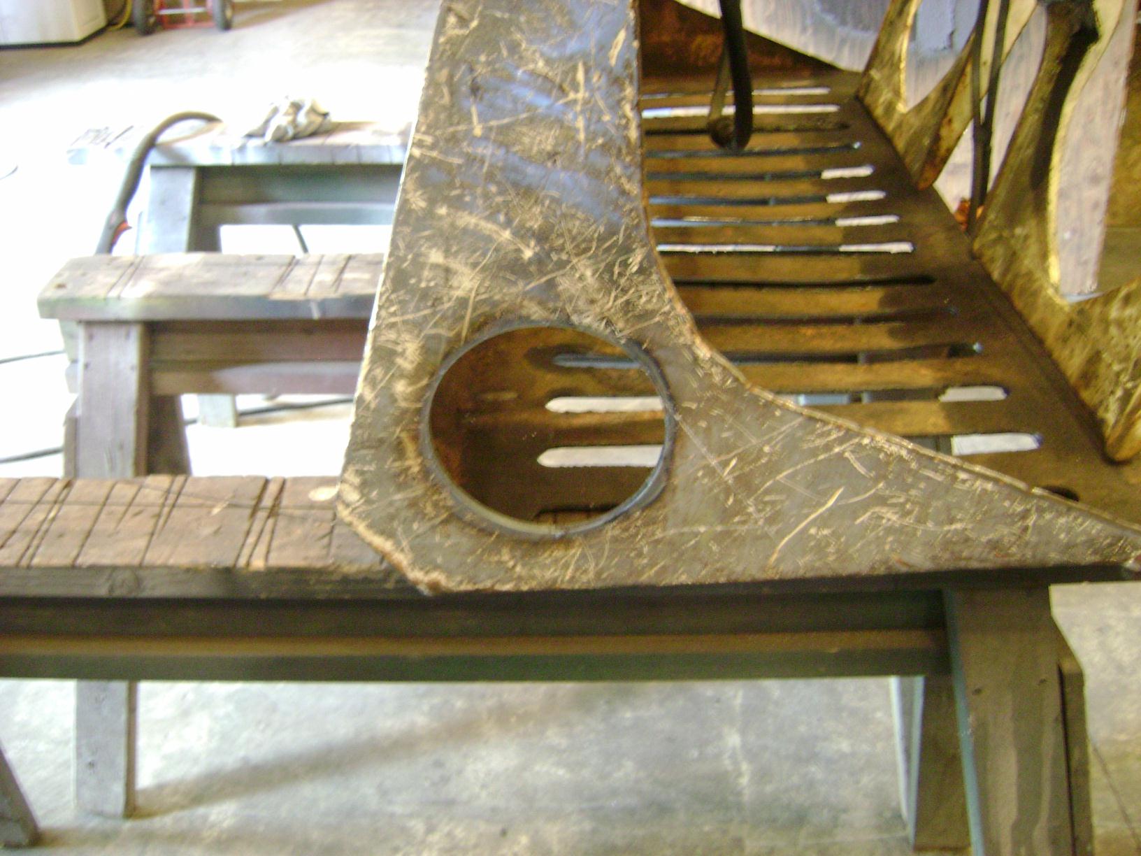

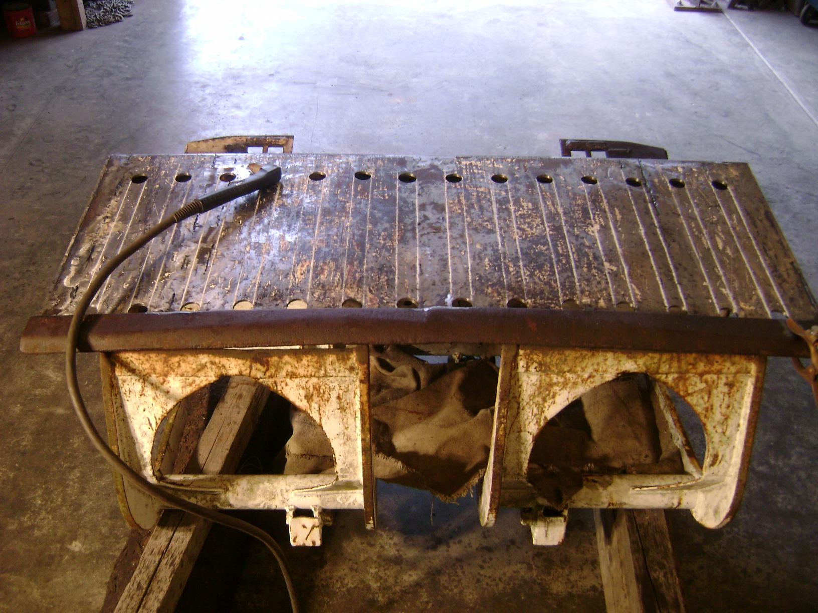

When I bought this grapple, the cutting edge had quite bow in it. After revamping it, and lightening it up I heat shrank the lip. Couldn't get all the bow out. Thought about building a strong back and using a hydraulic jack to remove the rest of the bow. But then thought, Oh I'll just bend it again anyway. :D

I am by far no expert on this. Been watching the last few days and just keeping my keyboard silent. I have had limited success straighting warps. My method varies according to the bow and I cant really tell for the pics how much bow or where its at. My best success is heating thin lines across from where the welds are, If the round bar is welded vertical to the angle. I go straight across to the back side part of the angle and heat a thin red hot line all the way across, then quince with cold water. If that doesnt work, i move over the thickness of the previous red line and heat another line, again quince with cold water. My way of thinking is the welded area is what has drawn the metal on one side of the piece of steel. heat skrinking the back side should pull it back straight.
