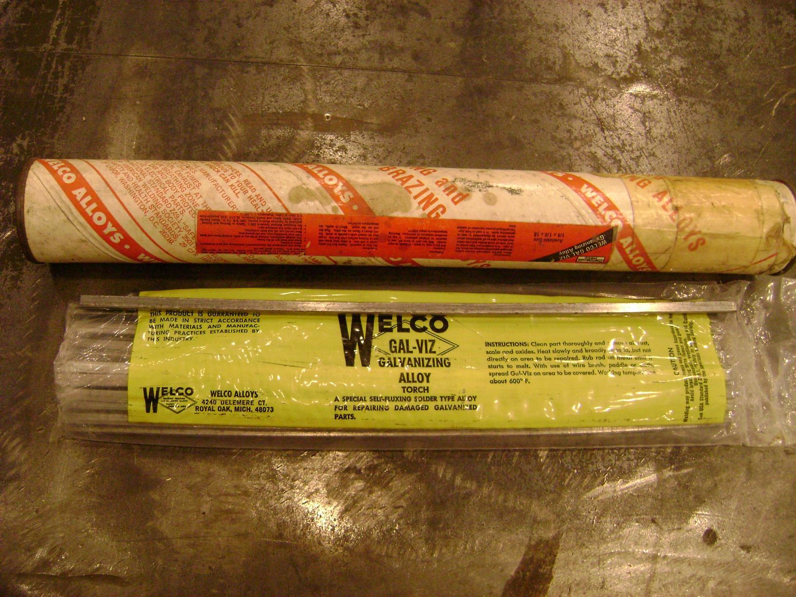

I've welded a lot of sheet metal with Silicon Bronze, but never anything structural.
We used this stuff to cover the burned, and welded areas.
Ah Ha...Gal-Vis. Lol.. Not many people have a handfull of that laying around. :thumbsup: awesome.
