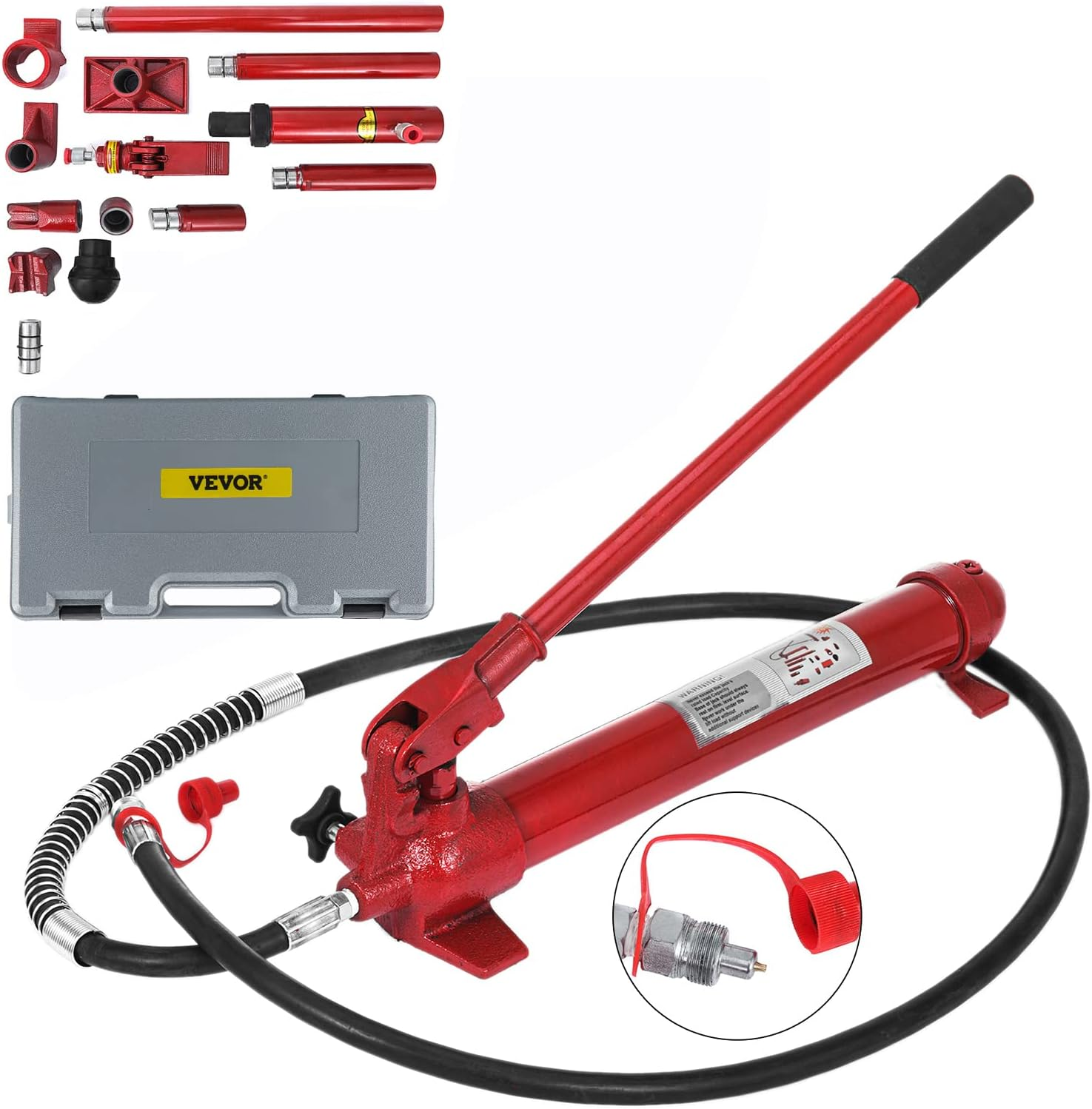

How big / heavy is the boat you want to carry on the trailer and how valuable is it to you? Are you willing to risk it on your repair job? You say you're willing to spend a couple of hundred $$ on the project, wouldn't that money be better spent on a used trailer in better shape or one that is more easily repaired?
That being said, if I were to attempt your repair, I would use a length of chain and a Porta-Power hydraulic ram set like this one to do the straightening:
Auto body shops use them to straighten vehicle frames.
Higher quality professional grade kits are also available at many tool rental yards.
Good luck with your project and keep us posted on your progress!
