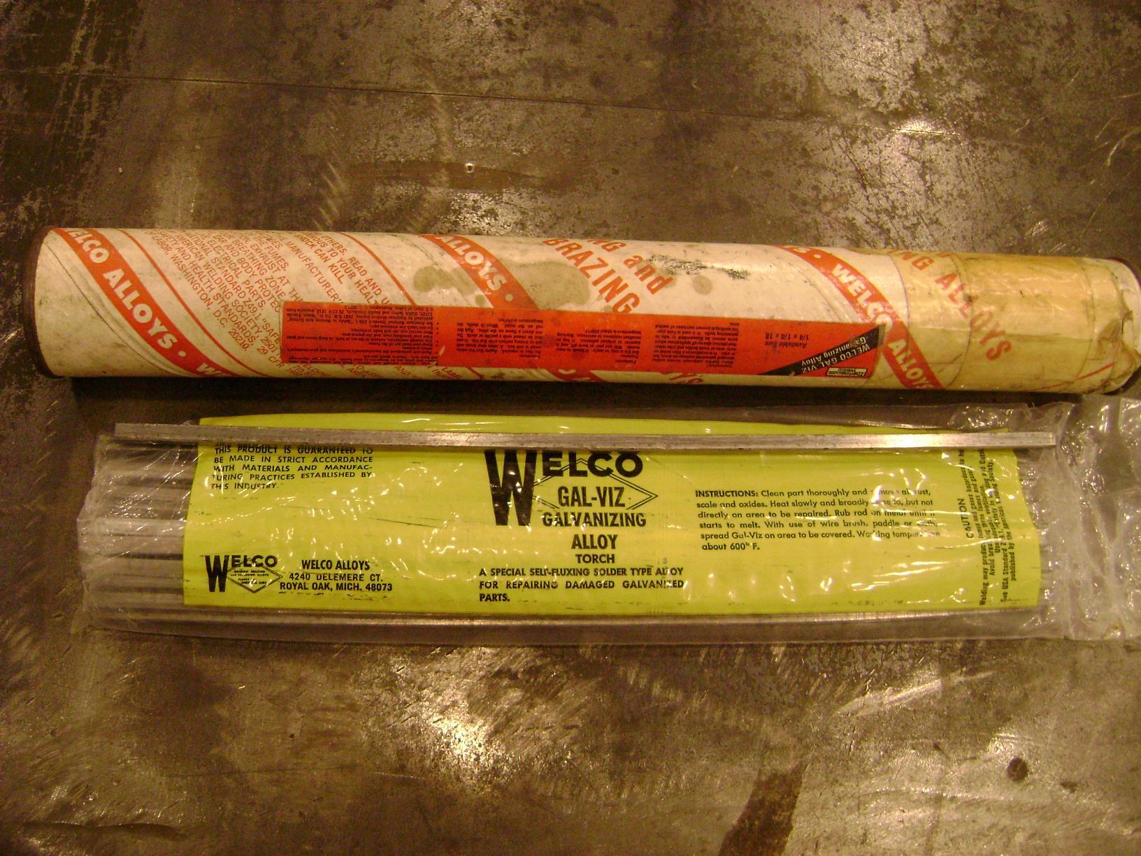

Gasless cored wire works well for Galvanized material but many production plants run Silicon Bronze. Wayyy more money but it is a Spray process that puts down a nice looking bead. Gasless cored wire like Lincoln NR211 work good but tons of spatter and even more smoke. We used to sell Silicon Bronze for the weld and while the bead was still hot you would go over it with a rub on Galvanizing Stick. Called Gal-Vis from Harris Welco. Weld and Galvanize in 2 quick applications. Gal-Vis is great for my Galvanized Boat trailer too. Fixes Rock Chips.

/ Welding galvanized #14
I've welded a lot of sheet metal with Silicon Bronze, but never anything structural.
We used this stuff to cover the burned, and welded areas.

/ Welding galvanized #16
Ah Ha...Gal-Vis. Lol.. Not many people have a handfull of that laying around. :thumbsup: awesome.
