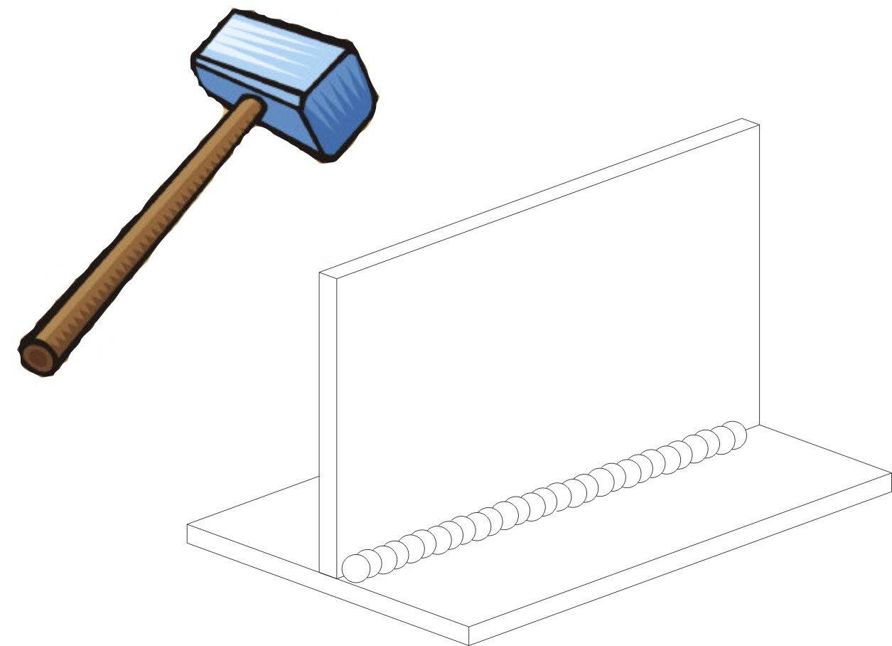

About how much of each piece of metal should be penetrated at the weld? 10%, 25%, 50%? My last attempt was to weld the smaller piece on both sides while it was perpendicular to the larger piece, and it took several good solid whacks with a hammer to break the smaller piece loose. Should the weld be so strong it takes a grinder to break the weld?
/ Welding advice, please #4
A good way to check penetration of a weld. Make a fillet weld on two plates, then beat on the upper plate, and force it over the weld.
That's how I was checking for penetration - in fact, your diagram is exactly how I was welding the two pieces of steel. Hammering on the vertical piece usually didn't do anything (no gradual bending over) until the piece broke loose. The welds weren't quite that neat, though :D

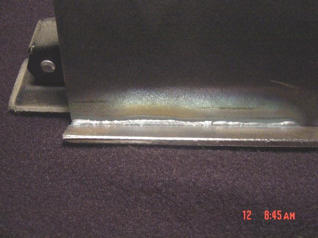

Here's the only picture I could find of penetration. I made this weld with Tig.
Remember joint prep plays a big part in the amount of penetration you'll get.

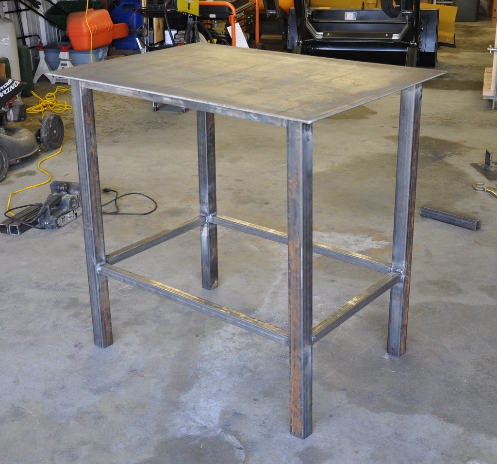

An update after a weekend of practice. I spent most of the day Friday welding a vertical piece of steel to a horizontal piece (much like I was doing before), trying different amperage and WF settings. Finally I hit on a combination of settings where the edges on both pieces were subsumed in a satisfactory manner into the weld along with the flux core wire. The results aren't pretty - I still get a lot of spatter - but the welds are strong enough that hitting the vertical piece with a 4-lb sledgehammer doesn't do anything.
By the time I finished, my back and legs were so sore from welding on the concrete floor, I had trouble getting up and walking around :p So I decided to try my hand at welding up a work table the next day.
Saturday morning, bright and early, I went back to the shop and started. First, I flipped the 28" x 40" x 3/16" sheet of steel upside down, and welded a section of 3/16" angle iron along the front and back edges, 2" in from each edge. I used a newly-purchased angle grinder to clean the surfaces being welded, and that really helped compared to wire brushing. After hitting the two pieces of angle iron with the sledgehammer and getting nowhere, I started with the legs, which were made out of 2" square steel tubing, also 3/16" thick. I used long pipe clamps to clamp each leg to the table top, and welded them to the top and to the ends of the angle iron. Then I cut pieces of 1" square steel tube, also 3/16" thick, and clamped them in between each pair of legs (front-back and side-side) and welded them in place, 1' off the ground.
I did most of the work Saturday morning, but I quit around noon with the temps rising over 80 outside. Wearing a t-shirt, a long-sleeved shirt, a leather apron, a helmet, and thick leather gloves... not very pleasant when it gets warm out, even with a 42" shop fan blowing fresh air through the open door. Kudos to you professionals who weld outside for a living at the height of the summer! :thumbsup:
Sunday I went back to work, and finished up all the welding. Then I righted the table...... hey, not too shabby, if I may say so ;) I'll probably find some sheet steel to weld to the bottom of the cross-braces to create a lower shelf with a raised lip (the braces) to keep stuff from rolling off the shelf.
If anyone is interested, I'll post pics. Really, just a basic table - no fancy scroll work or flying buttresses or any such :D

You might consider welding and angle to one side that will provide a place to put a pipe in that will not roll off. It is also nice to put a chain vice on one end of the angle to hold round or irregular shapes in place.

Thanks for the compliments and the tips! It's a work in progress - I like the idea of a "stop" to keep round stock from rolling off the table, and I also plan to weld a bolt to the underside of the lip at both ends of the table. Then I can use either bolt for the ground clamp.
I admit, I had to google "chain vise" but that looks like it'd be handy for clamping down round stock. Thanks for mentioning yet another gadget to buy :p

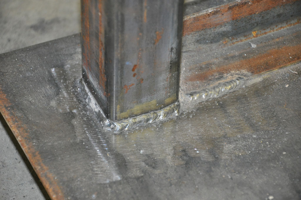

Thanks, but if you saw the table up close, you'd see why I consider it a "decent" first attempt. Two of the legs aren't exactly square to the top, so if you look closely, you can see the legs aren't all parallel :ashamed: I tried hammering the worst back into line, but the welds weren't giving up anything! How do you folks position - and hold - a table leg so it's perpendicular to the top in both axes, before welding it in place?
Here's a shot of the best welds on this table. Trust me, the other welds aren't as neat-looking :D I did notice a lot of splatter up to 2-3" away from each weld, plus a lot of tan-colored "soot" (for lack of a better word). The splatter can only be scraped or ground off, but the "soot" comes off with a paper towel. From what I've read, a certain amount of splatter is to be expected with flux core welding, but is there a way to minimize the splatter? I tried different wire feed speeds, holding the gun at different angles and distances from the work, fast/slow welding, etc. But nothing seemed to help reduce the splatter. Also, what's with the "soot" ? Is that normal?
