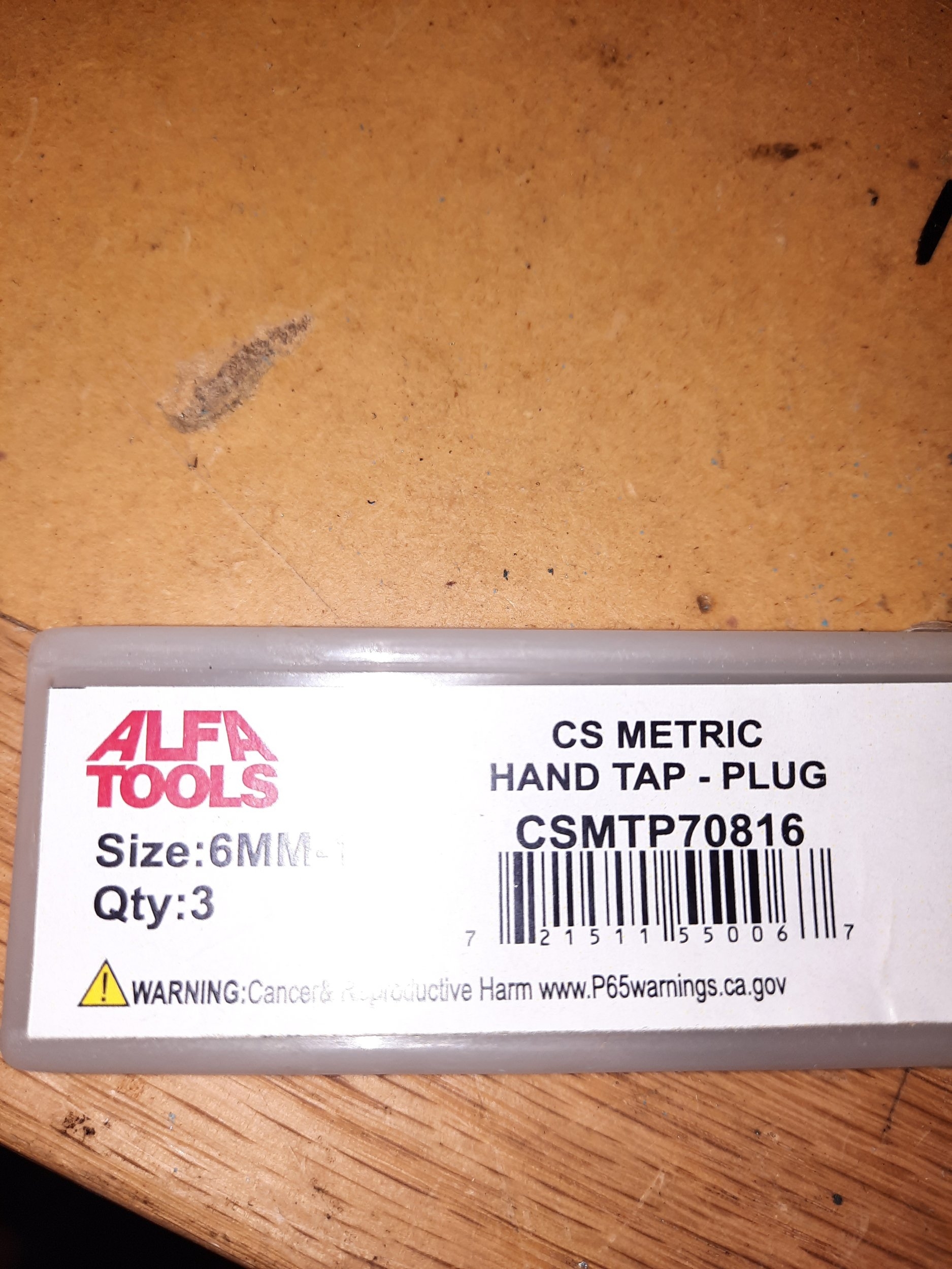

Not sure how I "boogered" up the threads on my tip holder on my Titanium 125 but I cleaned it up with a 6mm tap. The industrial supply did not have a bottom tap just the starter tap so I used it until it bottomed out then cut it off to finish cleaning the threads. I'll just pick up another starter tap should I mess it up again if they have it in stock. This was the last one that they had.
