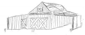

We started the shed\barn today. It is only going to be 29x20 so it is not huge. I would love to have the ability to take what I think I need, add 30% then double it but that is not in the cards right now. This will be the hay loft, tractor roof, feed storage with a stall for a cow in the future.
I had fun trying to level the place. My property is sloped where ever I go so I used the tiller to loosen the soil then scooped and pulled it around. Im proud of it but I know it could have been done a lot better.
Started setting the 6x6 posts. It started raining on post 4 so I had to call it for the night. They are 3' deep and our frost line is 2'. With drainage issues with my clay I add some rock to the bottom foot then just back fill with soil.
More to come as I get time.

I've been dodging rain this last week whenever I have time to work. So it has been after dark when I quit so sorry for no photo updates till now.
I got all the 6 main poles dug and sunk. The hayloft is up. Hopefully tonight I can get the decking on it. Then on to "trusses". I've got 2x6x8 for the trusses I just have to figure out my angles on the first one then make a jig.

Well the wife and I have been busy. Got the floor up and then started on trusses. After figuring out the proper way to tie the trusses to the decking things started going surprisingly quick. It was also surprising how quick it went from shaky to a mostly solid frame. Next up is the side sheds. We will see if those come tomorrow or next week.
What is everyone favorite siding? I'm wavering between t11, metal, or maybe vertical boards.

Here it is with most of the tin on it. The ridge cap has not come in yet but otherwise its on to framing out and siding on.:dance1:
