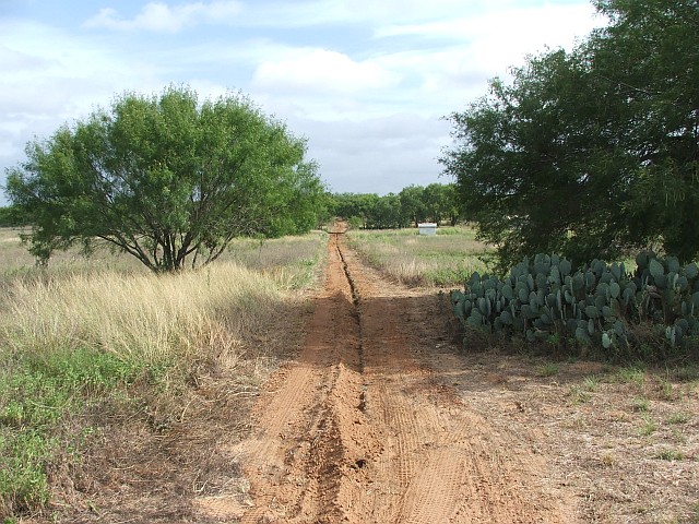

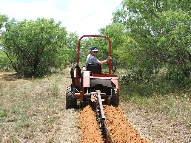

   / Water line from well to cabin #6
I don't know what your frost line is but I would put it at least 18" deep. That will keep it under the gophers. We have a lot of gophers down here so I went with 2" PVC and buried it 24" even though our frost line is like 0.5". They generally won't try to eat through a larger pipe. By the way, my run is over 800'. P1=P2. Where you start loosing is rise and angles.
