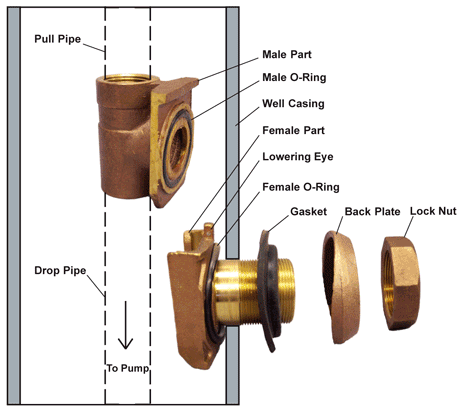

The pitless adapter only very slightly protrudes into the well casing once you lift the black poly pipe out of it. The wires will have a wire nut right at the well cap so you can disconnect the circuit at the poly pipe when you begin.

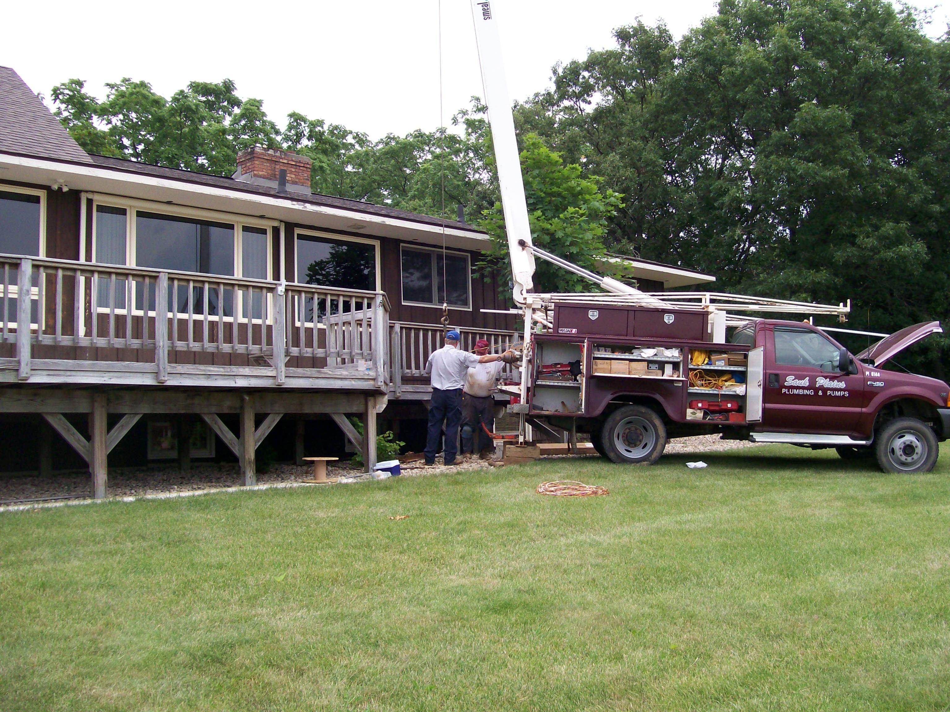

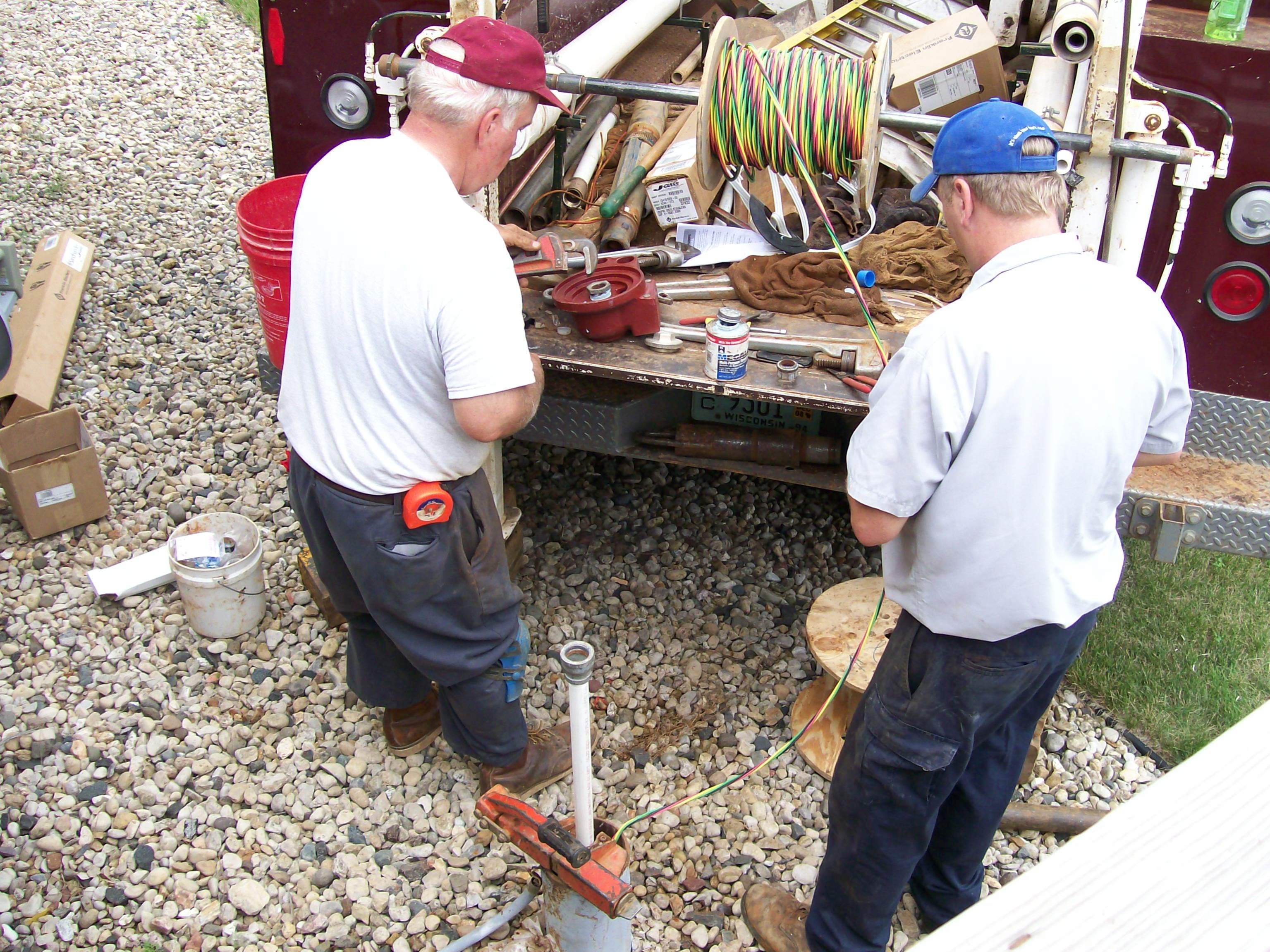

Had to pull my pump last summer. It hung on the galvanized pipe, and put it back with 20+' sections of special plastic well pipe with threaded male/female fittings on ends. Pump sits about 275' in a 320' well.
Here is shot of rig for pulling, and one of putting the plastic back down. Shows the clamp for holding the plastic pipe. Getting ready to put the well head on. I don't have the pitless setup, but instead what they call a Morrison head.

The real height consideration is the tool that you use to remove the pipe from the pitless adapter. Some of these adapters are 5' below grade so you need a 6' long metal tool to pluck it out of the well. As you raise the tool you will need clearance to lift the tool straight up for the 6 or so feet above your casing. Our pitless adapters are only 2-3 feet below grade (freeze depth) so it's not that big of a deal.
