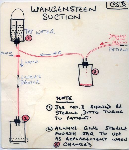

You don't want to buy a vacum pump you can make 1 of dese Wangensteins out of a couple oil jugs and pull water off bottom of tank real easy. Just cross out patient and write tank.
Get tube all de way to bottom and let her rip.
Don't loose more den an ounce of fuel once you get figured out.
