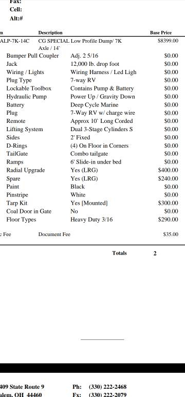

Just talked to the fellow and already got the quote. Missing on the quote is the de-rate the 15,000 gross build to 9,995 and also missing is the rear drop legs for loading equipment. There is also a 3% cash discount, so assume around $300 off for cash. View attachment 696440View attachment 696438View attachment 696439
I never payed attention to the literature of them when I was shopping for a dump.....but I gotta wonder what the point of 3-stage cylinders are on a dual ram setup where everyone else just uses single stage cylinders?
HAve you given suretrac a look. Im happy with mine. But that seems pretty pricy for an "appalachian".
I know upgrades cost $$$. But my 7x12 12k was $6400OTD about 3-4 years ago. I know they make a 7x14 16k with scissor lift. Not sure what they cost though

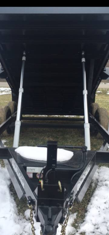

Okay... this is the Appalachian Special. It's $1,100 more than the top line contactor model.
This Appalachian Special gets 3" drop axles, 3 stage 3" cylinders that are front mounted and yet give greater than 45° dump angle.
The standard Appalachian gets the mid mounted cylinders that reach back towards the pivot point. This is a front mounted that reaches about 1/4 way back from the front. That gives this massive mechanical advantage over the standard setup.
In these photos you'll see the red painted cylinders that are all of the standard Appalachian dump designs, then you'll see the silver painted showing the Appalachian Special with its commercial style design.... similar to semi dumps. View attachment 696451
Just for comparison purposes....
2021 PJ Trailers 14K Low-Profile Dump PRO (DL) 14' D140 | Fayette Trailers LLC
2021 Load Trail DT14 83" x 14' dump (14K) - 24" Sides LTD140 | Fayette Trailers LLC

Not sure why the red cylinder set up didn't come... but this is the non Appalachian Special set up.
