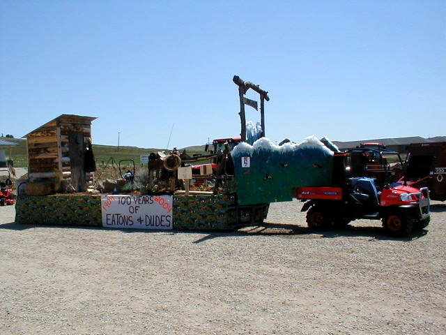

We built a frame with a ball that just fit inside the bed. Towed a 24ft deck over gooseneck trailer with our parade float on it to the tune of about 6000lbs. Stopping quickly would not be a good plan, but it pulled it fine-the full parade route and probably a couple miles back to the dealership. THe frame just sat in the bed and the wieght of the trailer held it down. Not the best pic, I'll see if I have any others.

Thanks, cnoel thats exactly what I had in mind. I look forward to seeing anymore pictures you have.
/ RTV Trailer Towing #18
Ya thats a good idead, just make a frame the mounts int he bed and can be removed with pins or something, as long as the trailers got tongue weight it will be fine but If it were me I'd just cut a hole or slot in the tilt bed and make a crossmember and then have the ball come through the tilt bed. Have the part you cut out for the ball, be hinged there and have the gn ball removable, so you could pull a pin..take the gn ball out and then the hinged little cover would cover the hole from the ball.
