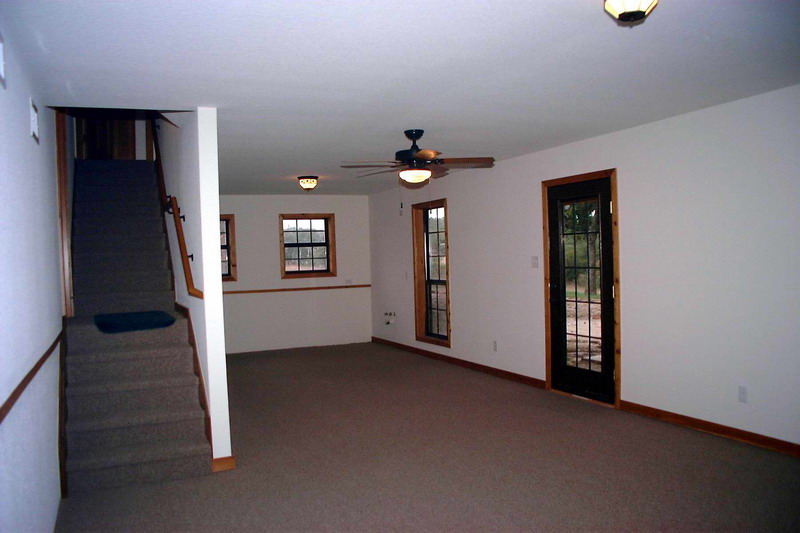

Well, the weather finally got me. Last night I went to check our walkout basement rec room before going to bed. The lights were off when I stepped off the last step in the stairwell and my foot was suddenly immersed in 3" of water. AARGH! :eek: :(
The walkout has 3 walls that are concrete up to 36" with the front wall and stairwell being the only framed and sheetrocked walls. There's a 4" cedar molding around the framed walls and the carpet is a commercial carpet with no padding. It's just glued to the concrete floor. A hot water stub-out I had installed for a wet bar froze in the wall and burst. The flow was so fast it couldn't run out the door and that's why water was 3" deep. I opened the door from outside and water poured out like you see in cartoons. :shocked:
We dewatered the floor down to the wet carpet and we will use a wet-dry vac this morning to get as much water out as possible. Of course it's the weekend and bad roads to boot, so there is not telling when we can get professional help. Unlike the photo I posted, the room is full of furniture with theater seats, a bar, pool table big screen TV and many other goodies that have wet feet. The TV and electronics were plugged into a power strip that was plugged into a ground fault plug. The ground fault popped when the strip got water into it and shut everything down. I think we are good electrically/electronically, but this is still going to be a huge mess.
I've been in the house now about 10 years with nothing major, so I guess it was my turn. It doesn't make it any easier though when it happens. At least it was on the lower level and the room that will see the least damage. Still, I was looking forward to a Super Bowl party with my daughter and grandkids tomorrow. That ain't gonna happen. :thumbdown:

Thanks Western for the offer and everyone for the good wishes and advice. I thought the problem was only hot water until I turned the cold water on this morning and more water came flooding out of the wall. I shut the water off and determined it is an outside spigot pipe that busted. I had those foam covers on all my spigots, but when I opened up the wall, I found the pipe had that black foam insulation around it and the fiberglass insulation had been put to the inside, leaving the pipe between the insulation and the outside wall. I just don't think that is right. There was plenty of room to put the insulation between the pipe and the outside wall, but the installers just didn't bother. The pipe split about 3" long at an "L" and about 2" back down the pipe. Both the "L" and the pipe were busted. I cut the pipe back and installed a cap. I'm waiting for the glue to set up good and then we'll give it a pressure test.
We contacted our insurance company this morning. Of course they are swamped with claims. They said they use Servpro most often and gave us their number. I called a local restoration company because Servpro has to come from about 45-65 miles away. The local company told me they could get here to dewater the rug for me, but would have no drying equipment available until Monday because of the demand. I called Servpro and talked to someone who said they would call me back, but they have not returned my call. If they don't call within another hour, I'm going back to the local company and let them do the job. I know that Servpro has a bad reputation in some places, but every location is probably different. However, if they want my business, they need to call me back and tell me when they can be here. I'd rather support the local company anyway.

Thanks everyone. I quit waiting on Servpro and called a local company. They were here in just over 1 hour and dewatering the carpet. I was really impressed with how well their machine worked. We still have to do some checking of the walls, but the glued down carpet is almost completely dry. They left drying fans running to do the final drying. The carpet seems to be no more wet than after a good cleaning. We will see how it goes on odor. If it doesn't seem to be okay, we'll get the carpet replaced.
All the furniture is up on blocks and the carpet is only slightly damp to the touch. I was truly impressed with how professional this crew of two guys was and how they worked well together. I'm glad to keep my business local. When/if Servpro ever calls me back, I'll tell them to cancel the order.
My capped pipe is holding fine and we have both hot and cold water as normal. From this, I think I learned that I'd like to have some additional cutoffs so I can isolate zones in my house. I have three main zones. Right now I can only turn off hot water and the main supply at the outlet of my pressure tank. I need more cutoffs. That's a project in my future.:thumbsup:
