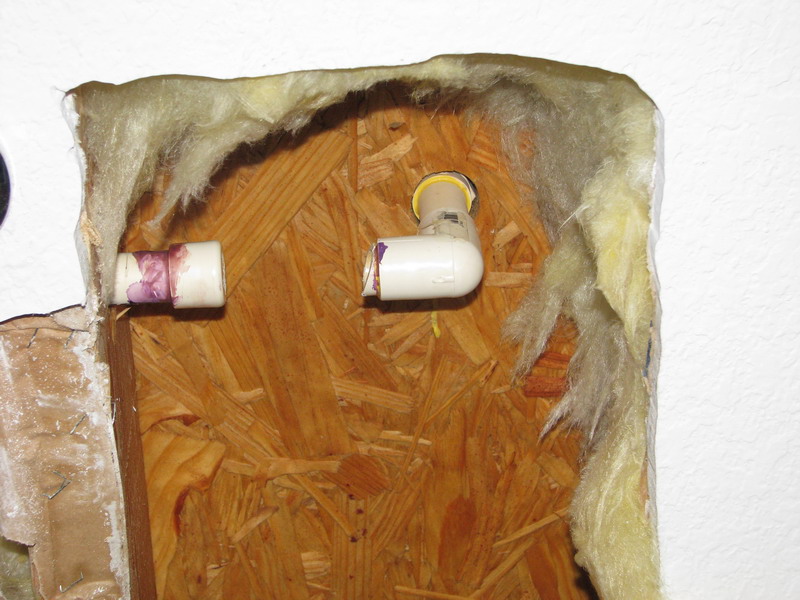

James, we disconnect hoses and put on the foam covers (Dollie Partons ;)). Evidently, that is still not enough. I think putting pipes behind insulation on the outside is probably the stupidest thing I can think of. Since my water lines to my kitchen and to the outside wall comes through the ceiling, I think I would be well-served to put an access in the ceiling of my basement where I could turn off the supply during really cold nights. I can normally count the number of times the temperature gets into the teens here on one hand in one season. If it stays above 20 degrees, there has never been the slightest problem. If I know a severe cold spell is coming, I could open the access panel in my ceiling and cut off the water supply and allow me to drain the outside wall pipes. I've attached a picture of the water supply going across the ceiling during construction of my house. A panel with a nice cover in my basement rec room wouldn't be a problem and would take away the future danger. In the photo you can see where the pipes going down the wall are wrapped in foam, but when the insulation was installed the pipes were covered on the inside. I don't know why I didn't notice. Hindsight is 20-20.:rolleyes:

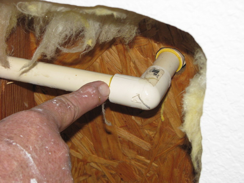

Here are some photos. The first few show the soggy insulation and the pipe with the foam around it where it goes out to the outside spigot. The closeup is a picture of the actual crack in the pipe. Next is with the pipe capped. My CPVC glue was starting to be a little thick, so I thinned it a tiny bit with some purple cleaner. It seemed to work, but it's very non-standard for CPVC.:eek:

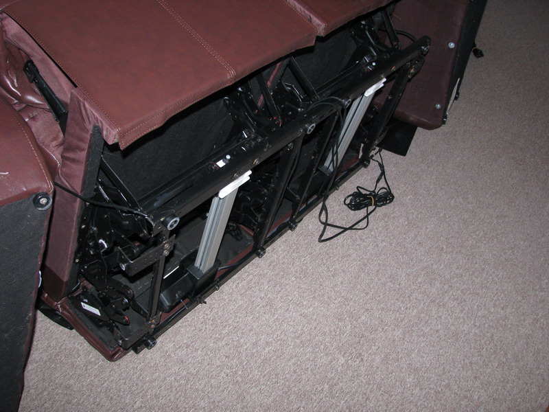

We have four theater seats in our rec room in front of the TV. They all are electric and the power supplies lay right on the floor. Guess what was completely immersed in water? Yep! I plugged them in and none of them have any output DC voltage. I opened one up and it is a mess inside from where an electrolytic capacitor exploded; not pretty (see last picture). I hooked a 12 volt battery directly to the chairs and all the motors work off the battery, so I don't think any of the motors got water into them. They are right at the level of the water and I don't think it was high enough so that the shaft/bearing/seal was compromised. I have the chairs leaned over so air can dry under them better and I can easily inspect for damage.
Hopefully you can just replace the power supplies for a decient price and be good again. At least as far as the chairs are concerned.
Even if I can't find exact replacements, they are 24 vdc 1.5 amp power supplies. I shouldn't have too hard a time finding a suitable replacement. My guess is many manufacturers use the same power supplies and mechanisms.
