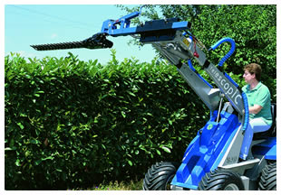

I'm starting to think about collecting materials for a "trimmer", in anticipation of purchasing a Power-Trac in the future. This use is one of the main reasons for wanting the machine. I'm going to watch for old tractor sickle mowers, both to try to see how to adapt one to a hydraulic motor, and to start collecting parts. I'm also going to watch the hydraulic surplus places for a high speed hydraulic motor to use with 12" wood saw blade. The sickle bar setup for brush and light stuff, and the saw for branches. They could be interchangable on a common boom setup. I have the distinct advantage of having a good friend who runs a good sized machine/metal fab shop /forums/images/graemlins/smile.gif Half the fun of these projects is the planning, scavaging, and anticipation of the finished project.

/ Vertical Brush Cutter? #11

Dave: I have not yet bought the PT but will be when funds build up. I was thinking about a trimmer like you are. I have a sickle bar mower off my Ford9N. It was drivern off the PTO and was positioned under the belly of the ford. I was allready thinking about how to make it work with a aux hydi motor and a quick attatch plate to mow the road banks on my mini-farm. I will be watching how you figure this out. Good Luck! Bob /forums/images/graemlins/smile.gif
