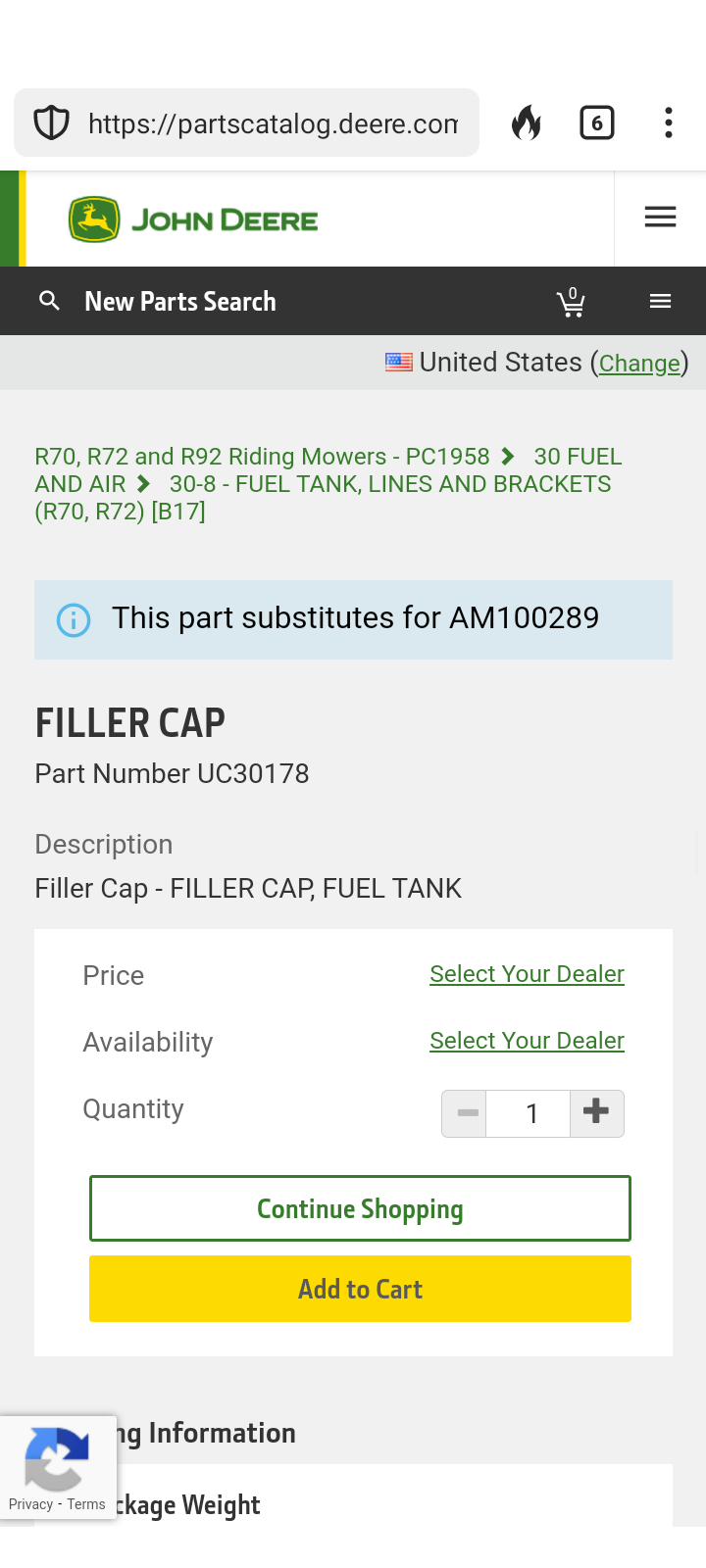

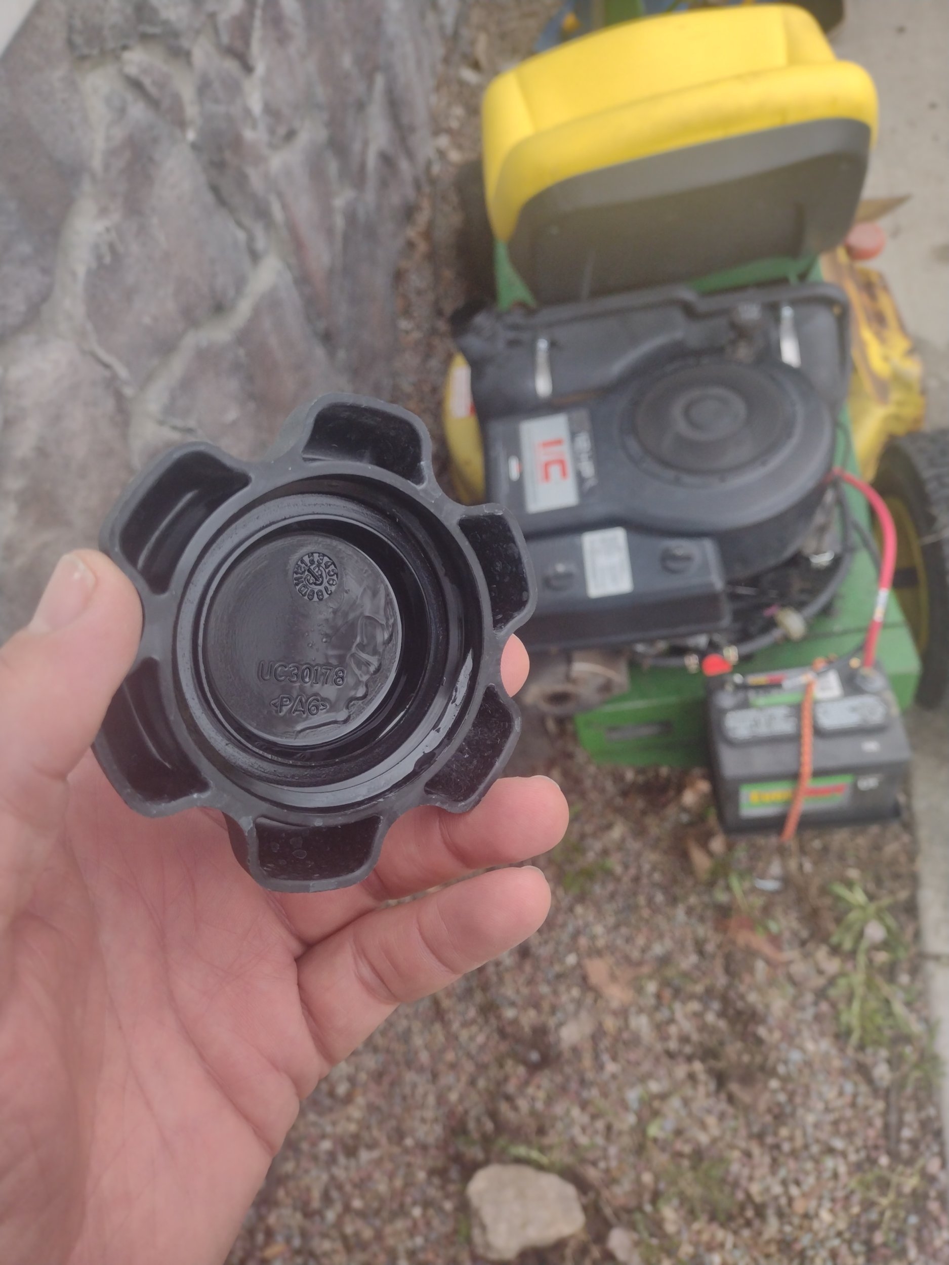

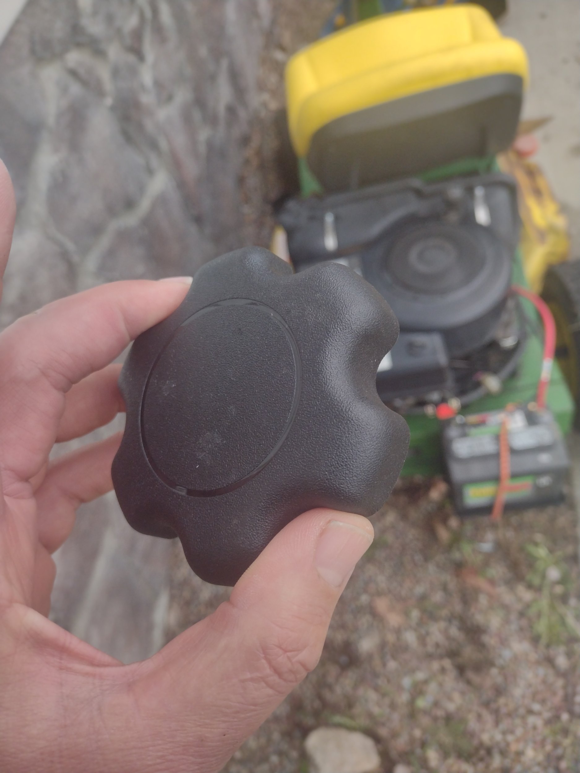

Have a Deere R70/R72 riding mower I recently refurbished. Has a gravity feed tank feeding a now 12hp single cylinder B&S.
Original gas cap was vented and in bad shape. I ordered a replacement part from Deere and got the part that superceded the original which fits but is not vented.
Didn't think much of it until I tried to troubleshoot why it would run great for 30 seconds to a minute then die. Runs great with the cap off but of course that's not a fix.
Thought about just drilling an 1/8" hole in the cap, or drilling a hole and epoxying in a hose nipple attached to some vacuum line.
Anyone have any better ideas?

Could just buy the vented cap too. Part # AM100289

I had tried to order that part number and got the non vented substitute

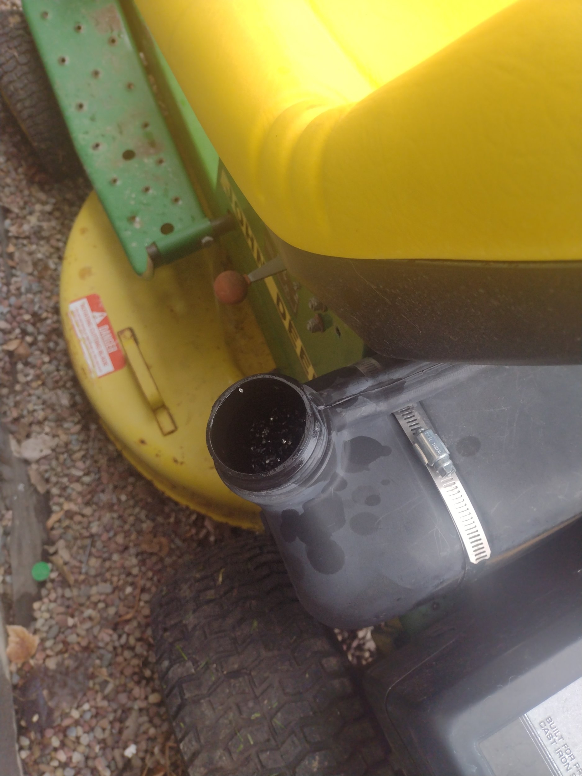

I'm trying to understand how this works? The only way I can see that air can get into the tank is through a hole in the top round center of the cap -anything on the sides is blocked by the filler spout.
I can see this would work if the top was double walled with an air space in between, but unfortunately this cap has just a single layer of plastic

Is there another part that goes into the underside of that cap that makes it vent-able?
I'm afraid what you see in the pics are it

I'm not affiliated with the seller, but a quick search found me this on eBay. Looks like a small hole middle underside. Might this work for your application?

Yes looks like it will work, thanks. Part numbers match. I wasn't looking aftermarket and apparently I should have
