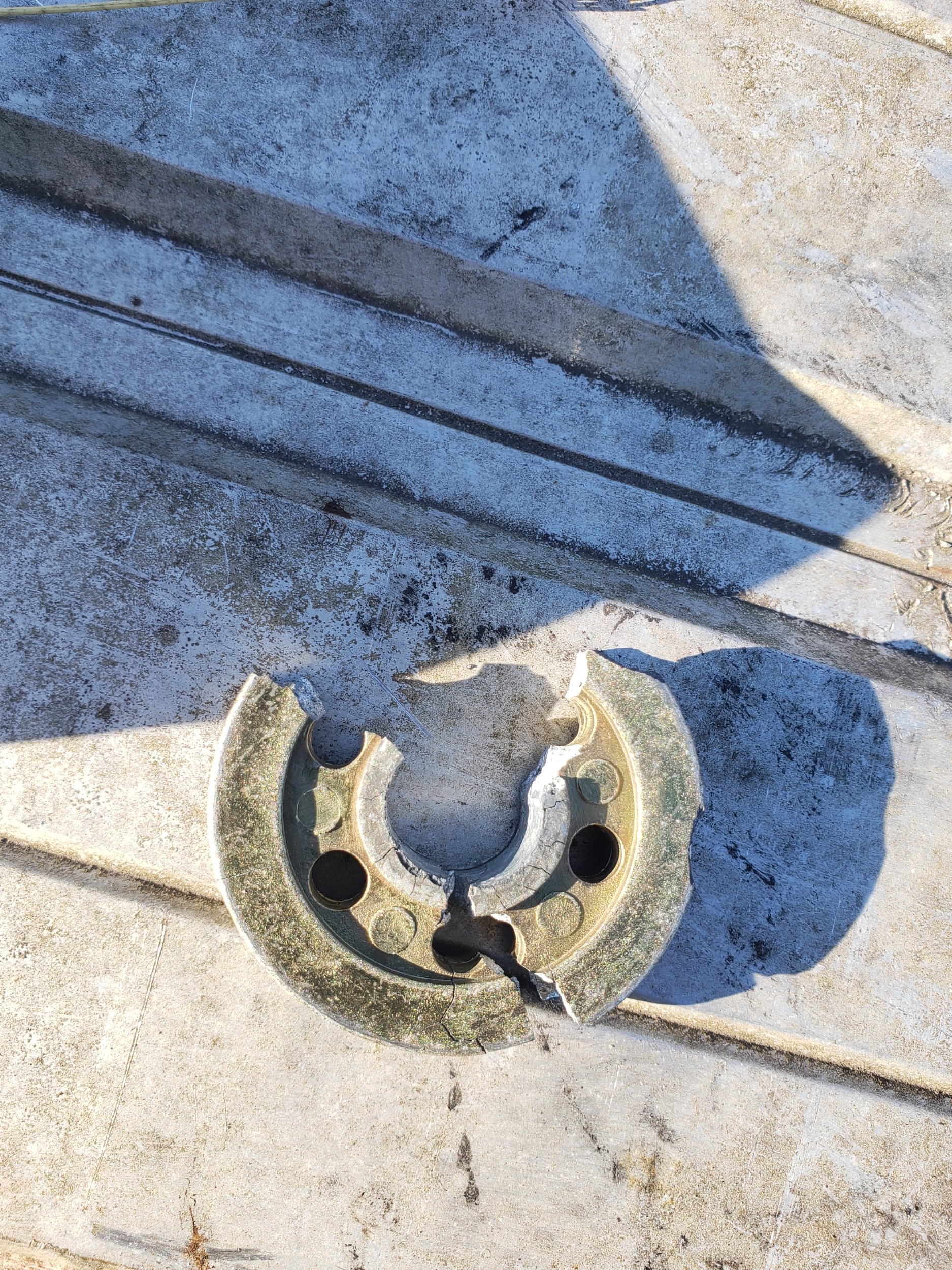

The block in picture was the ones that broke on me. I bought half a dozen of them for the trip, trying to cover all the bases since I didn't know what I was getting into. When I went to nearest store that had anything to offer, I was lucky that had enough higher quality items to allow me to load the 2 tractors and implements. I had 2 winches with me, and the Block failure took out the cable on one, so while I was at Tractor Supply, I also bought another winch because it was cheaper to buy the whole winch rather than just a new cable (which they didn't have ends for anyway).

Here is one of the broken rollers

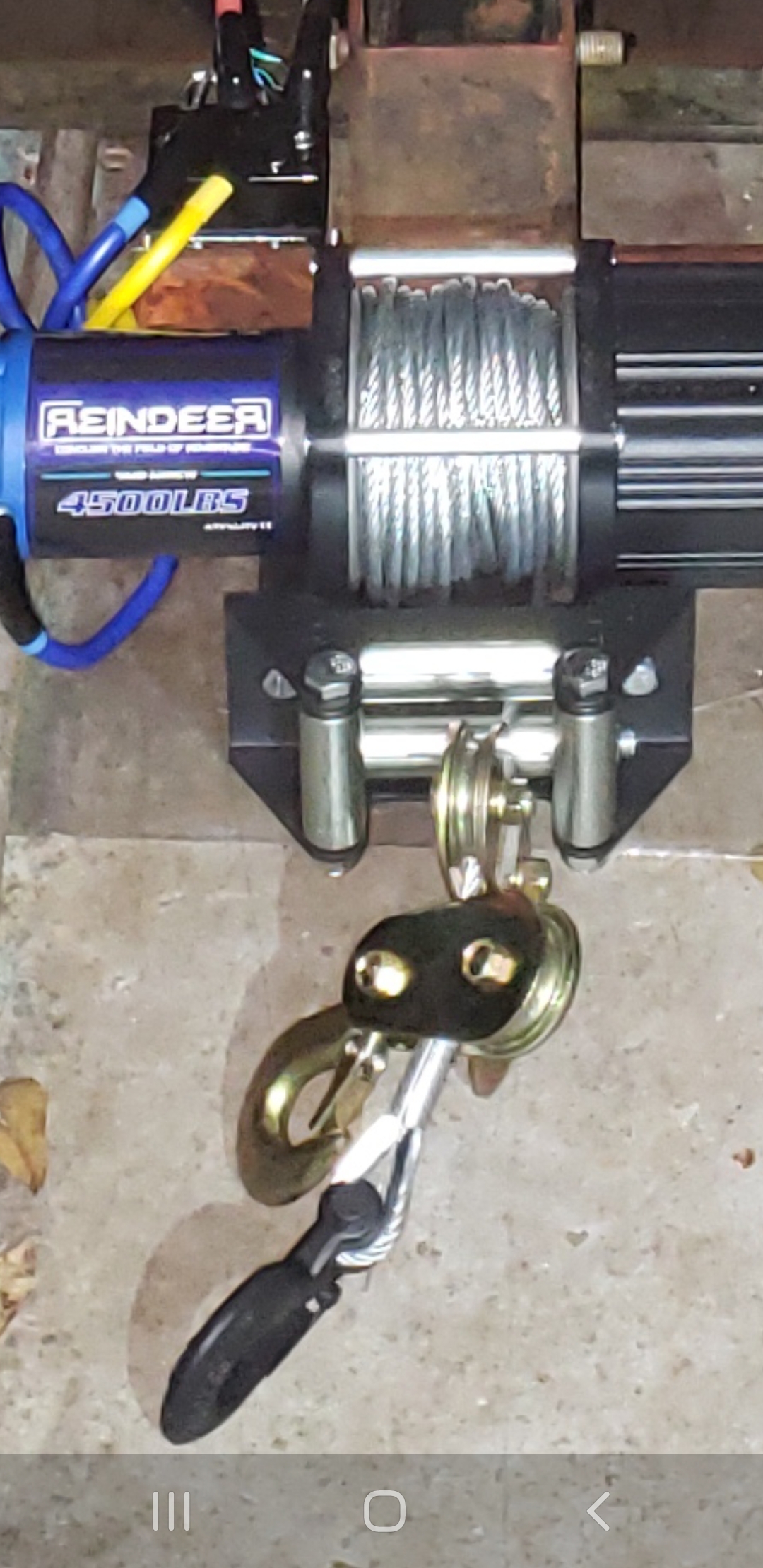

I have a few HF snatch blocks, you can see one hanging on my winch,
I've made some HARD pulls on them and they handled it just fine.
I did take them apart when I got bought them, put a film of synthetic grease on the axles and re-assembled.

Some have grease nipples.

Yes, some do, but these things don't run constant, so a film of grease on the axle/bush will last for years, and it won't get over greased or end up with a damaged grease zerk.
SO, mine don't have a zerk and for the limited use a snatch block gets, they don't need one.
