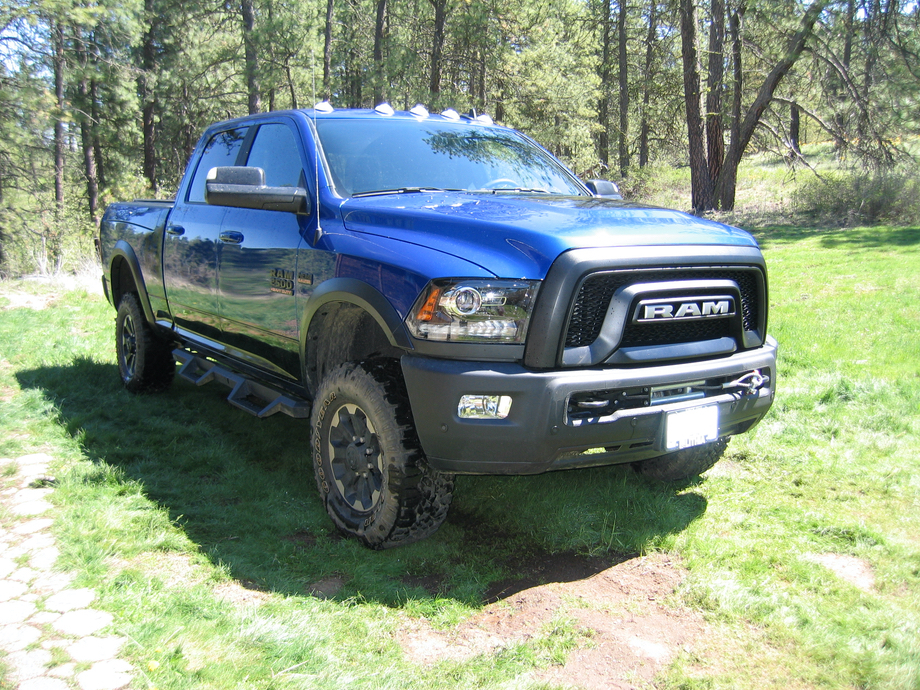

My Taco Wagon ( Ram 2500 Power Wagon ) comes, standard, with a WARN 12K electric winch. I wish I could show, via picture, how much heavier the wiring is in the engine compartment because of this winch. I got the Taco Wagon, new, in 2019 and have yet to need the winch. If I were to do SERIOUS 4 wheeling - a double fluke boat anchor would be stashed away on the pickup. There seldom seems to be a good anchor point when you really need one. A boat anchor was standard equipment when four wheeling in Alaska. The scrawny birch and spruce trees were NEVER good anchor points.
Not to initiate a pizzing match with you but the frame ears on Dodge and RAM pickup trucks are inherently weak. One reason they suffer from 'death wobble' as the stock mounted steering box loosens up. There is an aftermarket fix but the issue should not be there in the first place and it has to to with the frame ears out front and the lack of proper support. You get that in a hard double line dead pull, you could very well 'screw the pooch'. I'd be very careful winching from the front, like I said with a double line (snatch block) pull... and I think I'd add some kind of 'Bull Bar' to the front, as that wimpy bumper and plastic fascia isn't going to take much without breaking.
