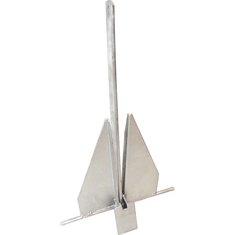

Years ago, when I used to play in the mud with my poor old Bronco, I had a 12k Warn Winch with the brush guard, etc on it. It would pull like a bear but I couldn't keep the tires from dragging. Especially when I was hooked to a 4k lb Swamp Buggy stuck in 4 feet of mud.
So I started carrying a boat anchor with me. Complete with about 6 feet of heavy chain and at least 50 feet of line like you'd have on a boat. It was a 22lb Danforth, IIRC. But they've gotten stupid pricey because -- Well, they can. You can find them cheap online and if you use your winch often, I recommend having that anchor to tie off of your rear (or front, depending where your winch is.
The anchor will grab and let you pull whatever. When I was done, I'd run over the anchor to break it loose. Didn't always work so I sacrificed a few anchors to the mud gods. Cheaper than finding a front loader to pull you out. Not a front-end-loader, I mean a Front Loader.

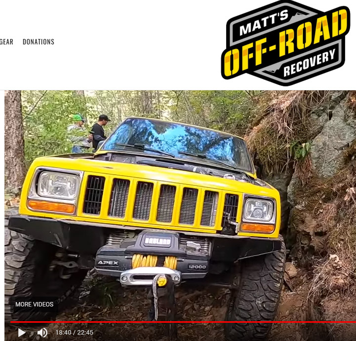

Discussion of tools on TBN ultimately leads to Harbor Freight as the go to source. On the other hand I don't see professionals in the field using Harbor Freight tools. You would think pros that have to replace tools often because daily use wears them out would wise up and stop paying 3 and 4 times what they would at HF.
I was surprised to see HF winches in Matt's Off Road Recovery videos on Youtube.
