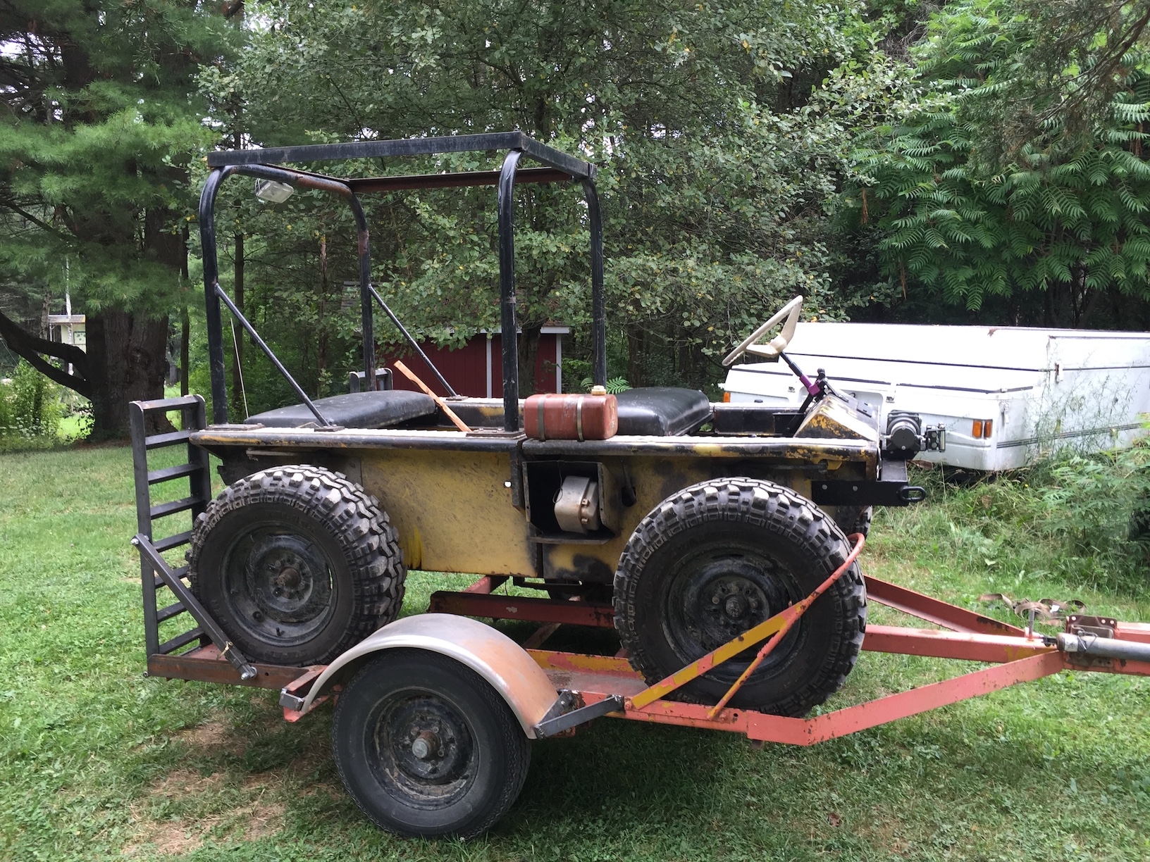

Among all my options for working in the woods: tractor modified for forestry use, Can Am Outlander Max ATV (recently sold), Honda Pioneer SxS, 1951 Dodge M37 military pickup, my favorite is an antique ATV known as a Coot. It's 4WD, 4W steering, amphibious, articulated. Originally powered by a 12 HP, single cylinder Tecumseh, but since upgraded to a 16 HP Briggs Vanguard engine. will handle 45˚ slopes. Max speed is 20 MPH, but it will go places my other vehicles can only dream of going and tow 1500# easily. (I've pulled 3000# with it, but probably won't do that again.)

If you still have the link to that Coot on FBM, please post it or message it to me. I know people who are looking for them. They generally tend to get snapped up more or less locally or by someone within a decent driving distance. (Shipping can be a hassle that some don't want to deal with.) IT may already have shown up on a Coot-related FB site I help administer, but you never know.)
They are quirky little machines, but a lot of fun, and easy to work on and modify. The articulation keeps all four wheels on the ground even on very rough terrain. The drive system consists of a worm gear drive on each axle. (I replaced the cover for the unit on my front axle with one made of Lexan, so people could see the worm gear drive.) Since there are no differentials, all four wheels turn at the same speed all the time. That combined with the fact that there is a completely smooth belly with about 12" of ground clearance makes it hard to get them stuck: they just keep going until you bottom them out in a swamp or high-center them. (When high-centered, you can often get free just by shifting your weight or giving them a little push.)
The downside is that with no differentials, the turning radius on the original 2 wheel steer units was not good. The eventually came out with a 4 wheel steer option which helped the maneuverability a lot. Both of my Coots have been converted to 4W Steer.
There is a good support forum: CootWorld which is a rather low-traffic site currently, but has a LOT of good information archived. And a very active FaceBook group: Coot/Croco 4x4 ATV Enthusiasts which is fairly active.
Many parts are still available of the shelf. A few are difficult to find, but can usually be turned up through the network of Coot users.

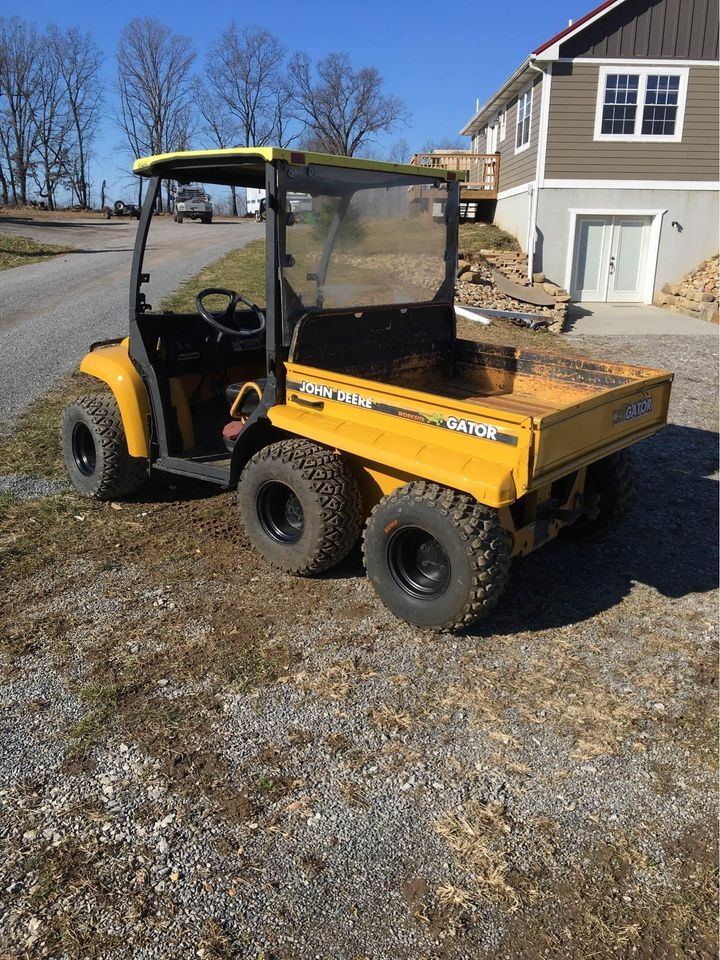

I still want a old school Gator 6x4 diesel with a Curtis cab, but I heard vital parts are now discontinued? I was going to buy one for sale locally on FBM, but my JD parts guy thinks I will have issues with finding some parts.
The new version of the 6x4 looks like it’s built out of Tupperware (n) , but still has similar drivetrain.
Wish I had more real useable information.

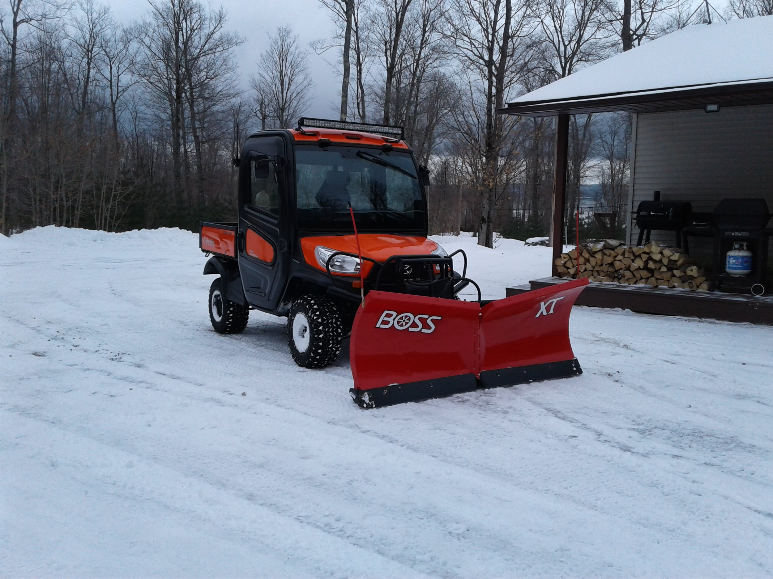

I seriously considered a Kubota (like my tractor) but dealers are 2 hour drives away plus most of their mechanics are not very familiar with other than AG grade tractors. Yamaha is also a fine brand, but the local dealer is "into" sales, not service, and it's primarily for motorcycles. So, a Honda, and I realize it's a local consideration. The service department is great and my 2006 ATV is still going strong. If you want quiet and a cab, I'd recommend the 1000 cc model, as it's the only 2 cylinder UTV they have and it also is the only one with a "turf mode" option for the rear wheels that doesn't rut up lawns when you turn (most ATVs/UTVs have solid rear axles, no differential). I've now had a Honda 700 pioneer for 2 years, and it's rock solid reliable regardless of weather or ground cover (mud, debris, snow, etc). Note Honda does have "recreational" UTVs, which are way faster and "sexier" and your kids would love one, but if you want to haul something (like a deer) or use the UTV for work, forget about it.
