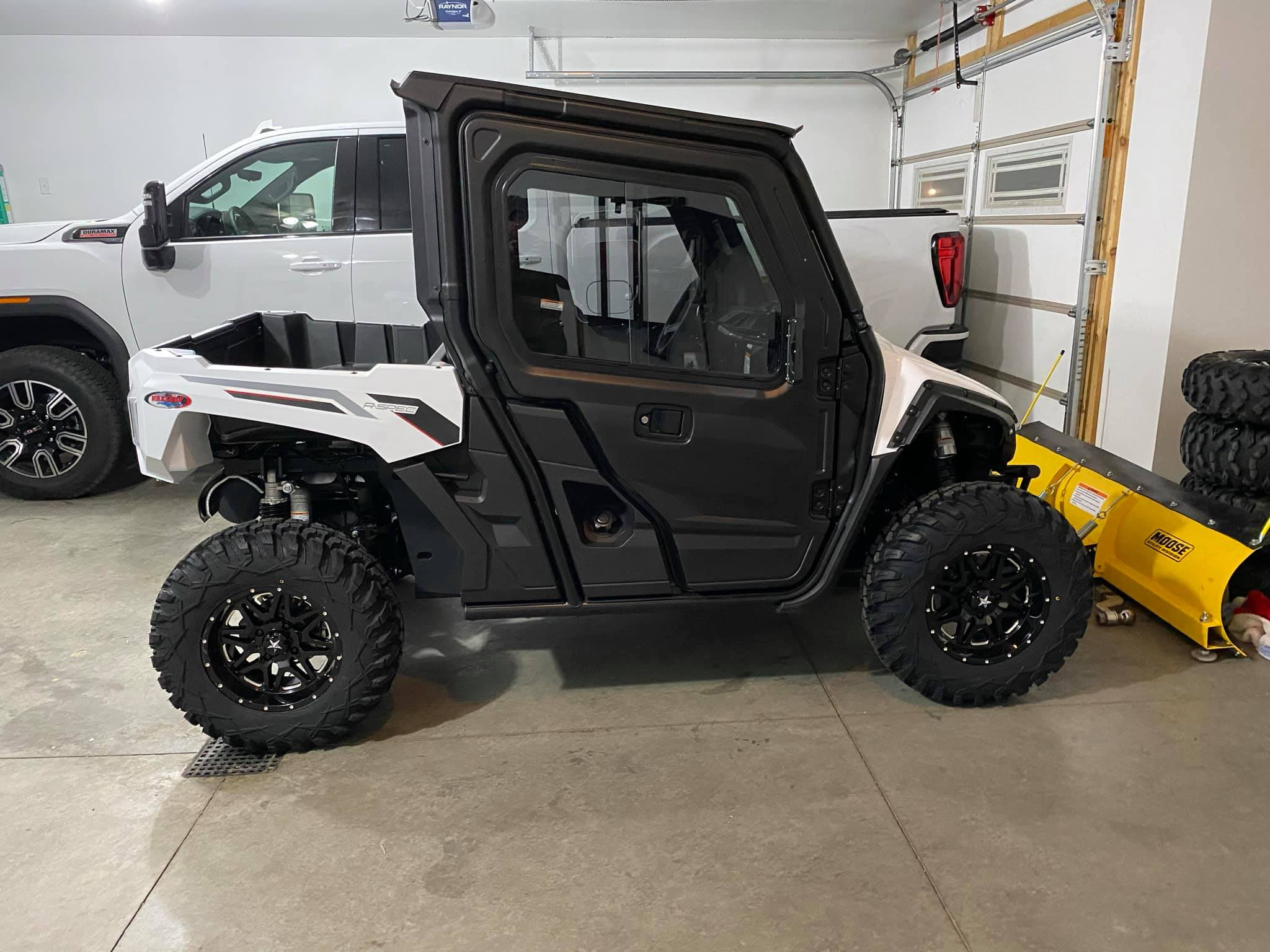

I've had my X2 Wolverine for a little less than a year and have no complaints. I use it to run chores around our property and plow snow with a little bit of trail riding and dirt road riding thrown in. It has plenty of power (for me) and the suspension is worlds better than my dad's diesel Mule. There is a FB page dedicated to them and recently saw that a guy was thinking about trading his in for the newer model. His X2 appeared to have a full cab on it. Here is a picture of it:
And also an ad for one with a full cab from the same dealer I bought mine from: 2020 Yamaha Wolverine X2 R-Spec Realtree Edge w/Alum. Wheels
