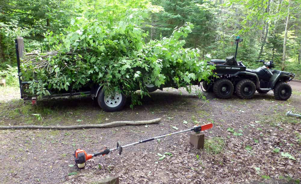

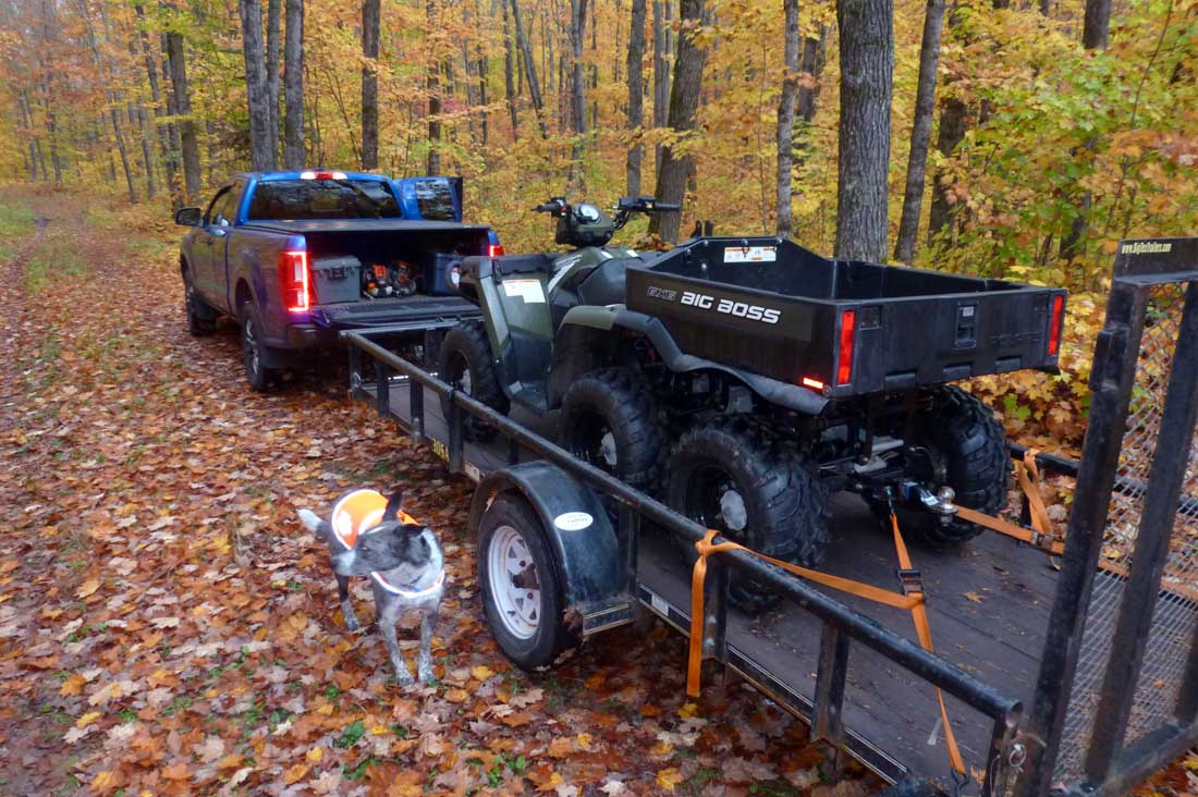

My Stagecoach 14' single axle 78" wide is very much like what he is showing in post 126. If you are buying new and dealing with a well-connected dealer (to the factory) there are a zillion options and things you can change/have put on. I had brackets put on for adding side posts if/when ever wanted, particular drop-leg jack that I liked, I used expanded metal for sides so I can haul mulch and debris without adding plywood kludge sides like I used to, heavier axle, stronger tires, etc. repeating myself from prior posts. I really like the small beavertail rear end which causes the ramp to be shorter and easier to handle & makes for easier loading all the way around. These things CAN be made with short side ramps too which is often done with "landscape' trailers. I did not want that. You gotta get 'close' the good dealer/factory to really know what all options and choices are. Some websites are good but still do not list every bell and whistle that might be important to you.

No trailer is perfect... No matter what you have, 6 months later you wish you had this,,, or you got some feature you never use. On our new doo-little we do like its accessoire box.
On this trailer, it needed better positions for its D-rings to tie this machine down. I added them this fall.
