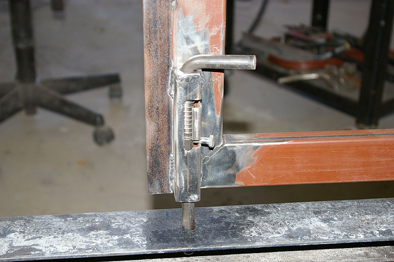

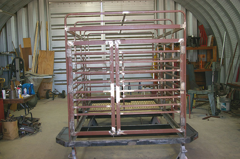

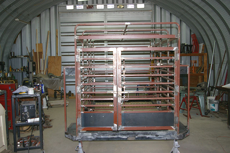

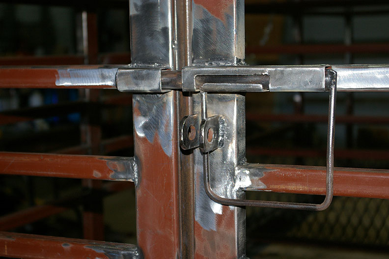

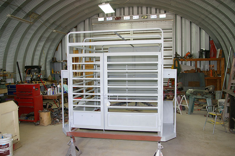

The rear gates were next. I have found that having the right gate wider than the left, I am right-handed, makes it easier to load goats by yourself. And, by having the interior gate open to the right side of the trailer allows you to get your goats in and then push them to the front of the trailer using the gate. Keeping the left side rear gate closed prevents the critters from slipping back past you. 25Feb16_36.jpg
The left gate serves as the anchor point. It is latched to the floor of the trailer and the right gate bumps up against it. 25Feb16_37.jpg 5Apr16_41.jpg
The latch can be secured with a lynch pin or a padlock. The padlock is for when you are transporting goats and stop for lunch. It keeps the Lookie-Lous from opening the gates and letting your goats out into the parking lot. 25Feb16_38.jpg There are some really stupid people in this world.

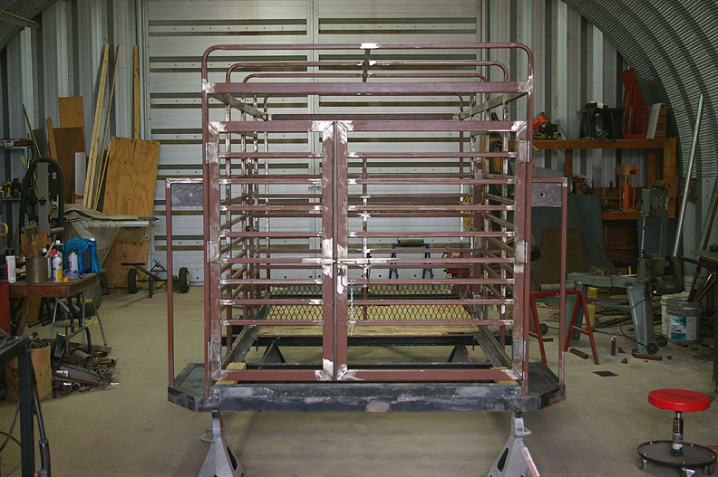

Tail light mounts were the next step in the transformation. They extend out beyond the enclosure and are at eyeball height for the driver in the car following. No wiggle room for tailgating drivers who say they couldn't see the tail lights. 11Mar16_39.jpg

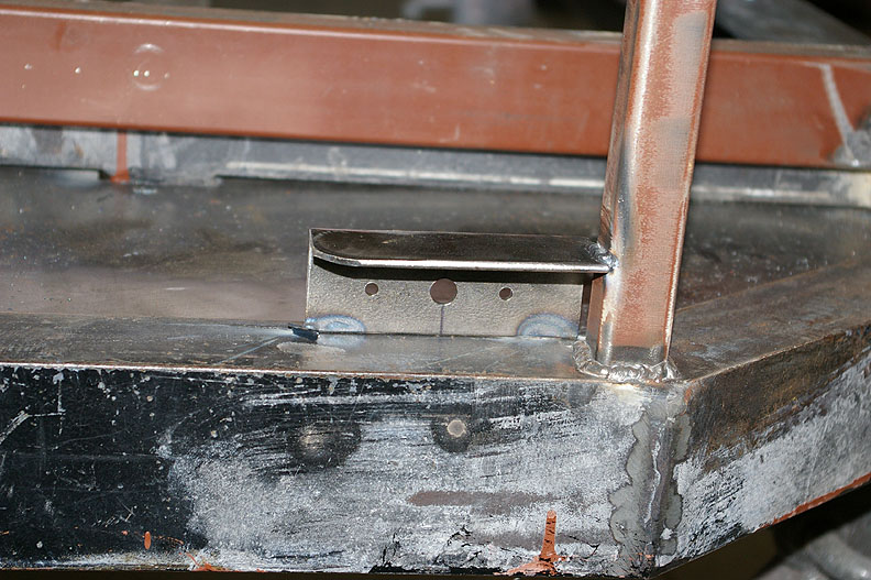

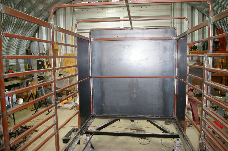

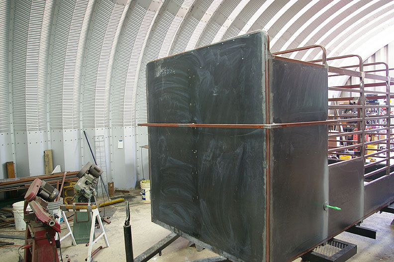

Mounts for the rear marker lights were made with 1 1/4" X 1 1/4" X 1/8" steel angle. This serves to protect the lights from big feet and heavy dropped objects. 5Apr16_42.jpg

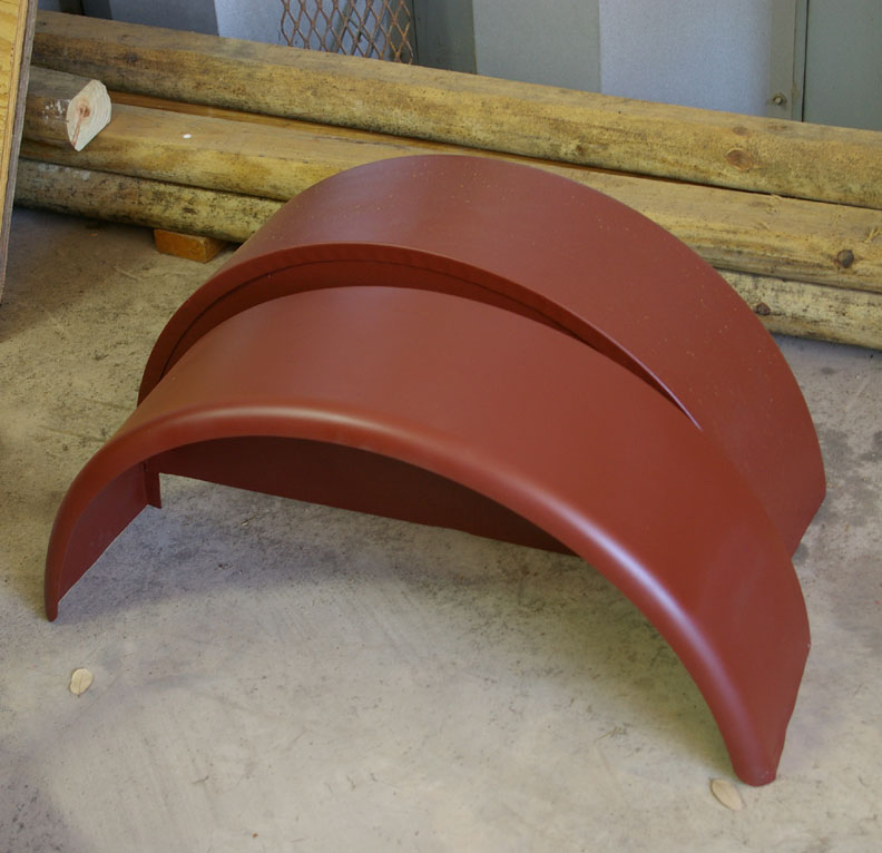

After the dings were knocked out and the rust removed, the original fenders received a heavy coat of red oxide primer. 5Apr16_43.jpg

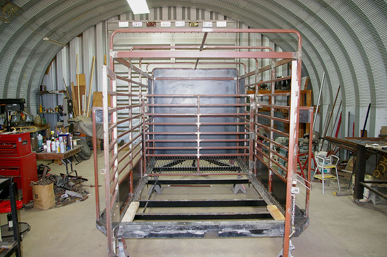

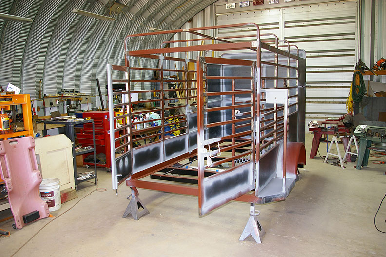

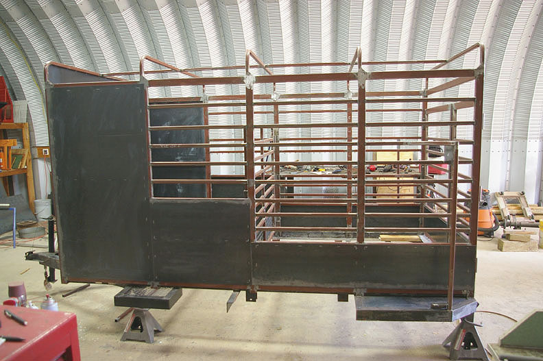

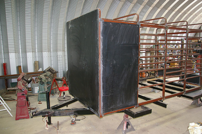

It was time for the 16 gauge cold rolled steel sheet metal. It was used on the front and the front two feet on each side. It serves to protect the goats from water spray when transporting them in the rain. It would protect them from snow as well, but this is central Texas and that just doesn't happen here. 18Apr16_44.jpg 18Apr16_45.jpg
The lower parts of the sides were also covered with sheet metal. 21Apr16_46.jpg 21Apr16_47.jpg

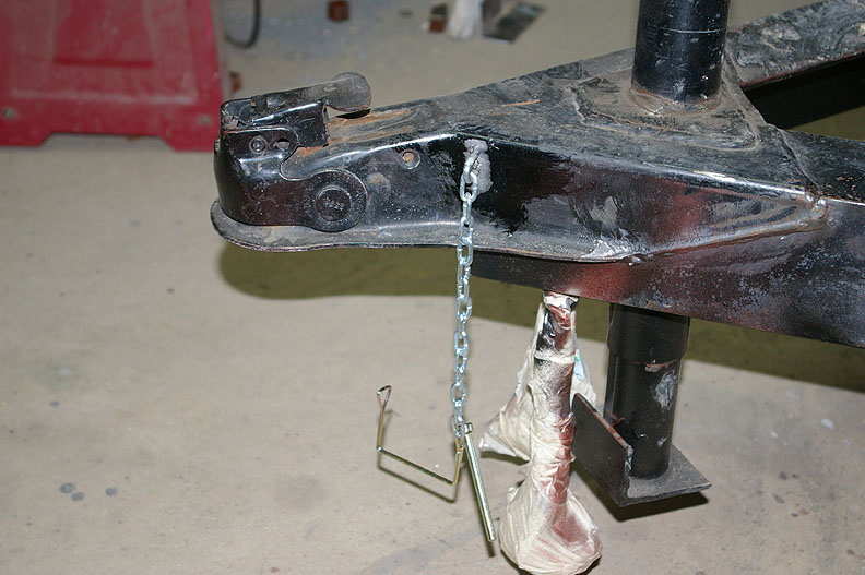

Do you always lose the lock pin for your hitch? You'll have to try to lose this one. 30Apr16_50.jpg

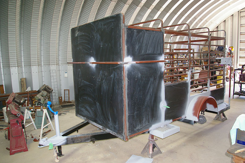

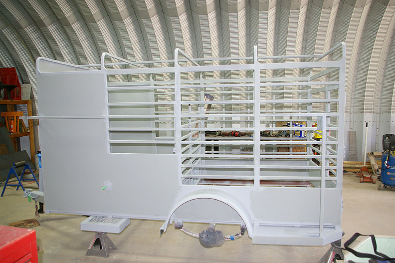

The fenders went back on and the seam between the fender and the sheet metal was filled with caulking. The sheet metal received a heavy coat of primer before the fender was welded on. The seams between the metal sheets were filled with liquid metal, sanded and primer painted. 4May16_51.jpg
Caulking was also used to fill the gaps between the sheet metal and the tubing inside the trailer. 4May16_52.jpg
The entire trailer received a heavy coat of gray primer, inside and out. 9May16_53.jpg 9May16_54.jpg

The fenders went back on and the seam between the fender and the sheet metal was filled with caulking. The sheet metal received a heavy coat of primer before the fender was welded on. The seams between the metal sheets were filled with liquid metal, sanded and primer painted. View attachment 470729
Caulking was also used to fill the gaps between the sheet metal and the tubing inside the trailer. View attachment 470730
The entire trailer received a heavy coat of gray primer, inside and out. View attachment 470727 View attachment 470728
