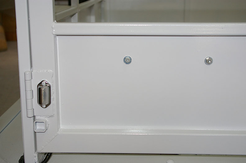

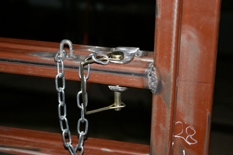

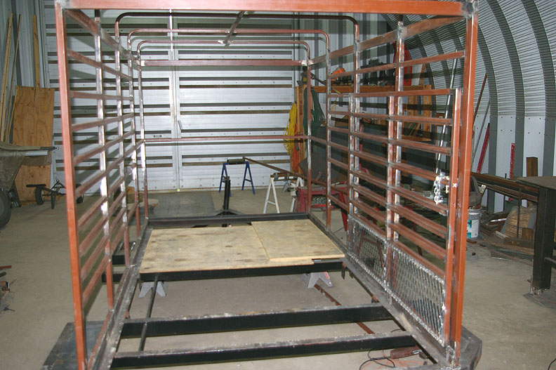

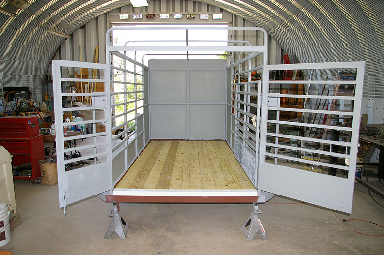

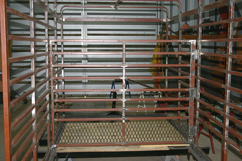

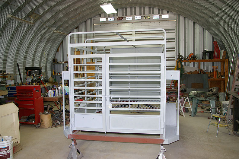

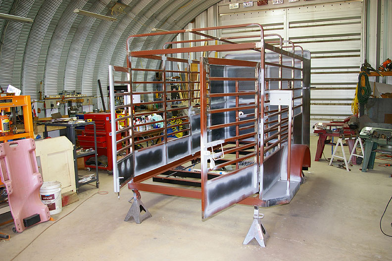

The rear gates were next. I have found that having the right gate wider than the left, I am right-handed, makes it easier to load goats by yourself. And, by having the interior gate open to the right side of the trailer allows you to get your goats in and then push them to the front of the trailer using the gate. Keeping the left side rear gate closed prevents the critters from slipping back past you. 25Feb16_36.jpg

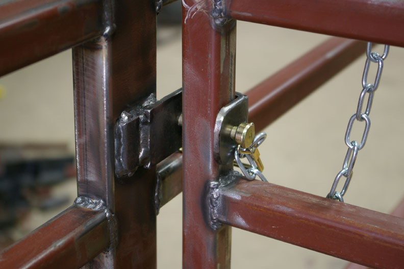

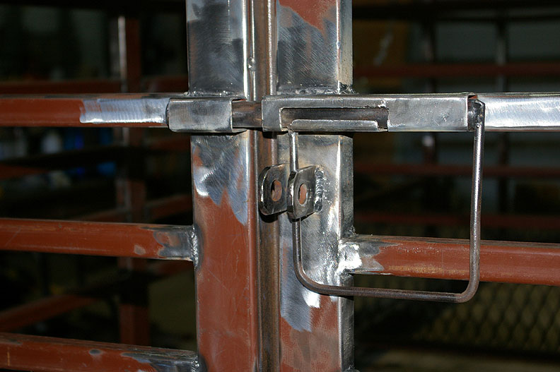

The left gate serves as the anchor point. It is latched to the floor of the trailer and the right gate bumps up against it. 25Feb16_37.jpg 5Apr16_41.jpg
The latch can be secured with a lynch pin or a padlock. The padlock is for when you are transporting goats and stop for lunch. It keeps the Lookie-Lous from opening the gates and letting your goats out into the parking lot. 25Feb16_38.jpg There are some really stupid people in this world.

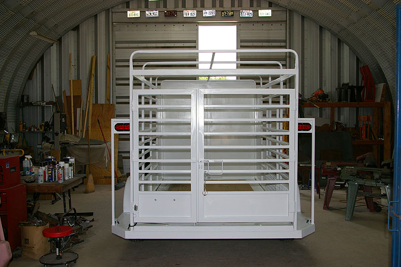

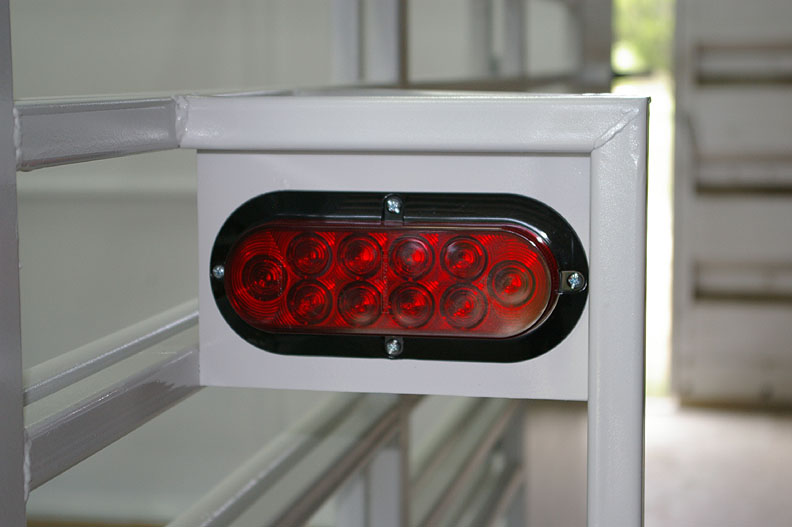

Tail light mounts were the next step in the transformation. They extend out beyond the enclosure and are at eyeball height for the driver in the car following. No wiggle room for tailgating drivers who say they couldn't see the tail lights. 11Mar16_39.jpg

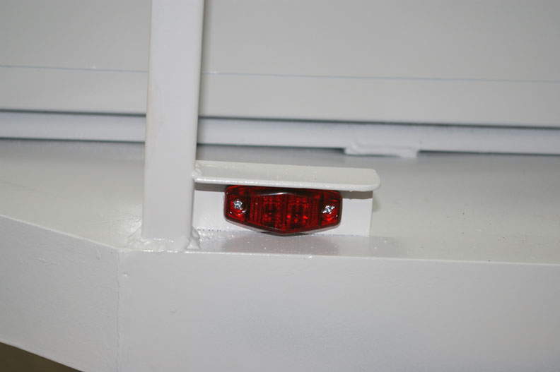

Mounts for the rear marker lights were made with 1 1/4" X 1 1/4" X 1/8" steel angle. This serves to protect the lights from big feet and heavy dropped objects. 5Apr16_42.jpg

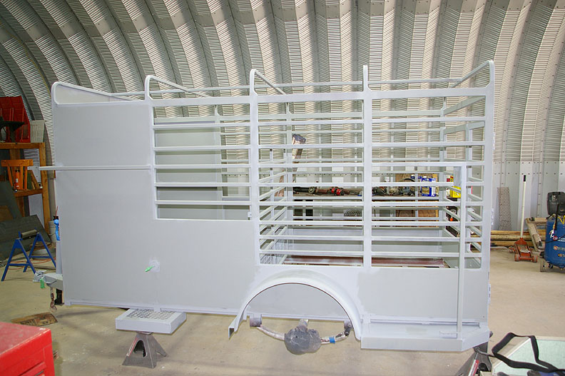

It was time for the 16 gauge cold rolled steel sheet metal. It was used on the front and the front two feet on each side. It serves to protect the goats from water spray when transporting them in the rain. It would protect them from snow as well, but this is central Texas and that just doesn't happen here. 18Apr16_44.jpg 18Apr16_45.jpg
The lower parts of the sides were also covered with sheet metal. 21Apr16_46.jpg 21Apr16_47.jpg

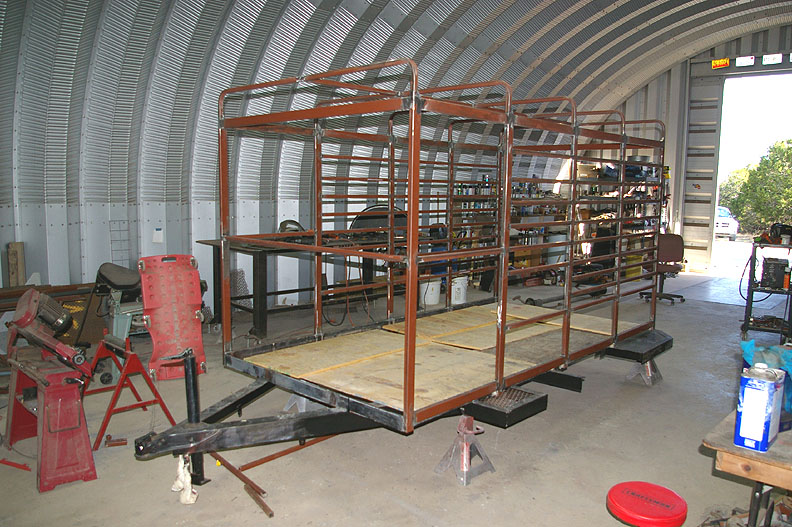

The tarp tie down bar was welded on. This will be used to tie the tarp down over the sheet metal and the spare tire mount bolt was also installed. 30Apr16_49.jpg
Do you always lose the lock pin for your hitch? You'll have to try to lose this one. 30Apr16_50.jpg

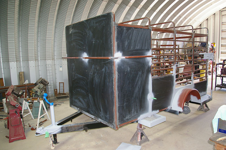

The fenders went back on and the seam between the fender and the sheet metal was filled with caulking. The sheet metal received a heavy coat of primer before the fender was welded on. The seams between the metal sheets were filled with liquid metal, sanded and primer painted. 4May16_51.jpg
Caulking was also used to fill the gaps between the sheet metal and the tubing inside the trailer. 4May16_52.jpg
The entire trailer received a heavy coat of gray primer, inside and out. 9May16_53.jpg 9May16_54.jpg

What kind of caulking?

Three new 225/75R-15 ten ply tires mounted on the newly painted wheels are ready to go on the trailer. 9May16_55.jpg

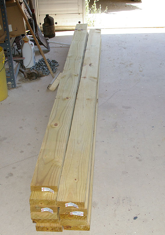

The new floor is in. The boards are screwed down to the frame at mid point. The angle steel over the end (painted white) is bolted on. This allows for easy removal of boards when they need to be replaced. 10May16_57.jpg

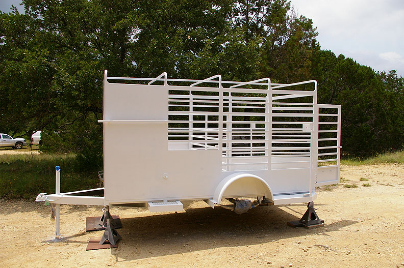

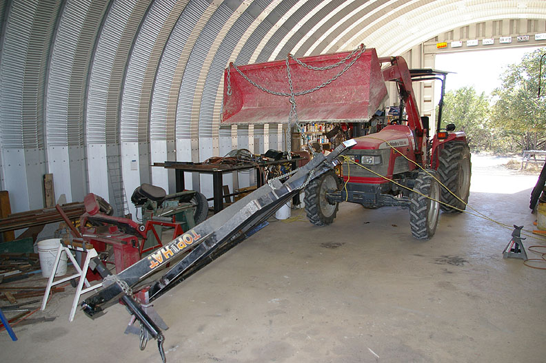

The weather finally cooperated and with the help of the Mahindra :thumbsup: the trailer went outside and up on jack stands again to be painted with 1.25 gallons of Rustoleum Gloss White. After 3.5 hours it looked like this. 21May16_59.jpg 21May16_60.jpg
The oval shaped super bright tail lights right at eye level to the driver behind you. If that driver is in a car. 26May16_63.jpg
Add the tarp, reflective tape and my contact information and it is finished. 29May16_65.jpg
Now, just to satisfy my curiosity. What would a trailer like this sell for in your neck of the woods? I know from experience that trailers in Colorado sell for nearly twice what you would pay here in Texas. Let me hear from you and thanks for following along. I don't make much money on them, but they sure are fun to build and it keeps me out from under my Bride's feet.
