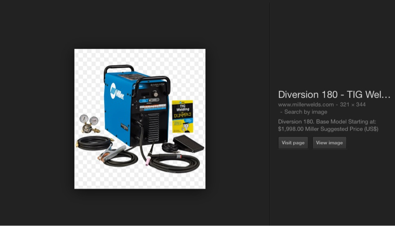

I think you'll find it an interesting diversion - my son said he would dream about watching the arc while sleeping after practicing tig aluminum :)
