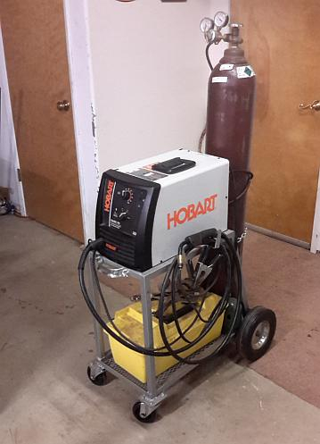

My HF MIG-180 lives on a HF $10 wood furniture dolly. I added a handle on the dolly like a kid's wagon. Sufficient, not elegant!
But before the MIG-180, here's a welding cart I made up for a heavy transformer welder I had several years ago. Its an elder walker from Goodwill with rails added to hold the welder. Cheap, simple, adequate.
This Century 110v MIG welder, even using flux core, was a day/night improvement over the previous HF 90A - AC flux welder that had been a continual frustration. DC in this welder in place of AC was an obvious major improvement but equally important, this Century, made for auto body work, had variable voltage - the difference between pro and the HF-90's near-useless specs.
kimg1227rweldercart-jpg.458160

Sure just drag it around by the whip... Cart serves more than the purpose of moving welder, it can also hold tank, a place to hang helmet, box or drawer to hold spare wire or MIG pliers and extra contact tips and any tools you may need to service welder or can of anti spatter spray, welding gloves, also hooks on side to coil up leads....Its like a shop doesn't "need" a welding table, but it sure comes in handy at times....
