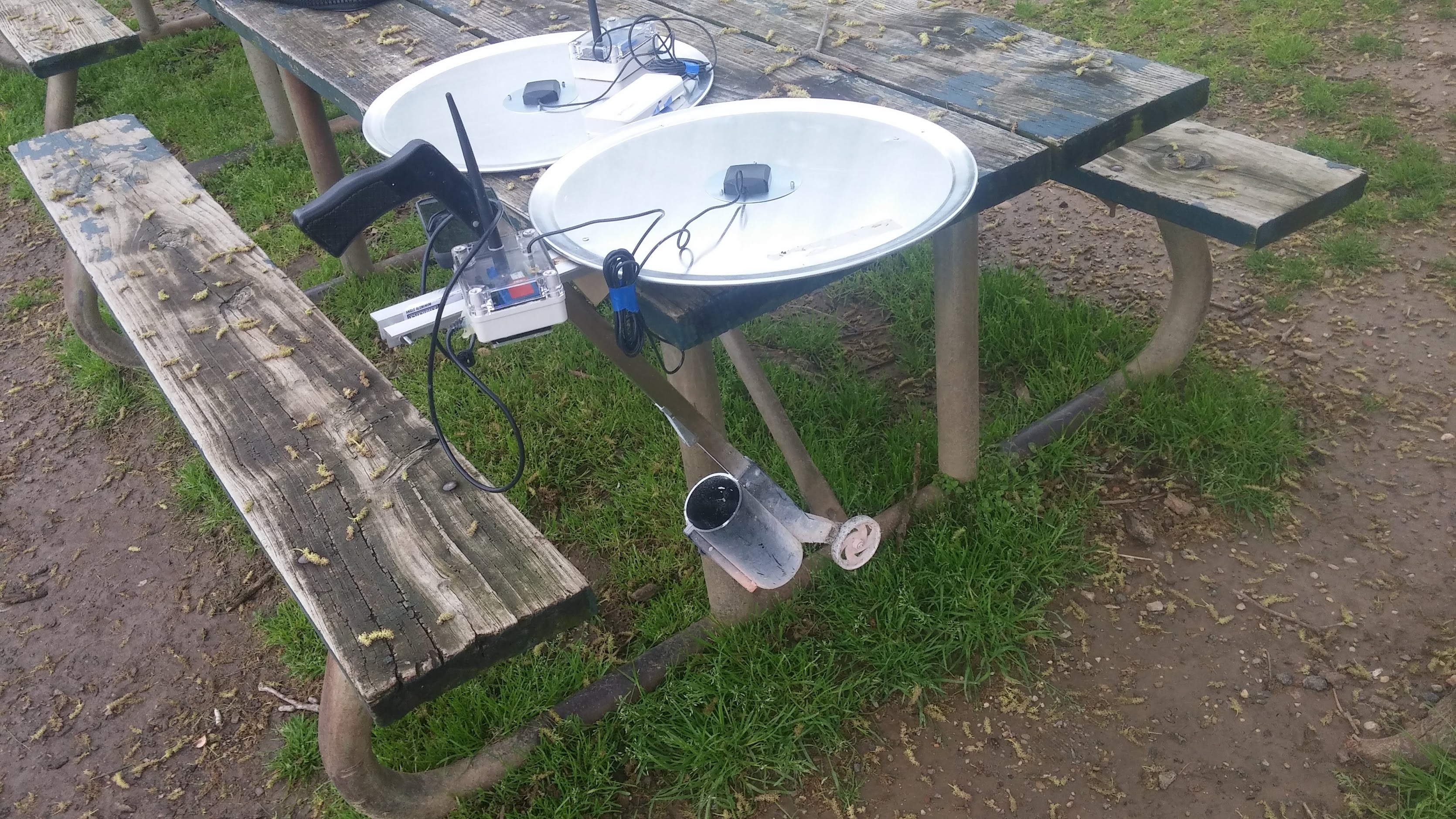

I clicked on the link to look at a pic of the equipment. It looks like it is just the guts of a GPS receiver. I saw where you mentioned putting a metal tray under them for reflections, which is called multi path. Surveying equipment has that stuff built into the housings and the software also helps in rejecting multi path.
Does your equipment just track American satellites? I am not sure how many are floating around up there now. Gps(USA), European (galelio), Japanese, Chinese (Bediou sp?) and Russian (Glonass). I first started using GPS about 1993 and at that time there were long periods of the day you could not work because there were not enough satellites. With RTK you need 5 to get a fixed solution and 4 to maintain it, that assumes no obstructions. These days it not uncommon to track 15 to 20 satellites.
Do you have this in some kind of housing? Are you using some kind of pole? Kudos to you to get it working, that is way beyond me.
The kit is just a circuit board although it comes with a GPS antenna and a radio antenna. It looks like this:
This is the housing I'm using:
Small Plastic Project Enclosure - Weatherproof with Clear Top ID: 93 - $9.95 : Adafruit Industries, Unique & fun DIY electronics and kits
I drilled holes in it for the antennas and the USB cable.

This is very innovative. The limitations of your paint wand are impacting your accuracy much more than the limitations of your GPS. I would look into buying what is called a rover rod. It is a collapsible pole that is 2 meters tall. You mount your receiver on the top of it, it has a bubble level mounted on the side of the pole so that you can tell it is plumb, and it goes down to a point on the bottom. Using one of these I have done some very precise things such as embedding anchor bolts into concrete slabs as they were poured that later the columns for the building were bolted to. Not much room for error there.

I tell you that痴 a heck of a setup. I assume the black box in the center is the GPS antenna? One thing that will help is to get that setup in the air. We usually use a 2 meter pole to get it up over our heads and the base sets on a tripod about 5.5 feet high.
Thanks. I think I could mount it on a camera tripod pretty easily. It's good to hear how it's "really" done, I started this not knowing anything about GPS.

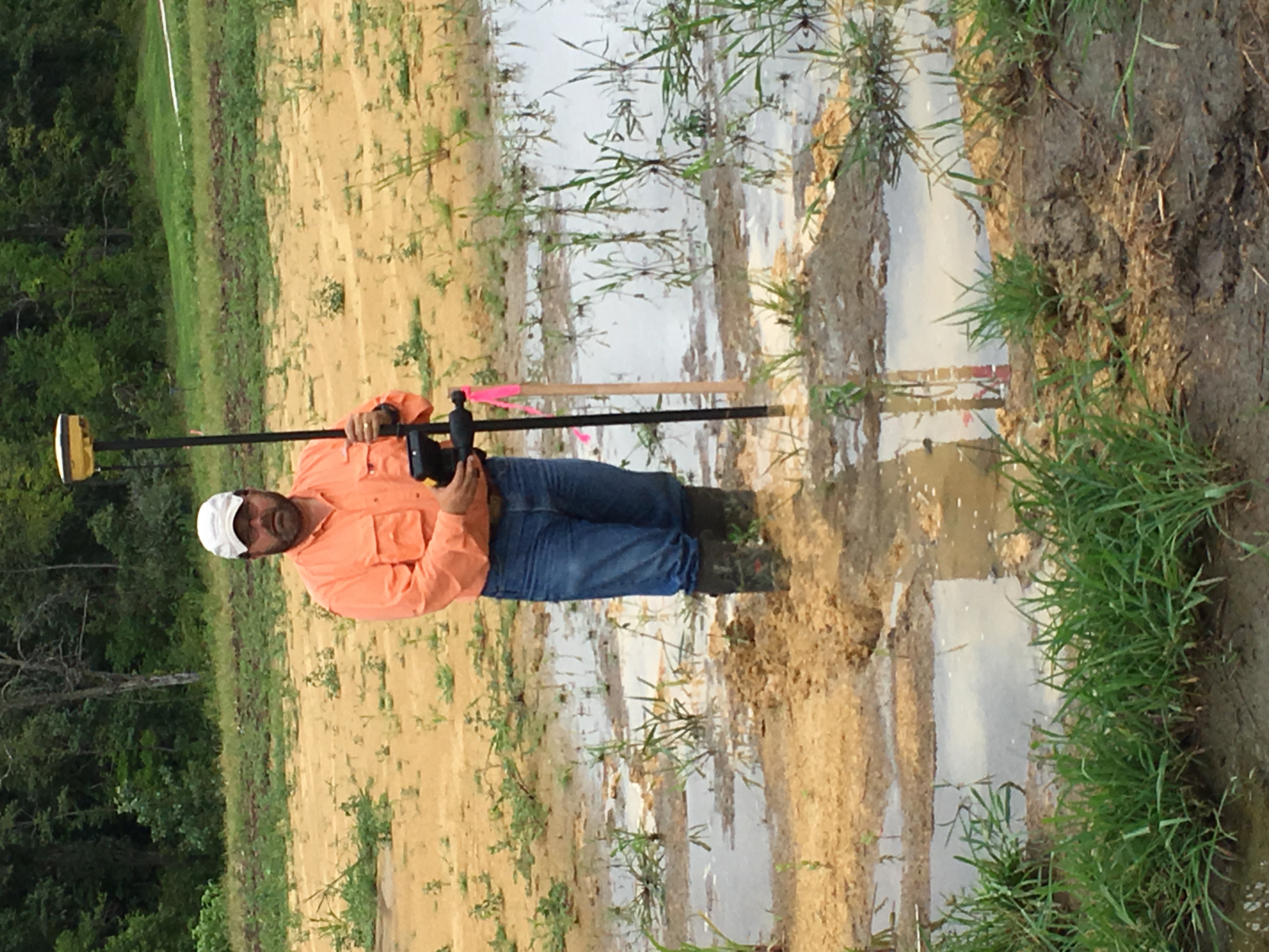

The attached photo is our old GPS system a Topcon being run by one of my coworker. On top of the pole is the GPS antenna, it also contains the radio and the chips and board. Half way down is the data collector. We also have a 35 watt radio that we can setup with the base that gives us a radio range of over 10 miles or we can use the built in radios which have a range of over a mile.
Our new system, a Trimble has all of that plus a VRS system. With this we can use a hotspot to link up to the internet and use multiple bases tied into the system. Some states offer this service for free, in Illinois we have to pay for it, $2500 a years as I recall. With VRS you don’t need a base.
One thing about your system is it must have RTK software built in, called an RTK engine. It’s not just the hardware that makes this all happen but the software is an even bigger part of it.
