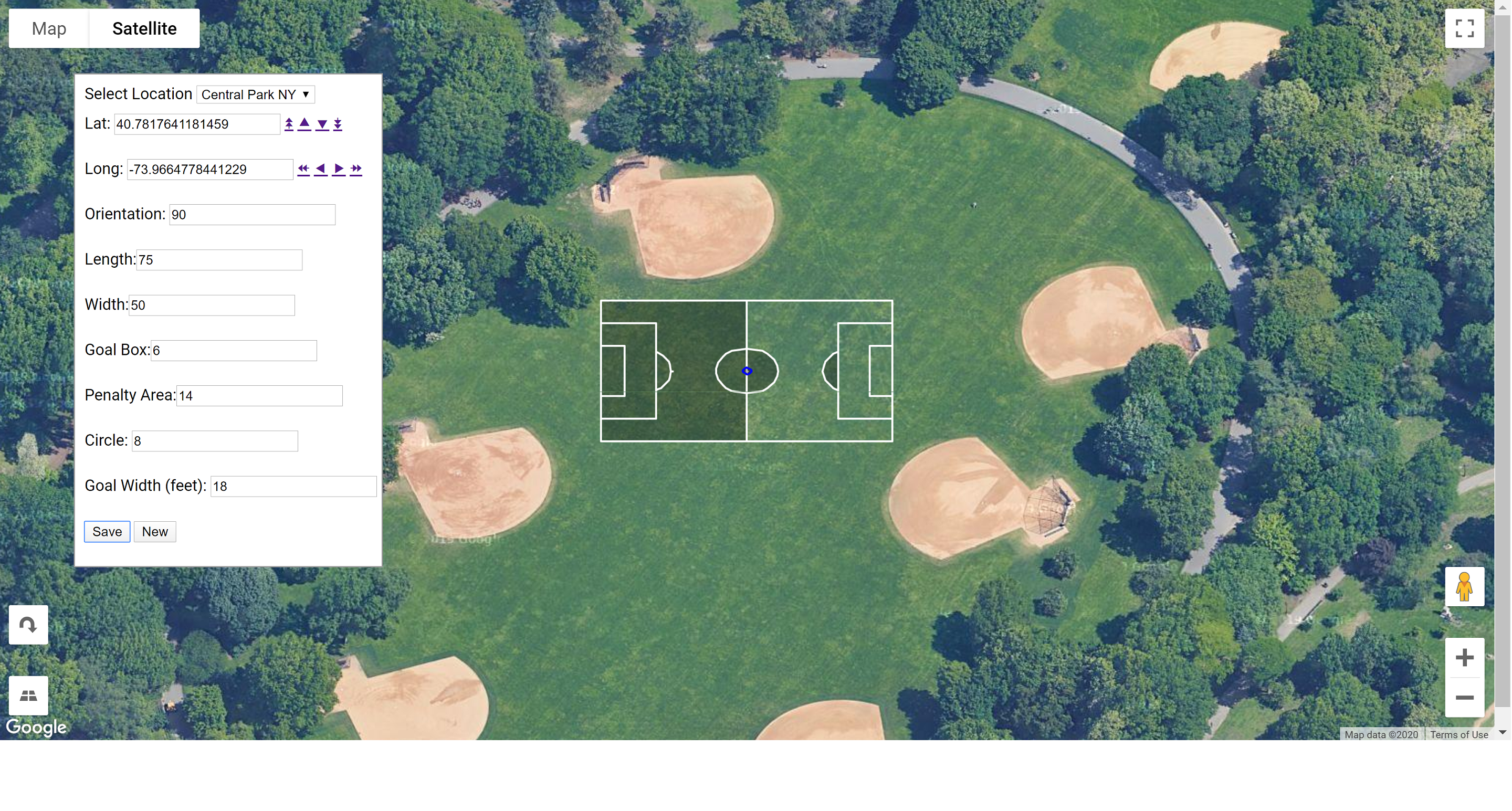

This project started out in a way that had almost nothing to do with tractors. I was volunteering with a youth soccer club. It's a large club, it had 7,000 members and over 200 games a week. For a typical season we'd use 35 to 40 fields, and they all had to be painted with lines for the games. Each age group had a different size field, ranging from 25 yards for 5-year-olds to 120 yards for high school kids. Mostly we relied on volunteers to do the lining, and it was a constant headache. We'd try to give people directions, but they would put the field in the wrong place or the wrong size or the wrong shape or crooked. You never know how many ways something can be done wrong until you ask volunteers to do it. So this project started out simply as a way to make maps that we could give to volunteers to show them where a field should go and what it should look like.
I create a web page that uses the aerial view in Google Maps and allows you to put in the latitude and longitude of a place, and then put in the length, width and orientation of a field, along with the dimensions of the interior lines, and it draws a picture of the field on the map. Here's a screen shot of the web page with a field for 12-year-olds drawn up on the grass of New York's Central Park:
Just this map was a tremendous improvement. Since it's a web page someone can have it on their phone when they're on the ground. The Google aerial photography is pretty high-resolution, it can guide you around on the ground. You'll see on the input screen there are arrows next to the latitude and longitude. The single arrow moves the field one foot and the double arrow moves it ten feet. The resolution of the photos is generally good enough that a one foot move is noticeable.

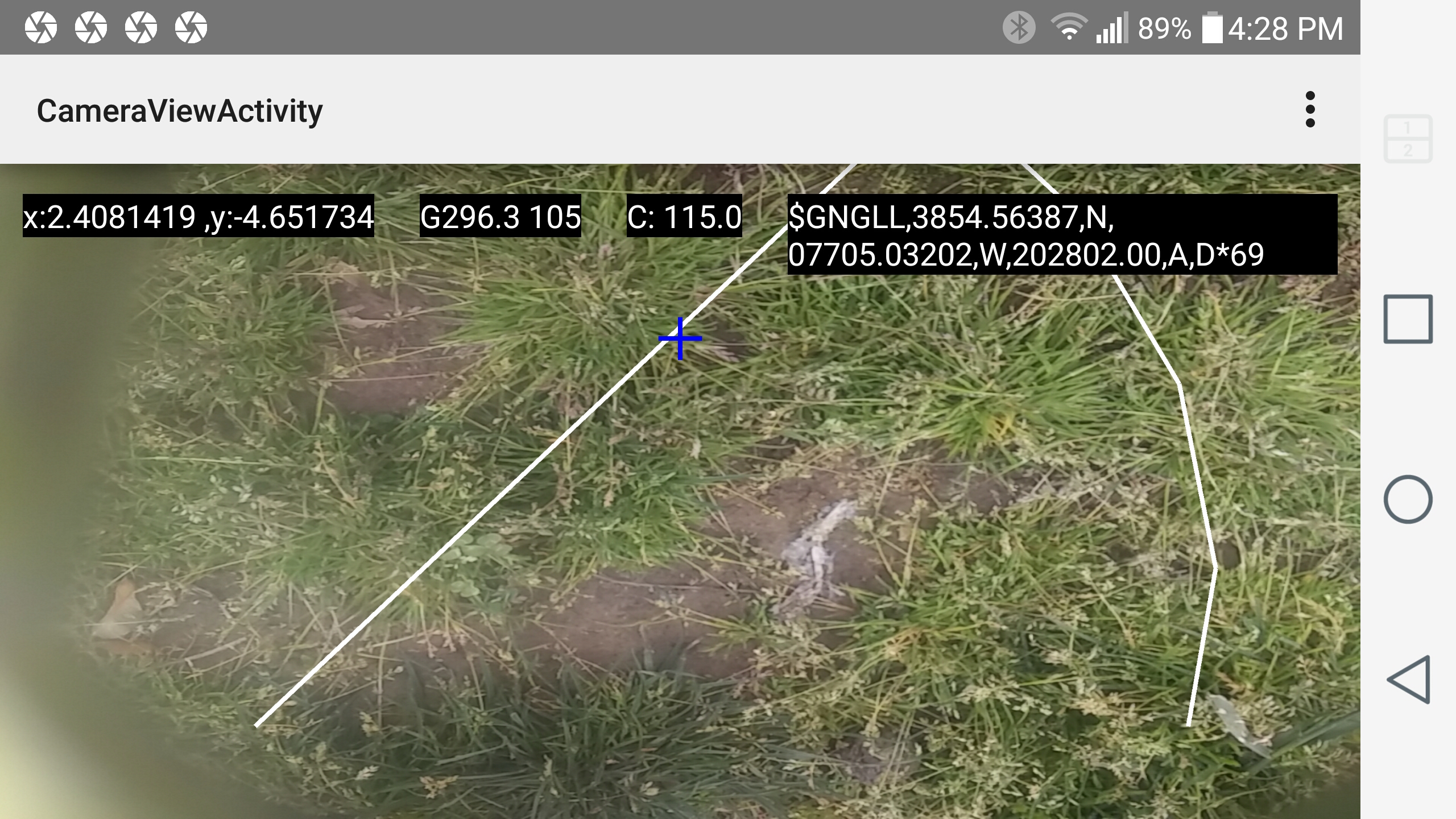

So now I had to figure out how to turn it into something useful. I have some programming experience which I was able to put to use.

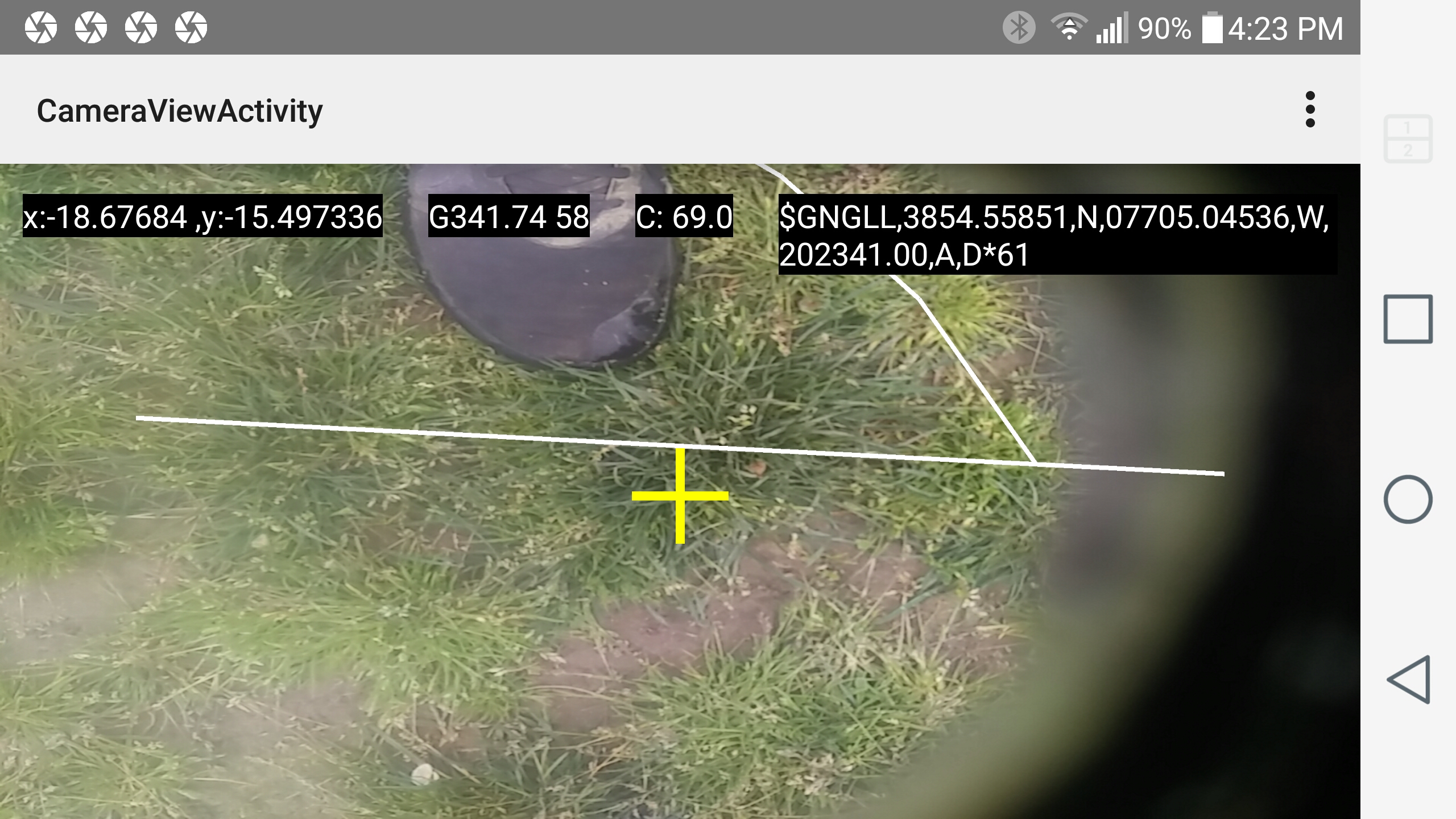

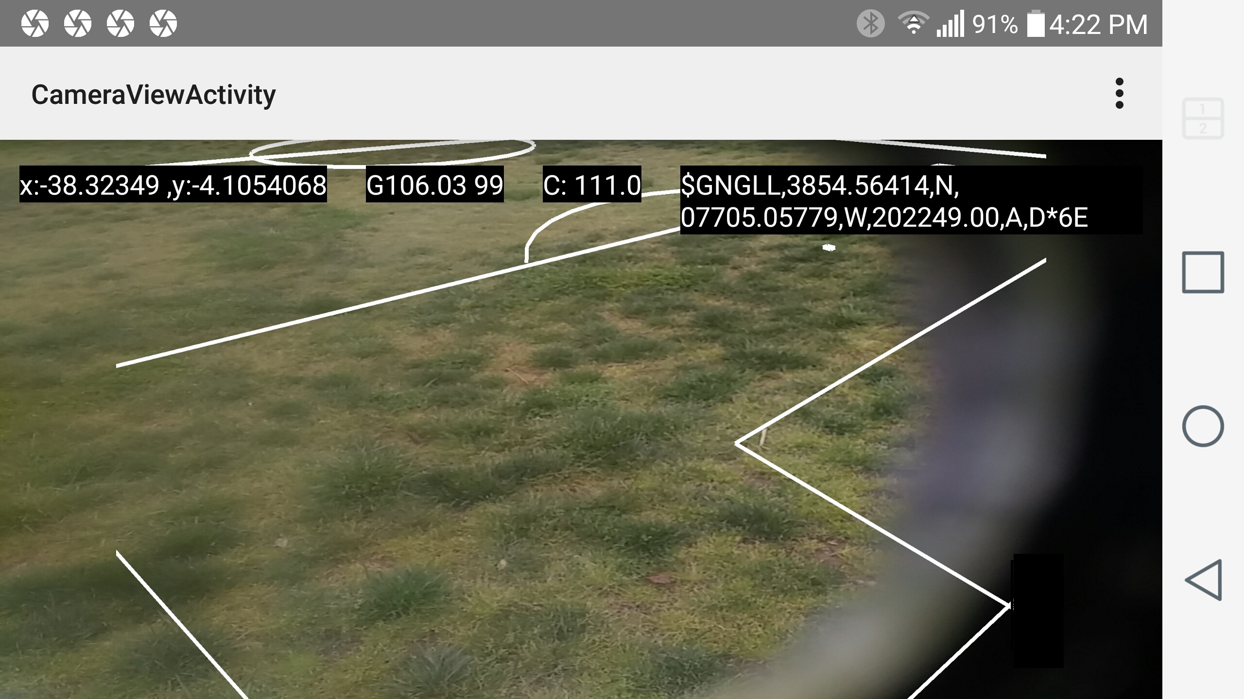

What I came up with is an app that runs on my smartphone. To start, the app downloads the field coordinates from the web. The rover unit plugs into the USB port and gives the precise current location of the antenna. The camera on the phone is on and displays on the screen. Overlaid over the camera image are the lines of the field, based upon the current location from the rover, and the tilt and orientation of the phone. It's augmented reality the camera shows you reality, the location of the lines is augmented. Here are a few screen shots I took today.
Here's a shot of the field with the camera tilted up.
Here are a couple pointing straight down at the ground. The cross represents the location of the rover (which I'm holding next to the phone). I programmed the app so that when the reported accuracy is 1 cm the cross is blue and 1cm across, and when the accuracy is 5cm it's yellow and 5cm across. The white lines in the picture are the field layout lines. That black thing is my shoe.
To use the app you walk around the field looking at your phone, when the cross touches a line the rover antenna is exactly where you want to be. I made up a jig that attaches the rover, the smartphone and the antenna to a paint marking wand. Here's a picture of that rig; the base station is on the left.
So far this is all just a proof of concept. I did use it to mark a couple of fields last year, the referee at one game complimented me on how precise the field was. No soccer this year because of the virus. I see a lot of ways this technology could be used, a lot of directions this could go in. The actual DGPS chips are about $80 each, probably less in bulk, so I wouldn't be surprised if we start seeing them in consumer products soon.

Thanks. You're right that the compass is the weak link. The GPS gives a bearing. If you're moving at more than a slow walk it is very accurate (same accuracy as the underlying GPS), if you're not moving it's just a random number. So i look at the bearing and speed reported by the GPS. If the speed is over 1 knot I use the GPS bearing, otherwise I use the compass bearing.

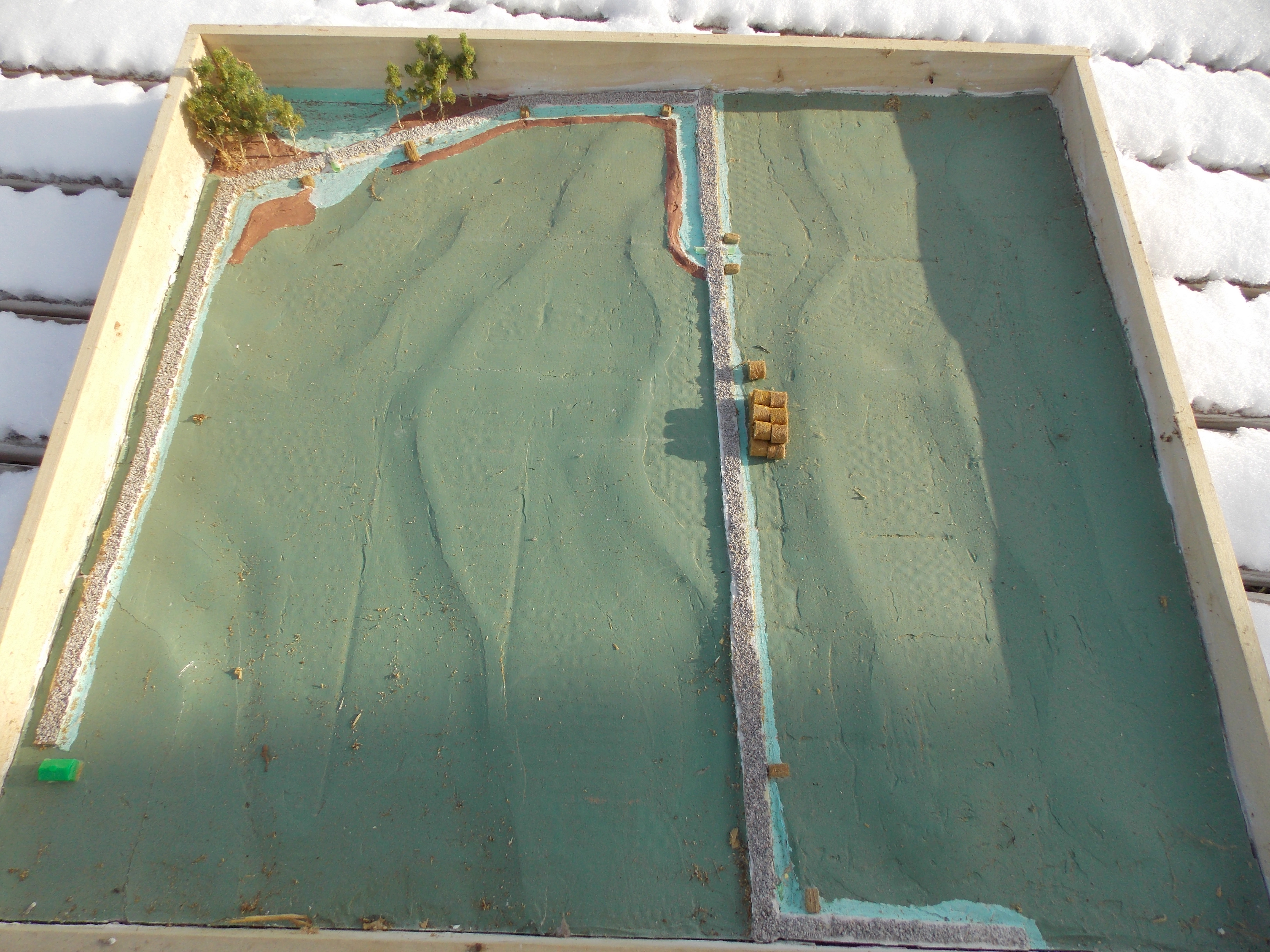

When I layout a field, I like to use LIDAR and CAD...
LIDAR is pretty cutting edge, but for me CAD means, Cardboard Aided Design!
What I do is, take a LIDAR map of the field or area of my farm I want to work with, using 2 foot contours instead of 20 foot contours like most maps.
Then I make a shadow box of the area I am doing my farm planning on, so that I can work my map.
Because of the thickness of cardboard, this scales quite nicely into two foot contours, so as I cut and layer the cardboard, I get very accurate contours of the field because each layer represents 2 feet of elevation. This unfortunately gives me "steps". To fill those in, I then use drywall compound to make the final layer very smooth, so that I get all the details of the contours, hummocks, dips, ledge outcrops, ditches, swales, etc.
Then I paint the surface for whatever I am doing. Blue for ponds, swales, streams, etc. Dark green for forest, light green for fields. I will even add in railroad modeling stuff such as ballast to show where the roads are, haybales to show where erosion control goes, and even trees. When I am done, I have a very accurate 3D model of a field or portion of my farm.
This really helps when working with Federal or State Soil Engineers who are funding various farm projects. They can instantly see what your plan is for the field, or area of the farm. Then they can approve it or not. Taking a few hours to make a scale #D model, and then having it readily approved because they can see it, and you show your devotion from the start, goes a long way to getting funded for Federal and State Grants.

Here is an example of a LIDAR derived 3D model within a shadowbox frame:
The area comprises of 47 acres, and shows where I want to place (2) roads. One is down the center, and the other starts in the background, drops down to the left, and then towards a cabin we want to build (the green Monopoly hotel in the model). The contours are very accurate, and within 2 feet of elevation thanks to LIDAR mapping. The model also shows where the swales and erosion control measures go for the roads, along with ditches, berms, and the pond that needs to be dug.
In an instant, you clearly see what I want a current field, and clear-cut to look like.

I'm using an Android smartphone. The rover has a USB port that plugs into the phone. The rover produces a stream of text ("NMEA sentences"). Here's what it might look like:
$GNGGA,123519,4807.038,N,01131.000,E,1,08,0.9,545.4,M,46.9,M,,*47
where:
123519 = Fix taken at 12:35:19 UTC
4807.038,N = Latitude 48 deg 07.038' N
01131.000,E =Longitude 11 deg 31.000' E
545.4,M = Altitude, Meters, above mean sea level
The other numbers are facts about the precision of the reading.
I have an app which I wrote running on the smartphone which reads the USB port, when it receives a sentence it reads it and updates the current position. There is another sentence that gives speed and bearing.

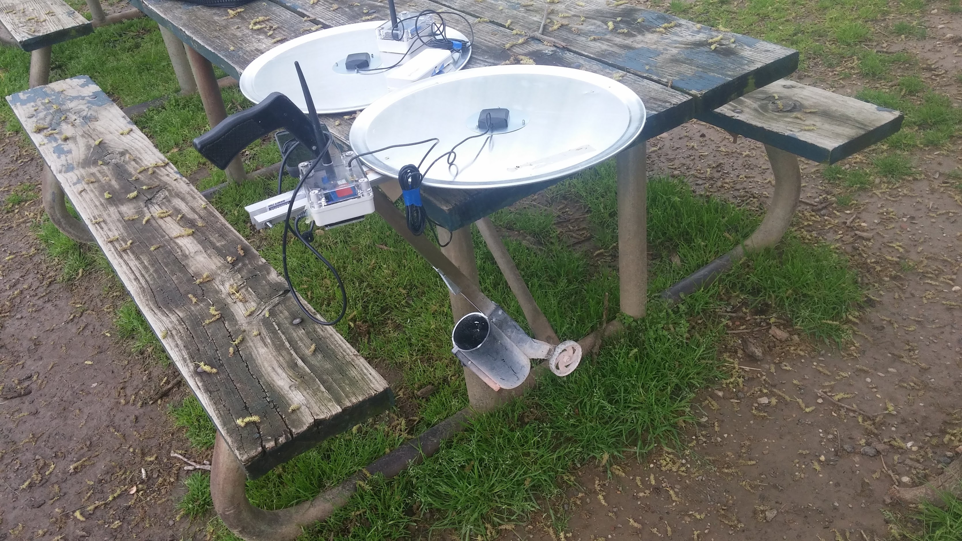

I clicked on the link to look at a pic of the equipment. It looks like it is just the guts of a GPS receiver. I saw where you mentioned putting a metal tray under them for reflections, which is called multi path. Surveying equipment has that stuff built into the housings and the software also helps in rejecting multi path.
Does your equipment just track American satellites? I am not sure how many are floating around up there now. Gps(USA), European (galelio), Japanese, Chinese (Bediou sp?) and Russian (Glonass). I first started using GPS about 1993 and at that time there were long periods of the day you could not work because there were not enough satellites. With RTK you need 5 to get a fixed solution and 4 to maintain it, that assumes no obstructions. These days it not uncommon to track 15 to 20 satellites.
Do you have this in some kind of housing? Are you using some kind of pole? Kudos to you to get it working, that is way beyond me.

The base is on the left and the rover is on the right. The big metal disk is an aluminum pizza pan, the black metal square in the center of the pan is the GPS antenna. The plastic box with the antenna sticking out of the top is the DGPS kit. On the base unit the white box is a battery.
The rover is rigged up around a paint marking wand. I attached a couple of pieces of aluminum bar to the wand, and the dish and antenna are on one end of the bar. On the other end of the bar I have the DGPS receiver on the right and the smartphone on the left. The smartphone has velcro on the back to keep its position fixed relative to the antenna.

I tell you that’s a heck of a setup. I assume the black box in the center is the GPS antenna? One thing that will help is to get that setup in the air. We usually use a 2 meter pole to get it up over our heads and the base sets on a tripod about 5.5 feet high.
