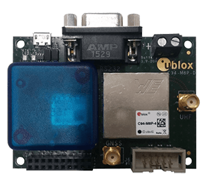

So it turns out the precision is closer to 2 cm than 1 cm. The DGPS unit is capable of 1 cm precision, but its output is in NMEA format. The NMEA format has latitude and longitude in degrees and minutes, the minutes are reported with five decimal places. So the minimum precision is 0.00001 minutes. At my location one minute of latitude is about 1800 meters and one minute of longitude is about 1450 meters. So 0.00001 minutes is about 1.8 cm of latitude and 1.45 cm of longitude. For my application so far that's fine. U-blox does have a proprietary format that gives greater precision if needed.

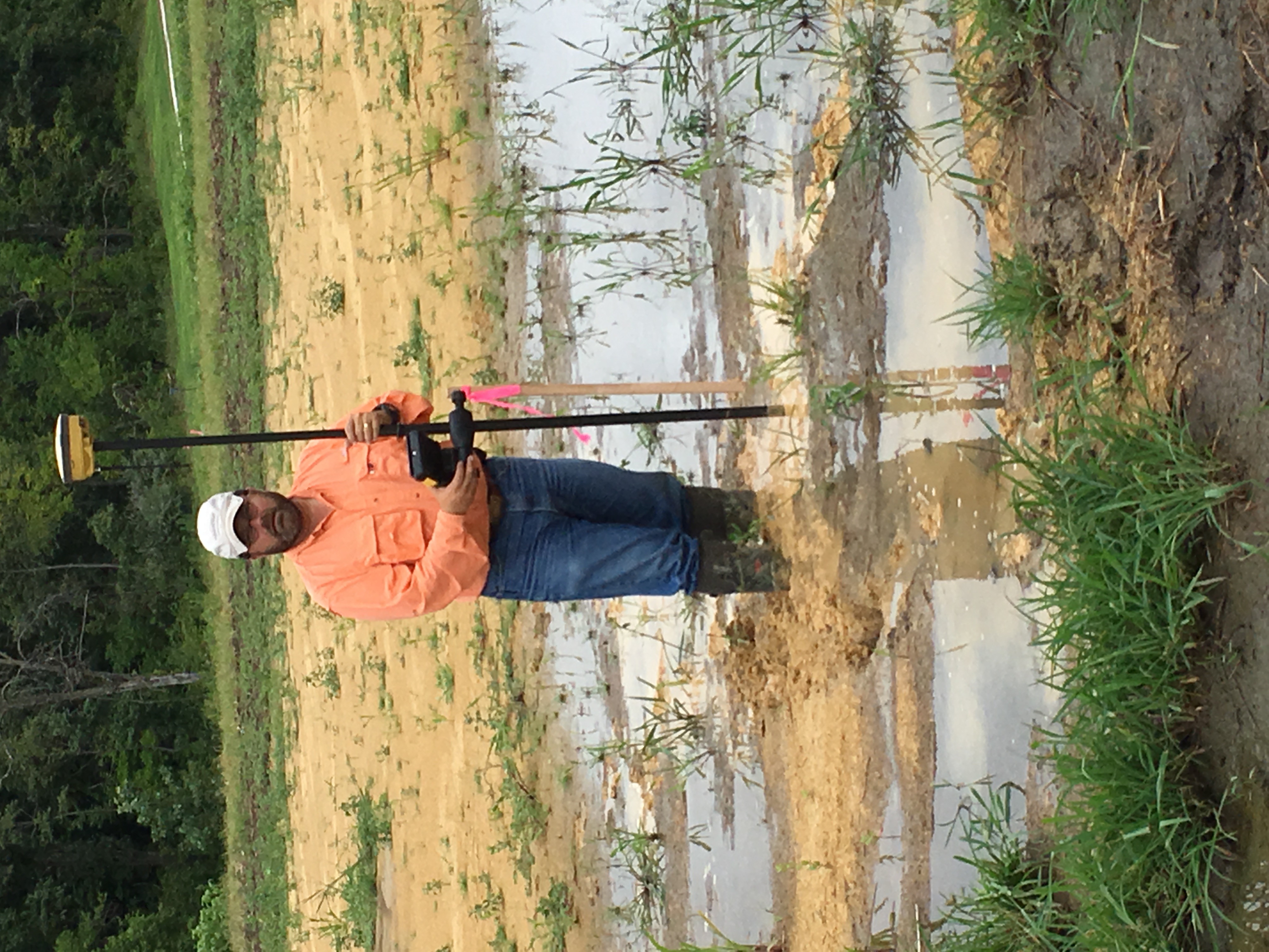

As a rule surveyors do not work in latitude and longitudes although it is a mathematical conversion to state plane coordinates from lat and long.
One thing, speaking as a surveyor, that would limit the use of your system is the interface. We use data collectors that give a lot of information. QA/QC numbers being important. When using ours one thing I keep an eye on the display is if the solution is fixed, float or autonomous. Fixed means cm level accuracy, float means something is wrong, such as to many trees, and autonomous means your radio link is down.
A couple of things, GPS does not work in tree cover. There have been huge improvements in how it works in the trees but once the leaves are out, you just can not get a fixed solution.
Also the precision of GPS is not that great. If you take a single measurement on a point, shoot it the next day, it won稚 check that great. I am talking an error of a half inch or more sometimes. What this means is for critical measurements such as bridges, building layout and paving operations, it is not good enough. Say you use GPS to shoot property corners 20 feet apart, you would get a better measurement with a 30 foot carpenters tape measure. Where it shines is longer distances, places you do not have line of sight, and where precise measurements are not critical.
Another point is GPS does nothing to improve boundary surveying. It makes it easier, it is another tool but the answer is not floating around in space in satellites. There is a list of calls in order of importance, such as call to adjoined, natural monument, man made monument, bearing, distance, area and coordinates. Coordinates is last on the list meaning you give it the least weight. That is because you do not always know how the surveyor got the coordinates. What did he start from, what equipment did he use? To many variables now to move it to the top of the list.

The U-Blox unit will tell me if the solution is fixed, float or autonomous. (I had forgotten the terminology in an earlier post). I change my display base on what it tells me. If I'm getting fixed the current location is marked with the small blue X:
If I'm getting a float solution I mark it with a larger, yellow X:
The idea is the size of the X roughly represents the accuracy. If I'm getting autonomous it's a much bigger red X.
