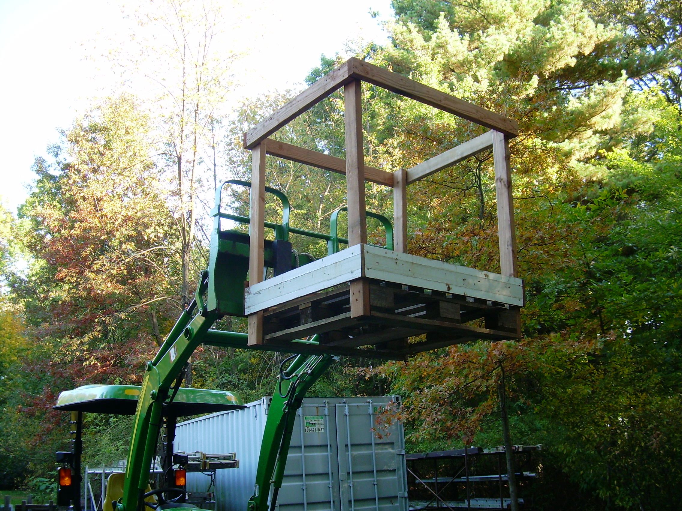

I'm guilty, never wanted to share this picture with TBN but since there's a 250 reply thread on the subject, why not. used it once for trimming branches.

:D ....and now that you did, may I recommend some decorative lattice-work? :D

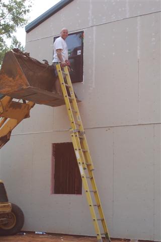

I can't say for all loaders or even other loaders, but on mine, there is a main supply line from the hydraulic pump that splits like a Y after the control valve to each side of the lift cylinders. If that one line fails, it would probably cause the imediate drop that we all fear.
That line is metal, so it's less likely to fail, but on my dozer, I had a metal line fail on me, so it does happen.
As for the toppic of working from a loader, I do it when I need it. I know of one guy who had his bucket fail instantly when loading a dump truck. It pretty much locked itself onto the dumptruck. They had to remove the cylinders and jacked the bucket up to get it off of the dump truck.
One of my future projects is to make a work platform from metal that will have a permanent ladder off of each side that I can pick up and move around with my pallet forks. Reading all the posts, I've modified my plan to make the ladder part on both sides of a pallet sides platform. Then I will make the ladder long enough so that I can pick it up and get it above the point wher I can lock the loader in the up possition.
I'm not much on the safety aspect of most things, but this makes sense. I need to prune trees on a regular basis and will need the platform for this on my roads. Having it held in the up position with the lock in place is just something that I never considered. I'll just build it to fit.
Thanks,
Eddie
