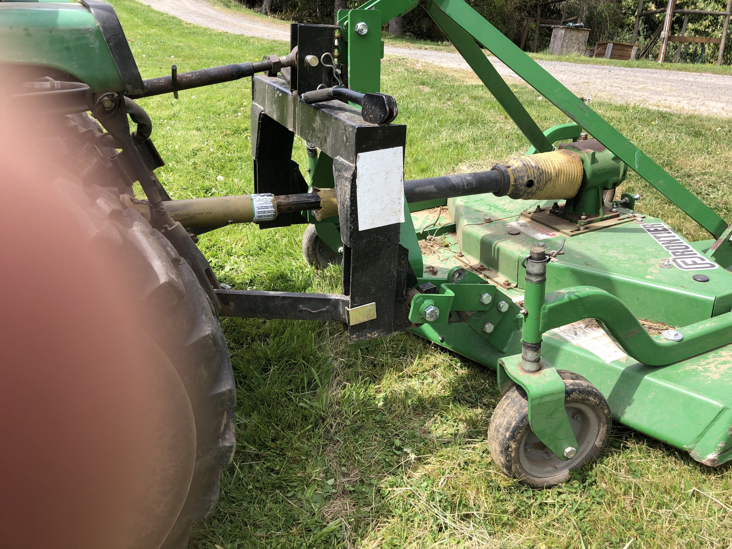

Yes on flat ground that is what it looks like. If you can picture in your mind that if I was mowing on a slope of say 10 percent and the slope then leveled off to 0 percent there would be less space between the driveshaft and cross bar of the quick hitch. While I am on the slope of 10 percent there is no problem. The problem comes when I have to make the transition.
/ Using a Grooming Mower with Quick Hitch

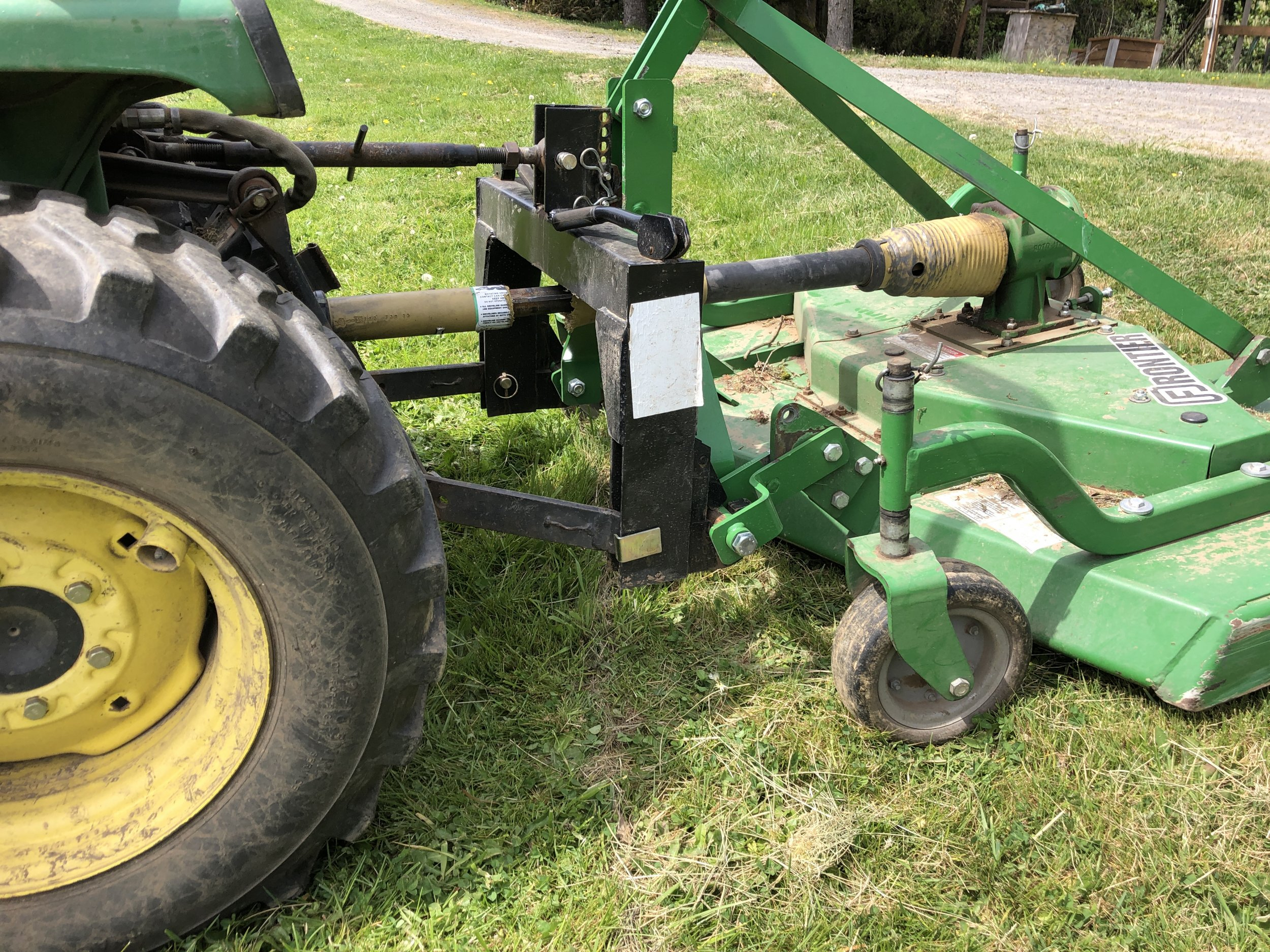

First pic shows tractor on fairly level ground and mower on a slope. Note position of lower mower arms to QH pins and distance between drive shaft and QH cross bar. Second pic shows tractor on fairly level ground and mower on slope after adjusting rocker lever to make sure driveshaft and QH cross bar do not make contact with each other. Not the position of the lower mower arms to the QH pins.

You need to reposition the two drag links on the mower to the upper holes to keep the lower links higher and more forward and as a result prevent the PTO drive shaft from contacting the quick hitch.

Agree, the present geometry is the problem and that is the best solution.
After that, an even more flexible top link on the mower might be needed. So the back of the mower can lift enough to not raise the tractor's rear tires off the ground at a slope change like in the photo.

Thank you for the response. I will try moving the linkage to the upper two holes. I purchased the mower prior to obtaining a QH. After getting the QH I had to purchase an adaptor kit so that the QH would fit the mower. I installed per the instructions. What you see in the pic with the upper holes empty is because I tried reversing some of the components to see if that might help. It did not, only made it worse. ( I thought perhaps I had misinterpreted the installation instructions when I bought the adaptor last year.) The upper holes had a bolt in them per mfg. I just did not reinstall them the other day prior to me posting my dilemma here. After I move the links up to the top hole I will have to 1. see if it works and 2. see if the driveshaft is still long enough. I feel like I am getting to the maximum extension of my drive shaft from mower to tractor.
